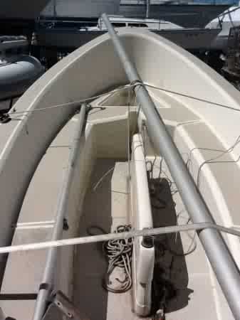

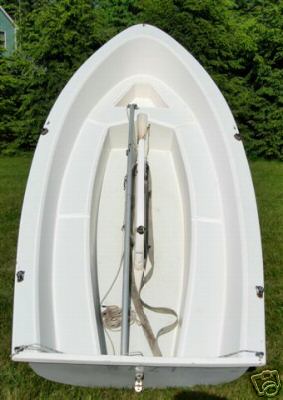

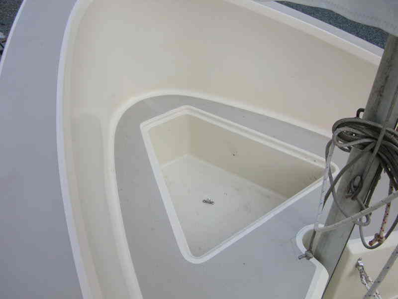

Well, luckily, O'DAY built a pretty quality boat, so most owners haven't had trouble...I guess? Could you try a smaller (4" dia.) inspection port? As I mentioned in a different posting, the previous owner of my DS II used a 4" port to access the boweye for replacement (I guess his arm was longer/skinnier than Cap'n buckly? I replaced that 4" port with a 9" x 11" hatch... so, I guess my arms are bigger too!)
I've included a few pics below to show non-Widgeon owners what you are up against.
