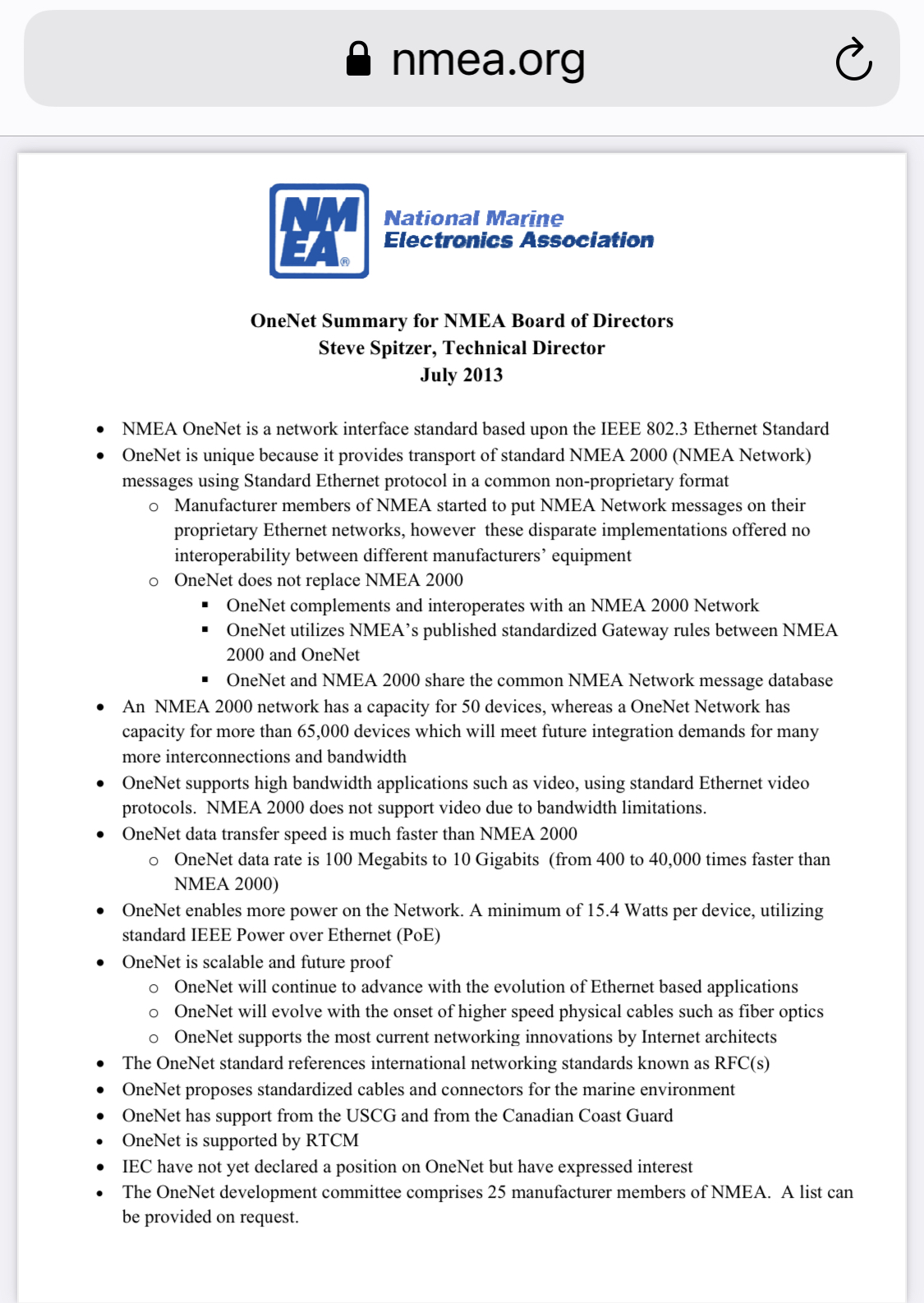

The NEMA 2000 standard is, I assume, 20 years old. Spurred by some post I don't remember, I was thinking about that, and that there must be an update coming. If you consider what has happened in the technology world, which I don't understand that well, a new standard is overdue. After reading that statement from NEMA I understand less of it than I did before reading it. I get that OneNet will be compatible with non-marine networking (How did the Marine Manufacturers let that happen?) But how backwards compatible will the new standard be with NMEA 2000 and NEMA 0183? Or maybe better stated, do we all have to buy new stuff? 'cause I still have my lead line. Just saying. My "electronics" are primarily hand held and not networked.
Actually, N2K is much older than 20 years, it was only 20 years ago that it became official. N2K is based on the CAN bus which is commonly used in automobiles and trucks.
Some companies were already using ethernet like Navico were already using ethernet for radar and the new CHIRP sonars because the amount of data that needed transmission exceeded the capabilities of N2K.
In the new standard the sentences or PGN, the actual data is the same as N2K, only the transmission will be by ethernet protocol. This is good and will help with integrating new and old equipment. The new standard is also compatible with wifi transmission. This is already in use, for instance when we use iPads to mirror the MFD.
Since much of the infrastructure is already in place, i.e., MFDs can broadcast wifi and have ethernet connections, I suspect implementation will move along quickly. The cost for NMEA members is also rather modest at $2000 initially and then an annual renewal fee.
