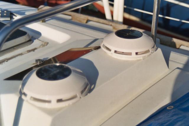

I bought a hole saw and mounted it through the forward hatch of my San Juan 7.7m. I used marine sealer to glue it to the hatch. Worked great, but about four weeks later I noticed it was making a little noise. I was not surprised, as I had read about a lot of motor failures. One week later the motor was dead.
