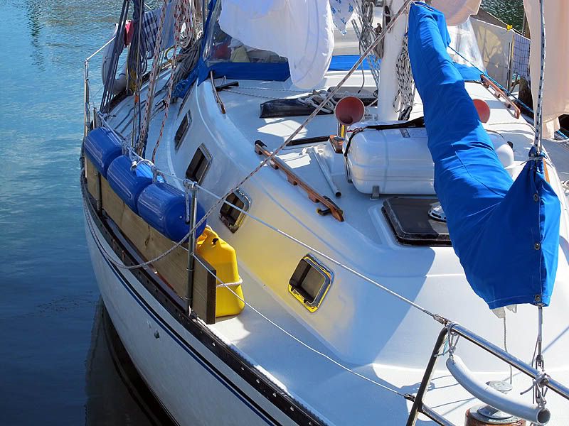

We bought and installed 10 stainless steel NFM ports in December (six 7x15 and four 5x12), so I thought I would do a little review to help other h37c owners make their mind. Here it is.

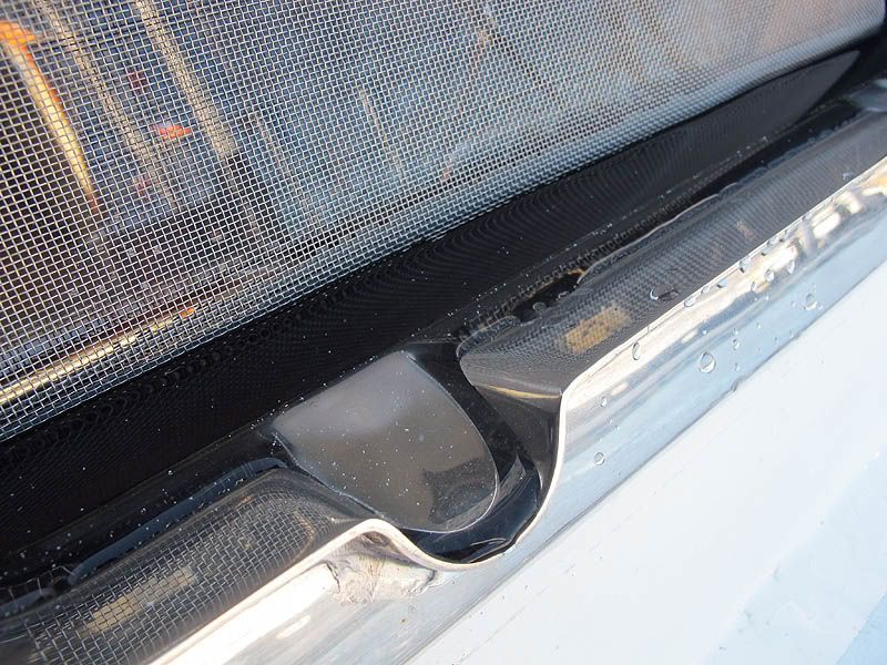

-Drains are not adequate for the angle of our cabin sides. Water pools in the window, you need a towel to open them. Mildew will eventually grow (done after 2 months even if we never leave water in there) were the gasket is glued to the window (this is another area where quality could be improved) and between the port and the screen (because believe me you will not want to remove the screens to dry this area). It also means I will need to cover them during winter, ice will lodge in there and may damage them.

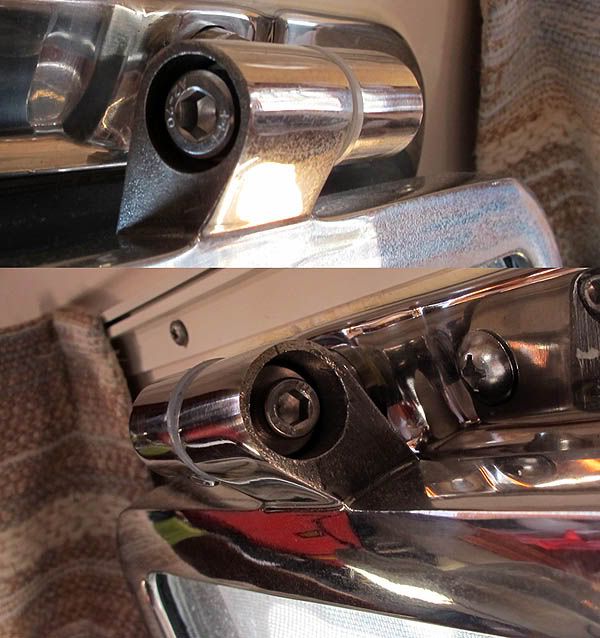

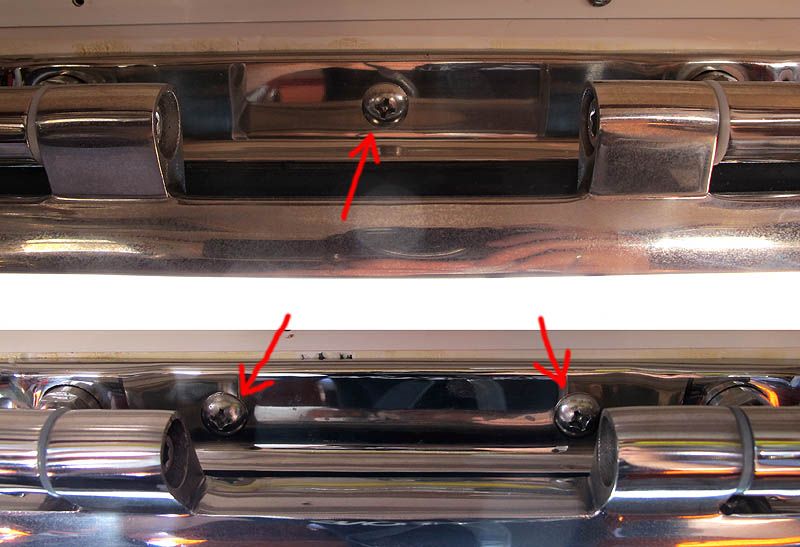

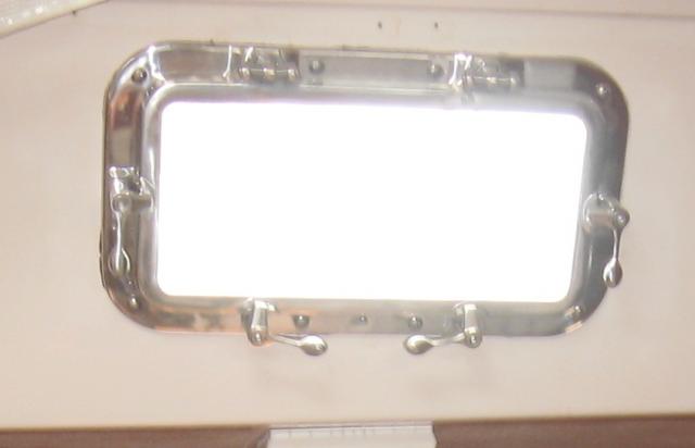

-There seems to be more than one model for the same size, with different bolt pattern, verify before you start drilling :cussing: (see picture). We had three 7x15 with 1 hole between the hinges and three with 2 holes. Model change maybe ? (My guess is that it must be cheaper to make them with one less screw.)
-It seems that when they run out of fasteners to assemble the hinges, they just use whatever they have on hand. One of the six 7x15 ports has some fasteners that do not belong there, the SHCS are smaller, so you need a smaller allen key to tighten them, anyway the hex nuts are too small to stay in place (see picture)... Overall, you see that they save a lot using cheap labor in china, and it shows in the assembly.

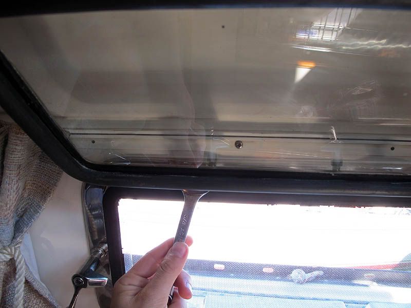

-If you order the screens, do not use the supplied tool to adjust the hinges :naughty:, your knuckles will not survive the operation and you will have to clean all that blood off those cushions :cussing:. Instead , open the window and use a wrench from underneath (see picture). This operation is a pain in the b**, plus plan on being there the first time it rains, you will need to adjust them again and again (just use your garden hose if you are not in the Bahamas and you don’t need to pay 17$/day for water).

Overall, once installed, you forget about the cons I mentioned (except for the water pooling because of cabin side angle), these are very nice ports. I would never go back to the old ones, in fact we should have changed them at least 5 years ago. That said, if we had not been in the Bahamas at the time of the installation, I would have sent back some of the ports, I do not like the fact that the bolt patterns do not match, and really don’t like the mismatching fasteners on one of the ports.

water pooling:

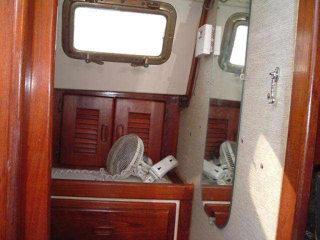

Ed, is that a termostat in your rear stateroom ?

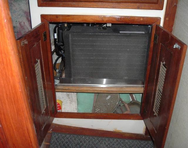

And yes, a thermostat for the Reverse A/C which lives in the cabinet just below.

Very nice! I did not have any of the mismatched hardware or the hinge issues but I agree with all your other points. The make a good port but run a sloppy business and are quite disorganized IMHO. Still a great value when compared to many other products. Theirs are not the only ones that don't drain though..

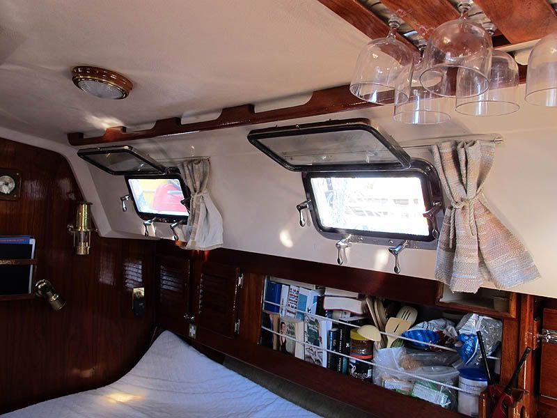

I agree, seems that somewhere between 2008 and now they have changed the hinge asI installed mine in 2008 and they are different. I would say you got a mix of old and new with all new hinges. But I still love them and they sure do let the breeze in on those hot summer days we all have been waiting for!

Mark, looking at your picture I can now guess why the model changed. With the hinges on your model, you can easily access the two upper screws. With the hinges on mine, they are very hard to reach, that's probably why they changed it to a one screw design.
