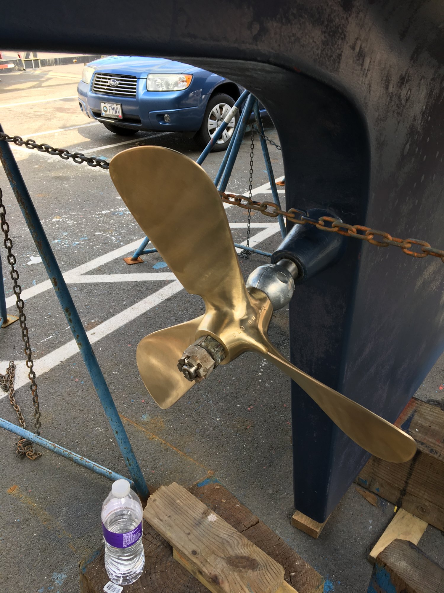

Thanks. Yes I've talked to Beta about the engine, and they offer gear ratio of 2:1, or 2.6:1. Then got quote on Campbell sailor 3-blade prop, which specified either 12" or 14" for those ratios. My issue is I'd like the larger prop, but I think it might be too big. I have one photo of the boat in the sling. It's hard to tell, but looks tight with current prop which I think is 12".. I'm not sure, but 14" sounds big on a 30 footer?
Having someone dive might be the only way to figure it out for sure, but is a hassle/expense I'd like to avoid.
Ultimately going with a 12" like is on now is the safest choice. And considering pretty mild current, tides etc here on the (upper) Chesapeake should be plenty fine. My marina is on a calm river, with an easy entrance, I rarely ever need much thrust (ditto for the areas I go to)

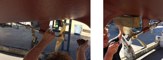

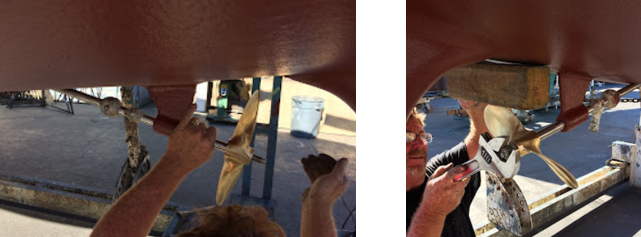

Campbell sailor 3-blade propeller.............that is what I installed on all my sailboats. This guy installed a 12 inch diameter x 11 inch pitch on a 7/8" diameter shaft propeller on his 1976 Newport 30 Captain Curran's sailing blog: How to replace a propeller on a sailboat. Below are photos showing the propeller to hull clearance on his Newport 30.
Thanks! Found some other photos of N30-2s too, where the 12" looks very close to the boat, and one 13" I think? There some difference between mk2 and 3, but I don't think that much? That's what leads me to not bother with the hassle of trying a 14.
If it doesn't work I've wasted $500+ on a prop I can't use!
If I get a 12"? Marginally less thrust, but still more than I have now (which is fine)? Bit less efficient? (for my minor motoring.. lol).
No, I don't think it's worth it.

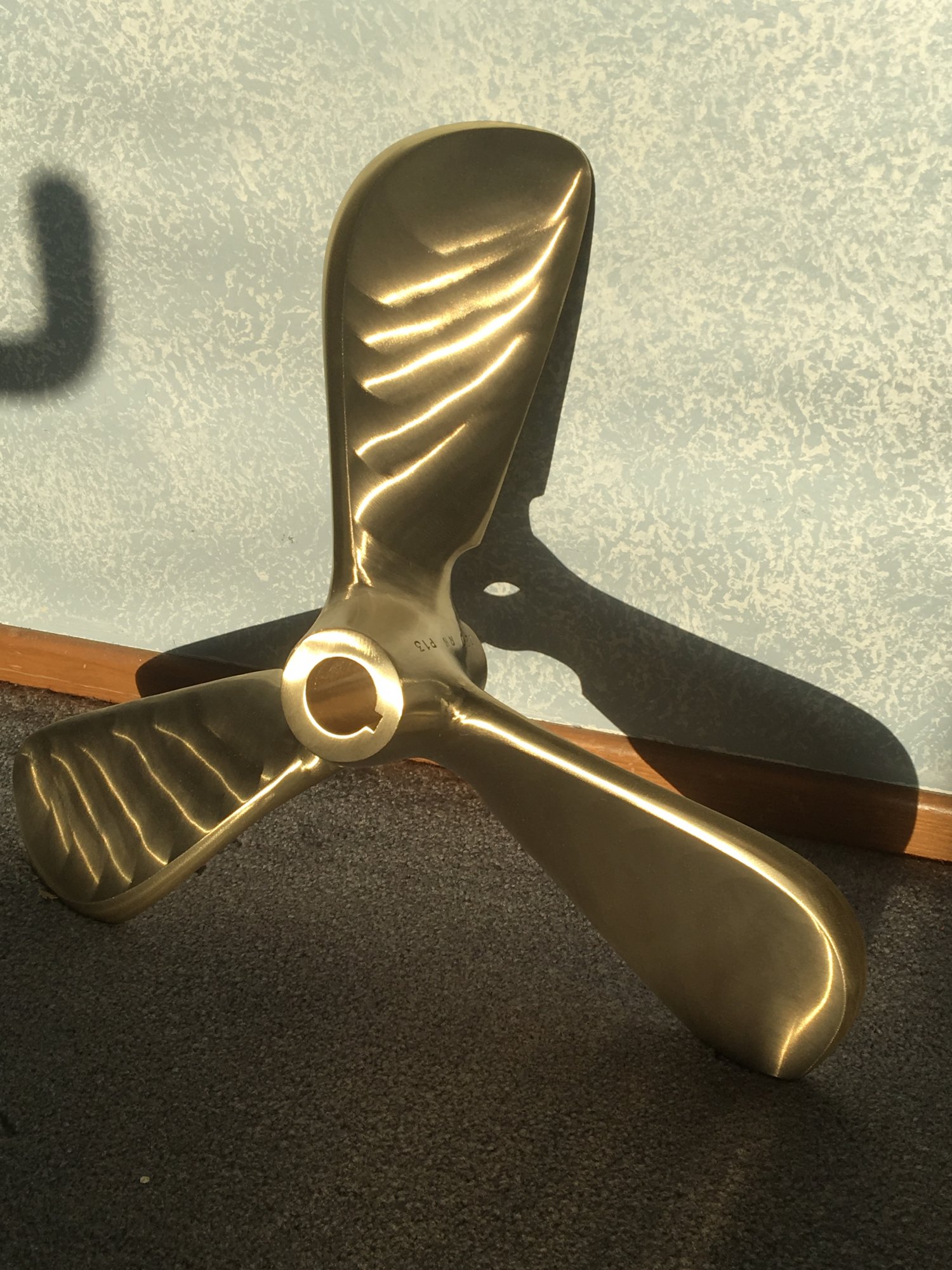

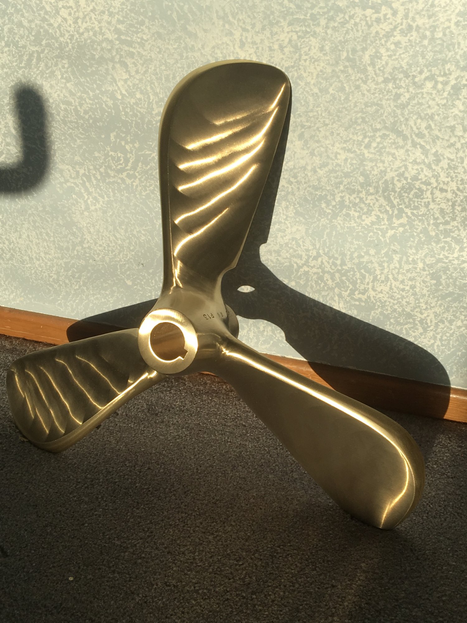

You definitely need the shaft size and taper, engine data, transmission ratio, and left or right hand turn, before you order the prop. This data determines the pitch and the proper shaft hole for the prop. You can select the 12" which looks better in the images above. 14" would look to close and either hit the bottom of the boat or cavitate. Both are a no no..
You will get plenty of thrust from a 3 bladed CampbellSailor prop built by WestbyNorth BC Canada.
The WestbyNorth prop took about 6 weeks to be cast, milled and shipped when I ordered mine. I suspect it will be longer under the current conditions.
Love my prop.
