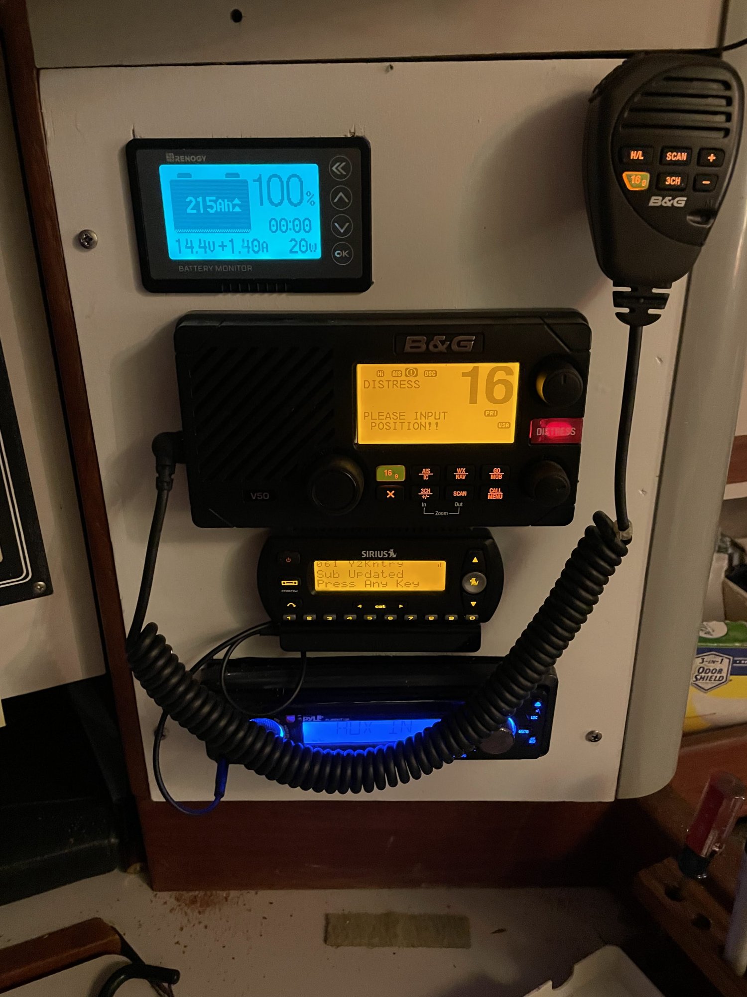

I installed an inexpensive battery monitor from Renogy (let the flaming begin). For my primarily day sailing use, I find it sufficient and helps me see battery input and output, amp hours remaining, etc.
There are many much more expensive monitors, but for my needs this unit seems to work fine.
Greg

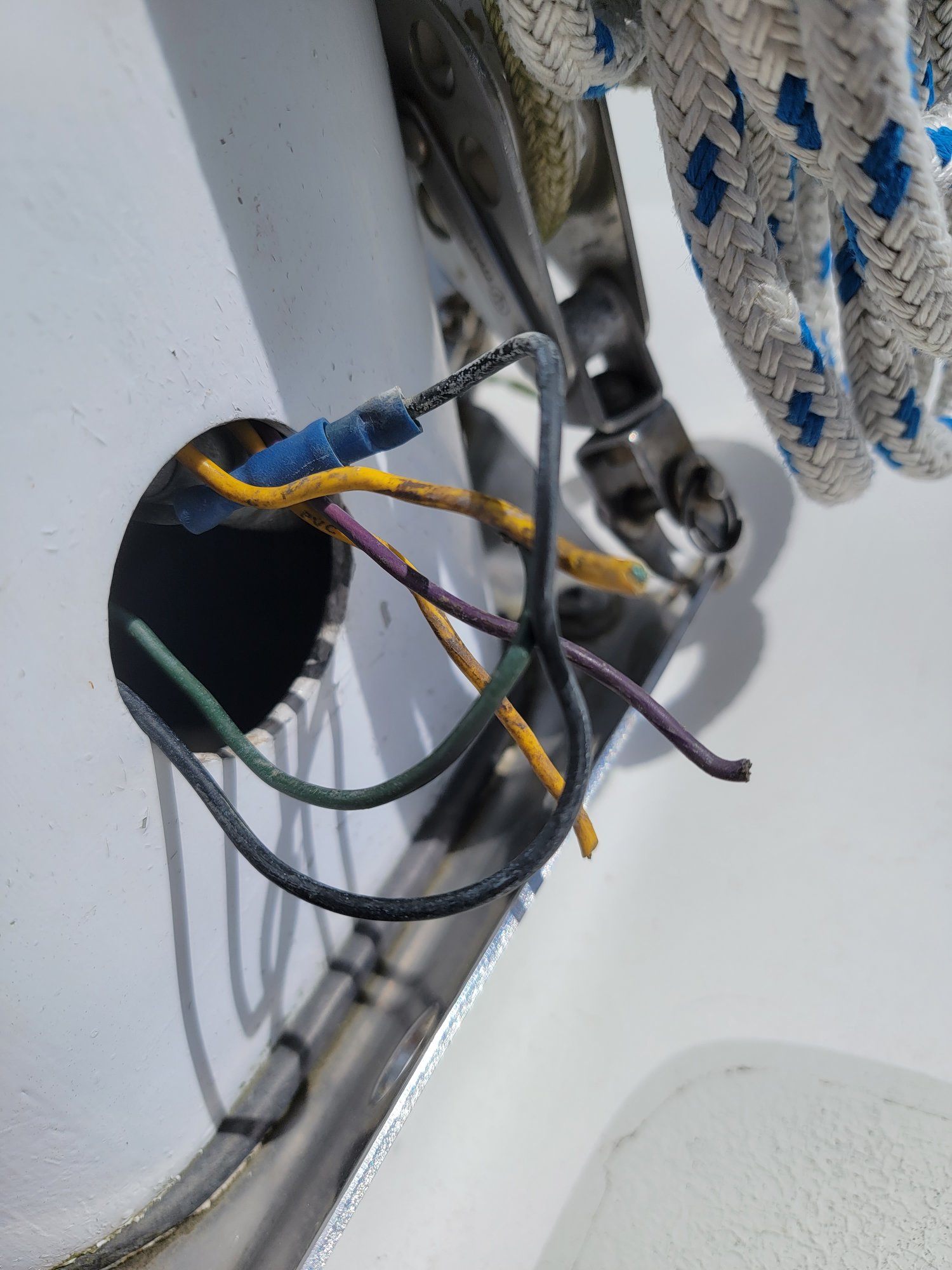

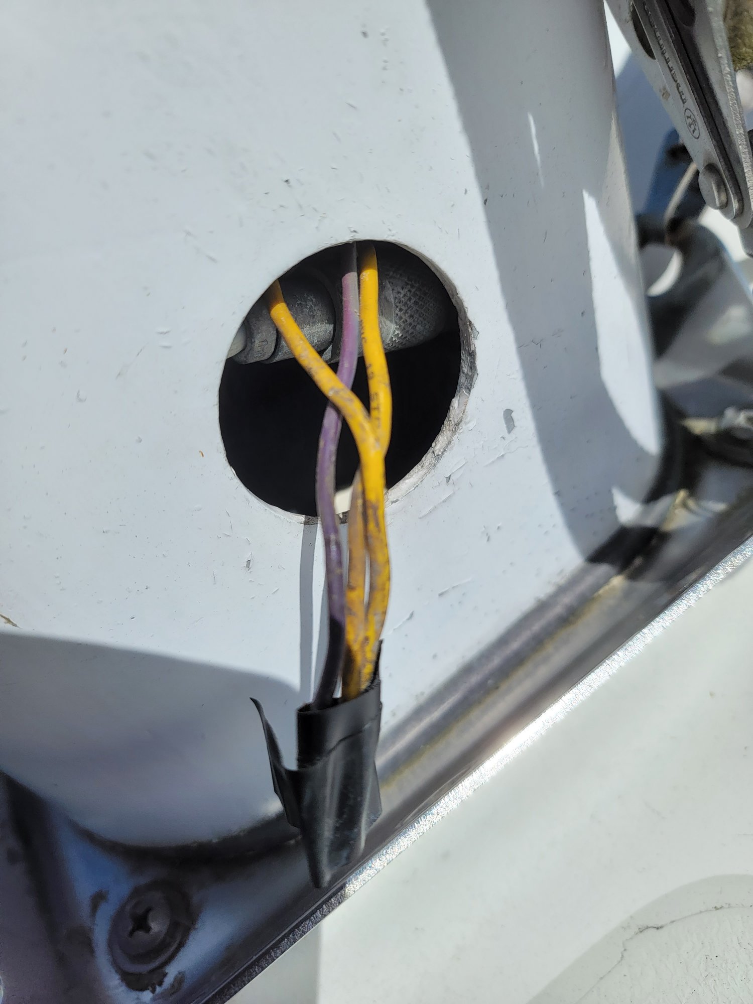

I just paddled down to the boat with my multi meter. I needn't had bothered with the multi meter - not sure who did the wiring, but they cant have done much training!
I unraveled the tape to find the stripped wires corroded off!
Looks like I need to get some proper marine crimps and then try to figure out what goes where. Perhaps there are two spreader lights that were once connected to the incoming purple charge? I didn't pull it too much but I suspect the detached green wire is the outgoing feed to the anchor light. The access is extremely tight - hoping I've not lost the incoming feed from the anchor light through the gap to the cabin!
I also assume there should be some sort of bung over the access port to prevent ingress?

it looks nice in the new radio console I made over the winter…

Ok! Still not sure I will take off my asbestos underwear just yet…but thank you.
That is quite snazzy, im jealous! If you need to fireproof your pants for that you're keeping the wrong company!

Some people don’t like Renogy. Maybe it is just the batteries they don’t like.
Either way, this little battery monitor with shunt seems to work for my modest use. I switched over to 2) 6-volt golf cart batteries last year and no start battery (so I do need to keep an eye on the house batteries.
On a 2-night, 3-day sailing weekend (no shore power for the time), it gave a lot of peace of mind to see what was happening with the batteries.
Your mileage may vary…
