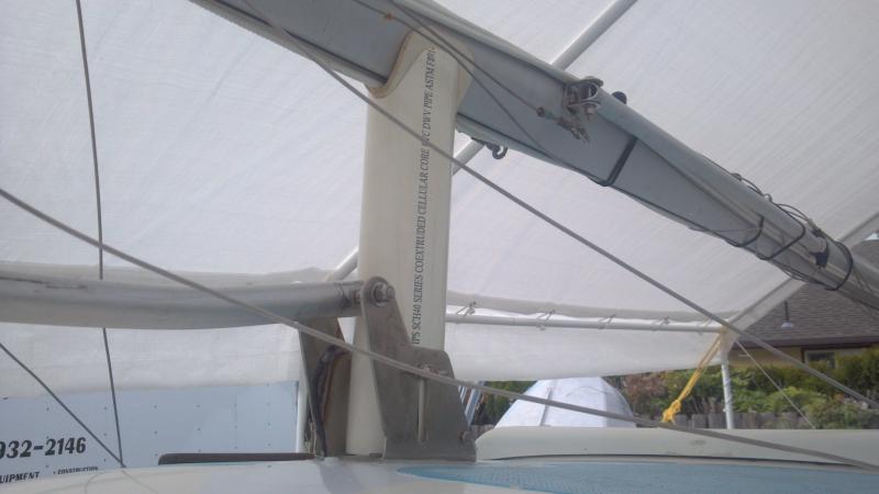

the 21's had an open bottom on the original mast. it sits on the stainless tabernacle and hinges on the bolt that goes thru the verticle slot on the tabernacle.
the photo shows my pvc center mast support in place of the mast when stowed... but it is how the mast sits in it when its up....
With the support in the tabernacle, what do you use on the ends?
I use the original Y shaped piece on the foredeck and the support on the stern that is held in place by the rudder fittings. I have always been concerned with the flexing of the mast when towing. I have stopped it with a rope to the cleats and a couple of turns around the mast. But am still concerned that the flexing (almost a vibration) would weaken the mast and eventually cause the mast to fail.

I'm going to build a tabernacle support and the wedge for the foredeck to sit between the bow rails. With the extra set of spreaders on my franken mast I need the extra support. I will add a backing plate to the tabernacle when I rebed the deck hardware. I'll try to flip my avatar today lol.

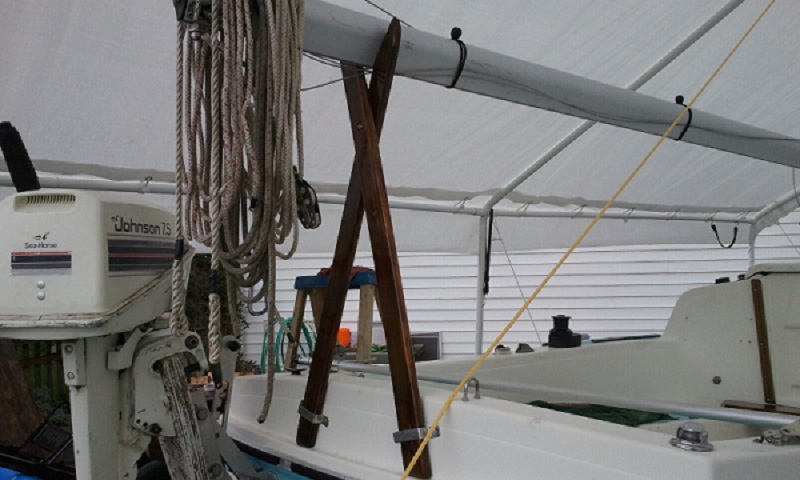

for the front, I used a saddle i built that fits into the anchor holder for a danforth style anchor.
for the rear, it had an x-brace that slipped into brackets on the stern...
see photos.

Centerline I thought that bracket was the base for an old spotlight lol I'll get to work on a mast support!
