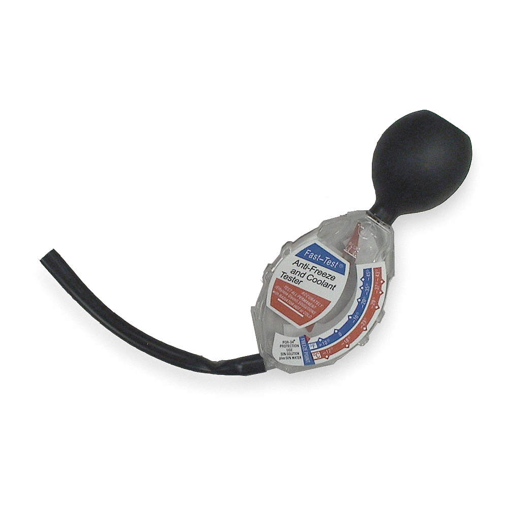

Don't rely on just the color of what comes out. As dmax says, it gets diluted and relying on the color for the untrained person becomes a matter of perception. Get a tester (generally less than $10) and take a reading after you're done feeding the antifreeze through the system. If you're happy that it's temperature resistant enough for your area, the job is done. If your not happy, run some more through it and test. I live in an area where it gets to -30 and I don't want to take a chance. An engine and all related parts are much more expensive than antifreeze and a tester ! Yes you can run it on the hard. Just have someone with a bucket collect what comes out of the exhaust. You can then easily test and you can dispose in a safe environmental place. Have a nice winter.

I would invest in a inexpensive refractometer to test your mix freezepoint. Got mine from Amazon

I always use 4 gal -50 in mine as AF is cheap vs cracked parts. Always drain system first so less dilution. As menntioned a simple refractometer is the best way to check. You can drain a small sample from the heat exchanger zinc or collect sample from exhaust just as you shut down.

Thanks! Very helpful as I am going to redo it all tomorrow. I use the SeaFlush setup which makes this all easy. Going to flush with five gallons of fresh water as the Westerbeke manual for my Universal M25XPB recommends, then drain the as much water as possible at the zinc opening and check/replace the zinc, drain and replace the fresh water side antifreeze at the petcock, even though it tested just fine with my cheap Prestone tester vis a vis freeze point, but it is old, and then run 5 gallons of antifreeze back through the raw water circuit. I don't have a refractometer, yet, but since I saw antifreeze out the exhaust when I ran two gallons of pink -50 through an undrained system I am confident I will be good. And I am using -100 antifreeze just to be safe which is what a lot of the yard techs do down here. I think this is all consistent with the advice here. And, yes, much cheaper than either paying someone or replacing a busted heat exchanger.
