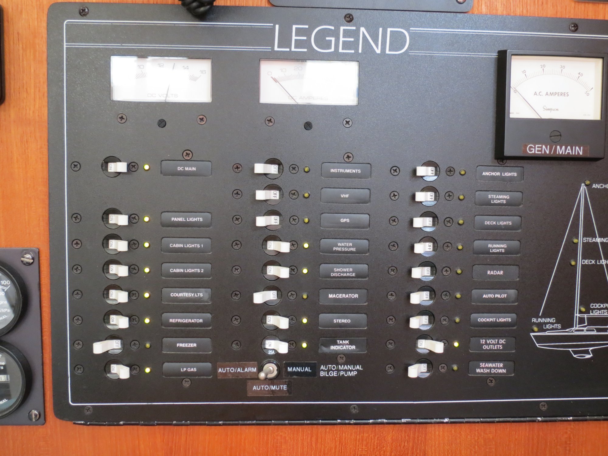

1. I would expect a breaker labeled "Refrigerator" or "Refrigeration". If you don't see one, then I have no suggestion. Normally that is the On-Off switch for the refrigerator.

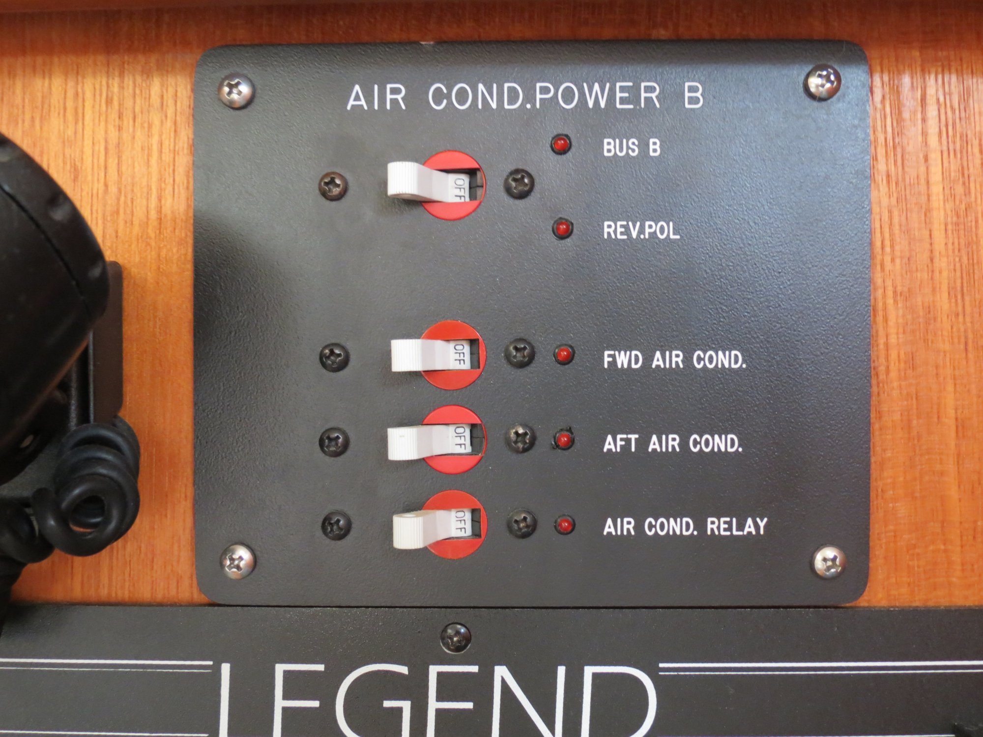

2. Yes, except there should also be a CB for the A/C Marine Air unit. And if you have two Marine air units it should be a separate panel with 3 switches. See pix below.

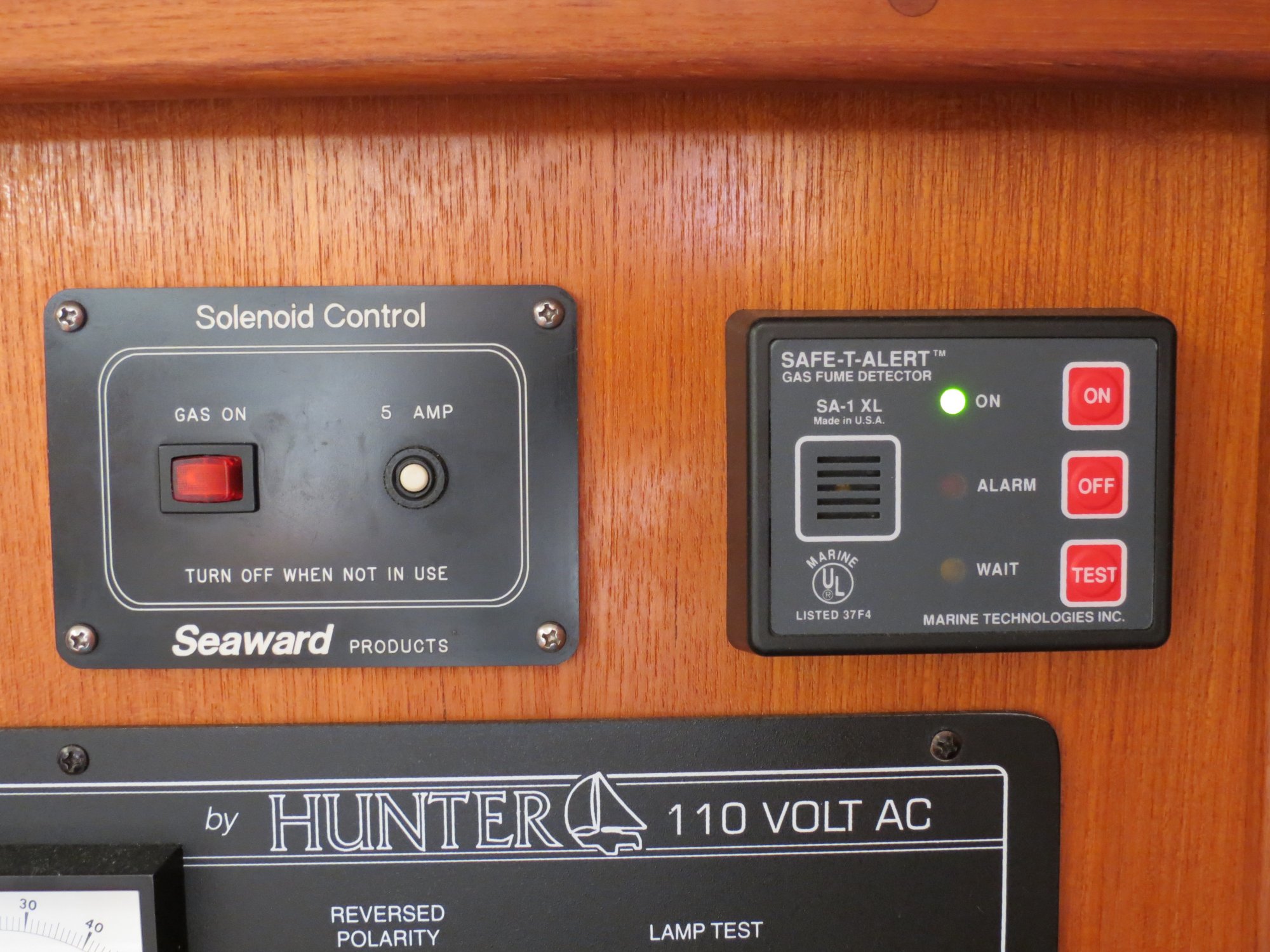

3. Assuming propane fuel, turn on the gas valve at the bottle, then turn on the gas solenoid to open the valve, turn the burner knob and depress the igniter. Be aware that it may likely take 15-30 seconds for the burner to ignite because the propane needs to flow to the stove. Because of this, I lit the burner the first time with a butane lighter, holding the flame on and waiting. Subsequent lighting's just use the igniter.
4. Yes and this will be a separate breaker on the AC distribution panel.
Lastly, if your h37.5 is like my h40.5 (actually sister ships) you will have two shore power connections. One is for everything EXCEPT the Marine Air A/C unit, and the other is dedicated for the A/C.

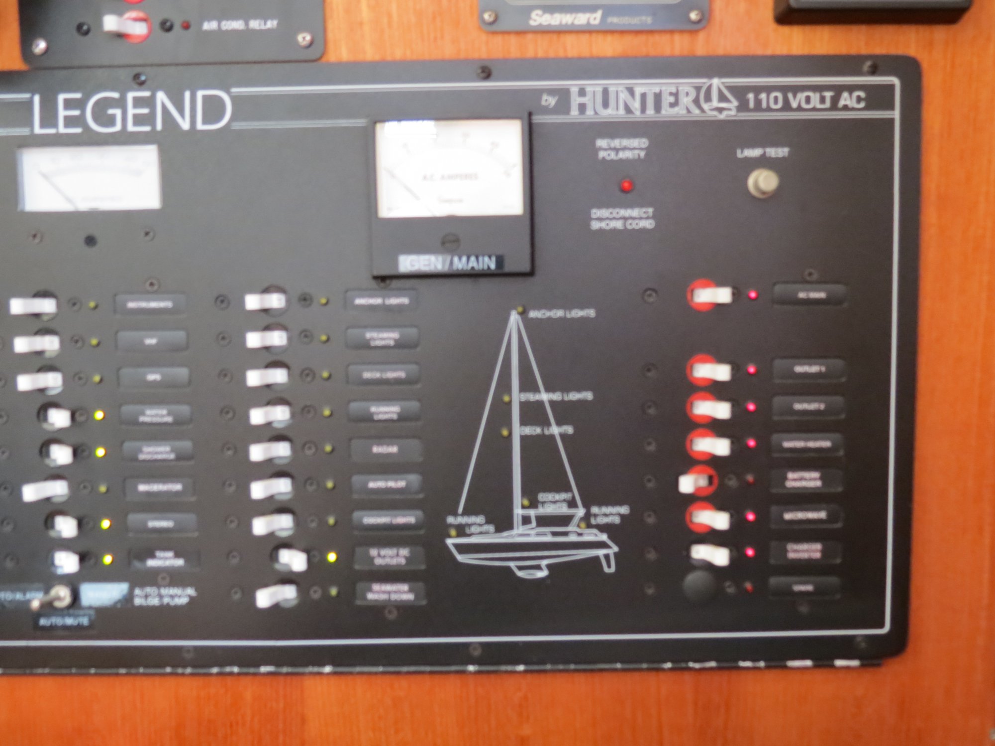

Thank you for your replies. Here is my panel:
(note, I just found the Air Cond and the Water Heater switches) Thank you :) My old eyes.

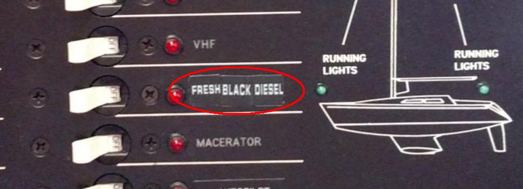

Pardon for asking, but enquiring minds want to know:
Just what is "FRESH BLACK DIESEL" ?
If that breaker were to make "FRESH BLACK COFFEE" I would be willing to pay big bucks for one:p .
Jan 4, 2006
7,443
The perfect answer for @3224tm as he burns waste oil from the deep frier in his diesel, all the while sailing through the Arctic in the middle of winter.

Fresh Black diesel may be code for "Fuel Polisher"

I have no idea either, but I would recommend having someone else flip that switch while you observe at a safe distance. Report back please. And be sure your yacht insurance is paid up.
And take video please!
23,804
The writing is on the breaker... What fun it is to explore your boat. You are likely to learn al sorts of interesting things in the next several months.

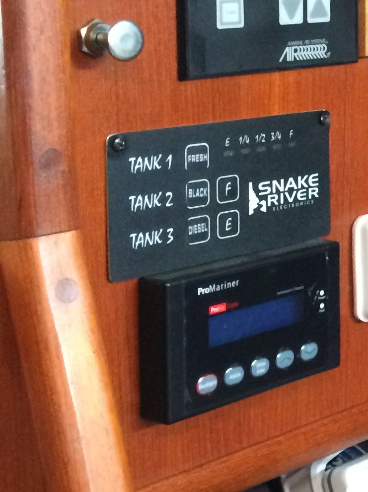

Yeah, I'm stiil not sure about the knob above the "Snake River" tank monitor.
