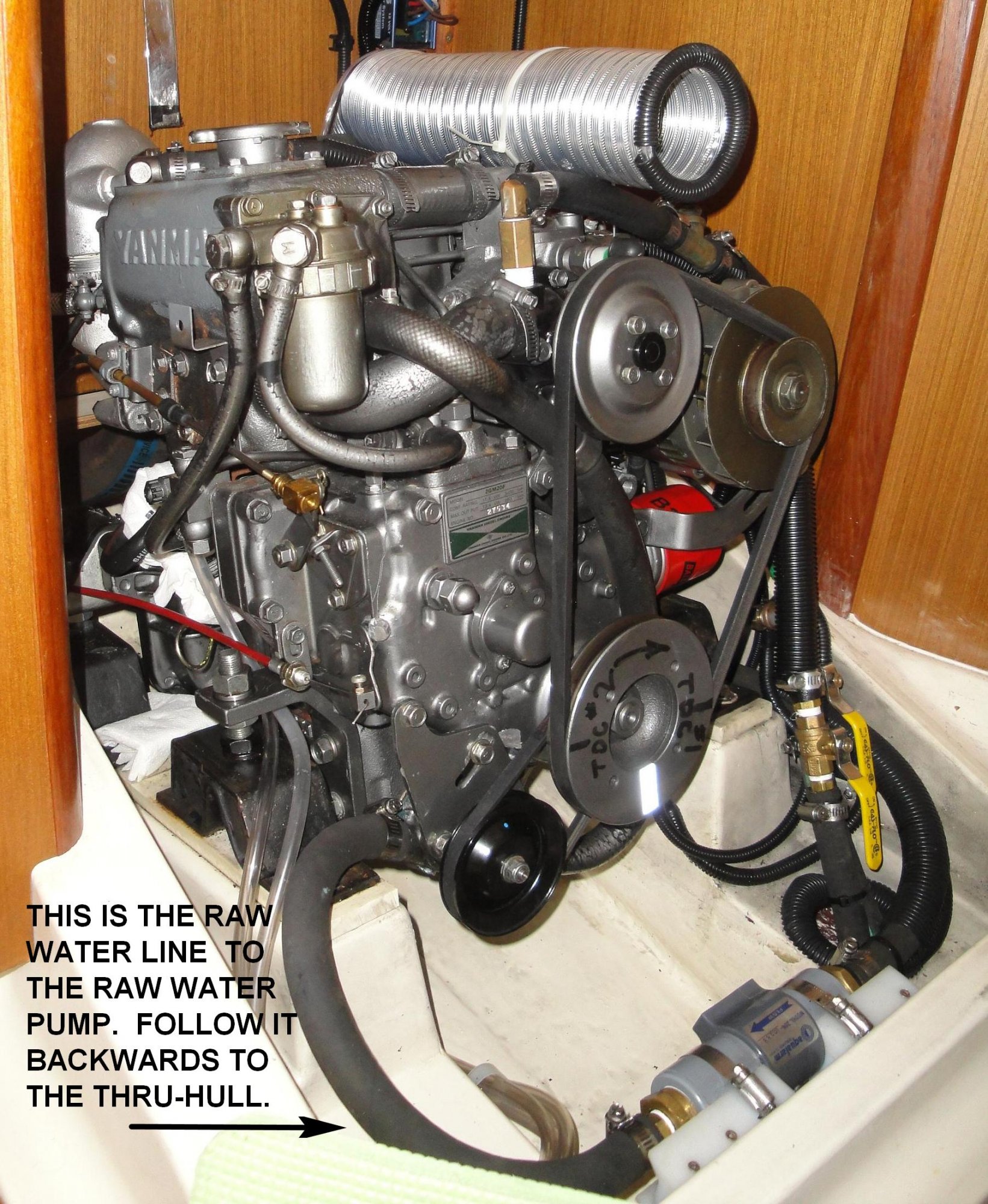

Really stupid question: Can anyone tell me where the raw water intake seacock is located in this boat?
Not a stupid question at all when you look at some of the comments which have been made around here recently.

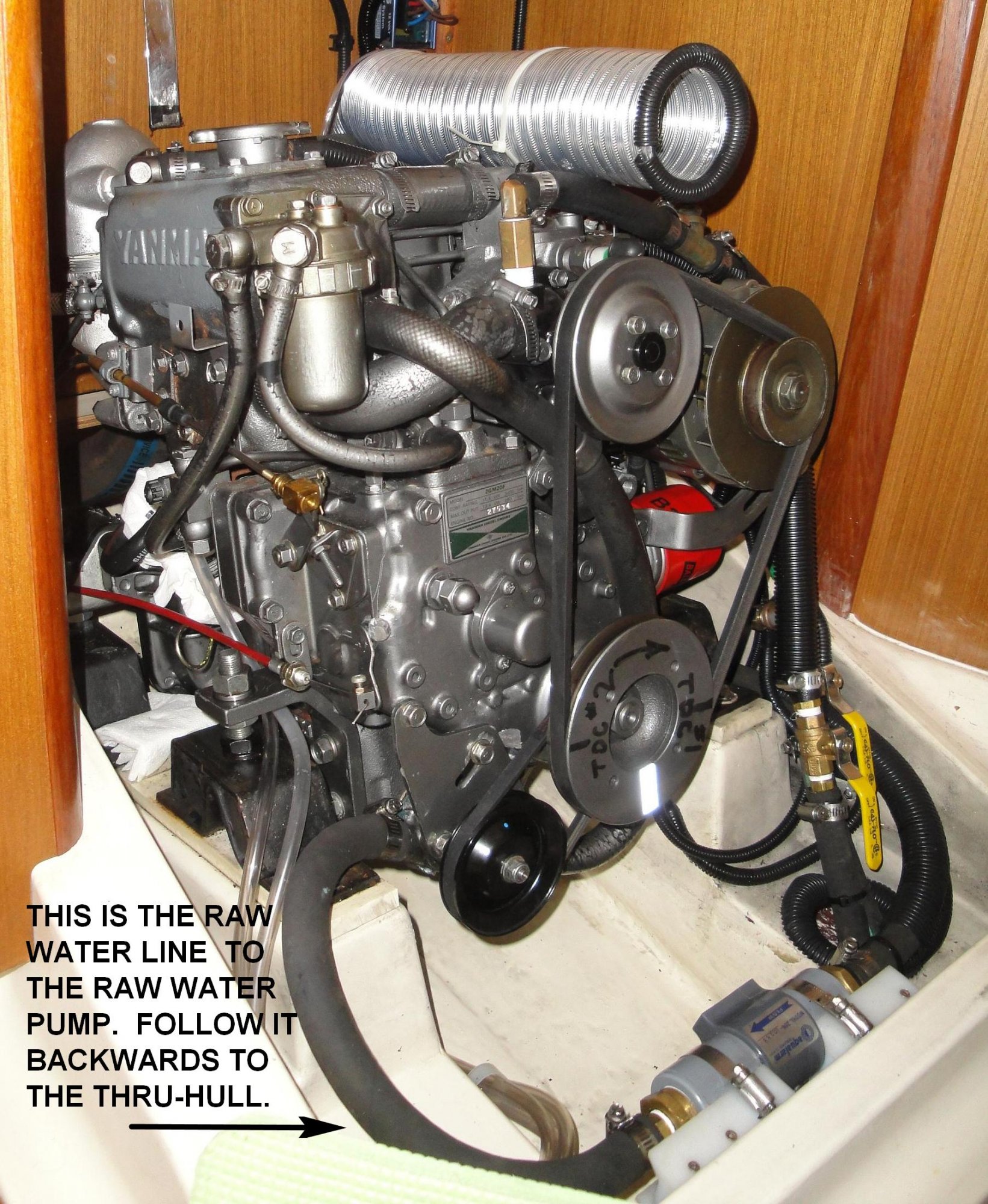

I'll take a wild guess and say this is the raw water to your engine.
Easiest way to find it is to follow the raw water inlet on your engine back to the thru-hull (seacock). This is a 2GM20F but you'll get the idea.

Ralph, Thanks. I have to look again, very little space around the engine to see anything. I can see where the thru hull is but nothing inside the boat and I know its there somewhere. LOL I just took out the fuel sep filter to take it apart, clean it, and new filter. It was put in a god awful place and nearly impossible to reach!

No stupid questions here. If it is the raw water intake to the engine it is normally in front of and under the engine (where you will find the raw water strainer) as shown below from Figure 11.1 in the owner's manual in this link: 27_01 Introduction.indd (sailboatowners.com) . If it is the raw water intake for the head then look for that in a cabinet in the head.

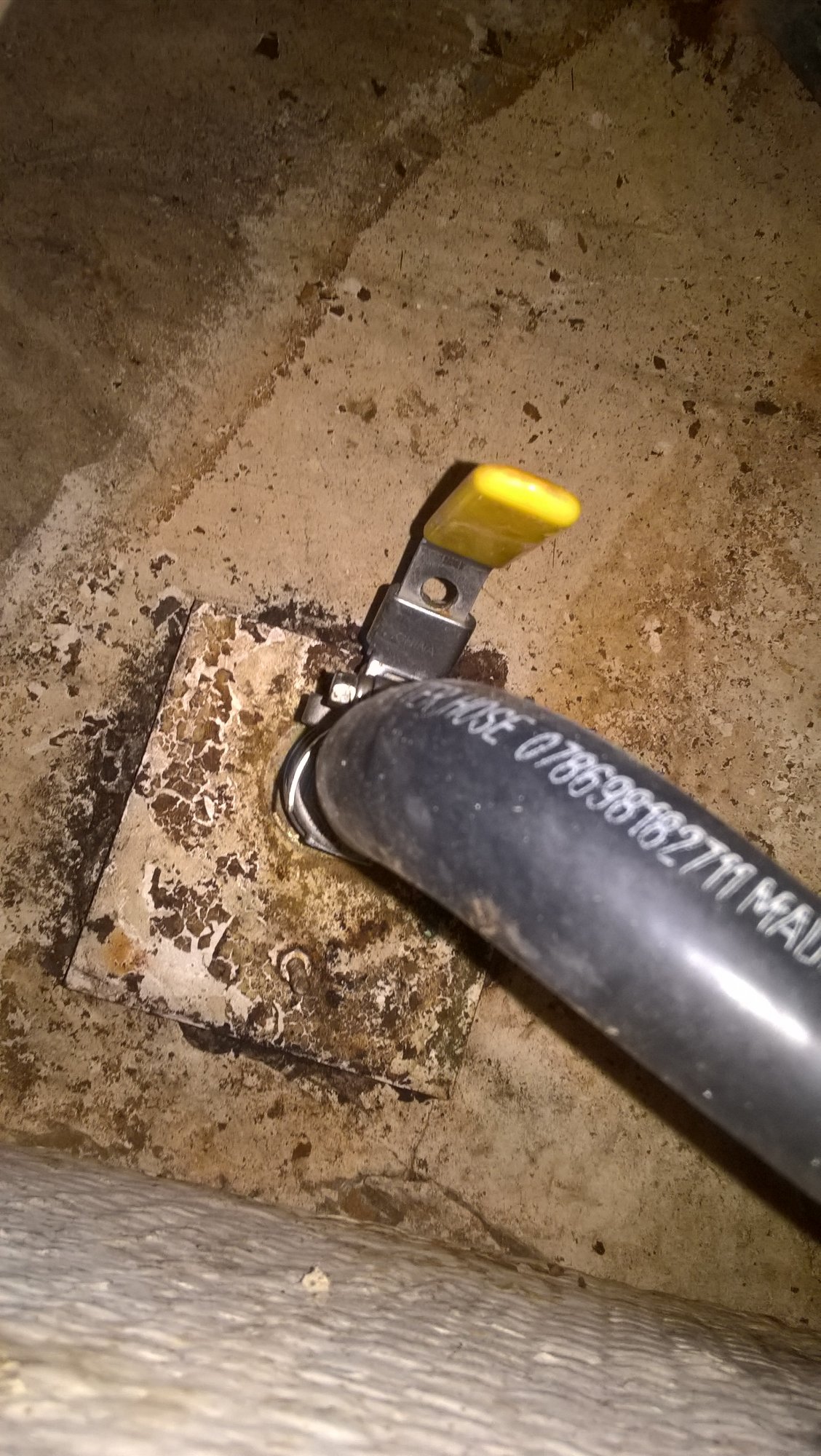

Yippee, Found the raw water intake!!!! I've been looking in all the cabinets and under all the berths in vain. I didn't think to pull out the drawers located next the engine and under the sink. Whoa that is where they put it!! Seemed to me a stupid place, where in my opinion,
in the cabinet would have been so much more logical.
No, what was stupid was to put a drawer over the valve thus hiding it. Also, one has to remove the drawer to access it. In an emergency that would waste precious time. Glad you were able to find it.

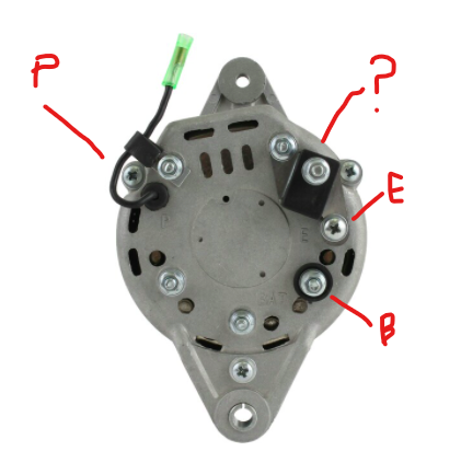

I had to return the alternator to API Marine, the holes for the mounting bolt were too large and the frame would hit the adjustment arm to tighten the belt. I didn't want to drill out the holes on a brand new alternator to replace the sleeves. I did go to an alternator shop who gave me a curved bracket that may work better for the next one. So back to square one with the alternator. I was looking at DB Electrical who shows another alternator with the correct size holes. Item #400-44113. I have three wires......E, B, and L for Charge Lamp....I know the P is for the Pulse tach......does anyone know if the terminal with the question mark is for the charge lamp? It looks like it is isolated.
