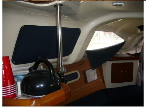

We actually made these out of sunbrella fabric and some snaps. If you want to sleep til noon, these will keep it dark. Total cost under 75. Just made the template out of tinfoil and transfered to fabric. A stock sewing machine.
