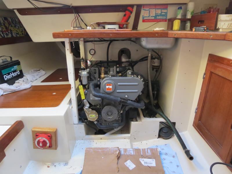

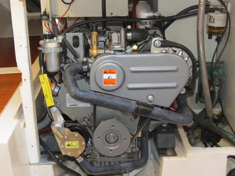

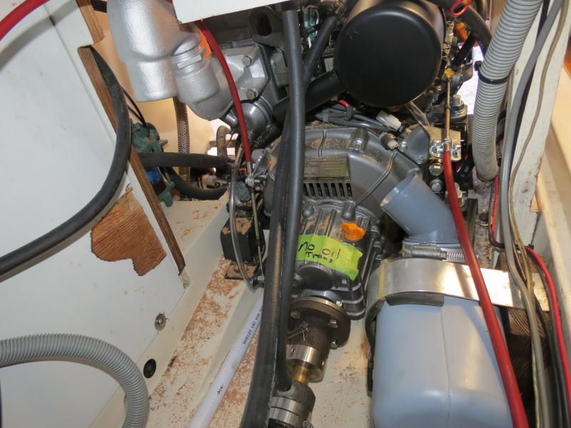

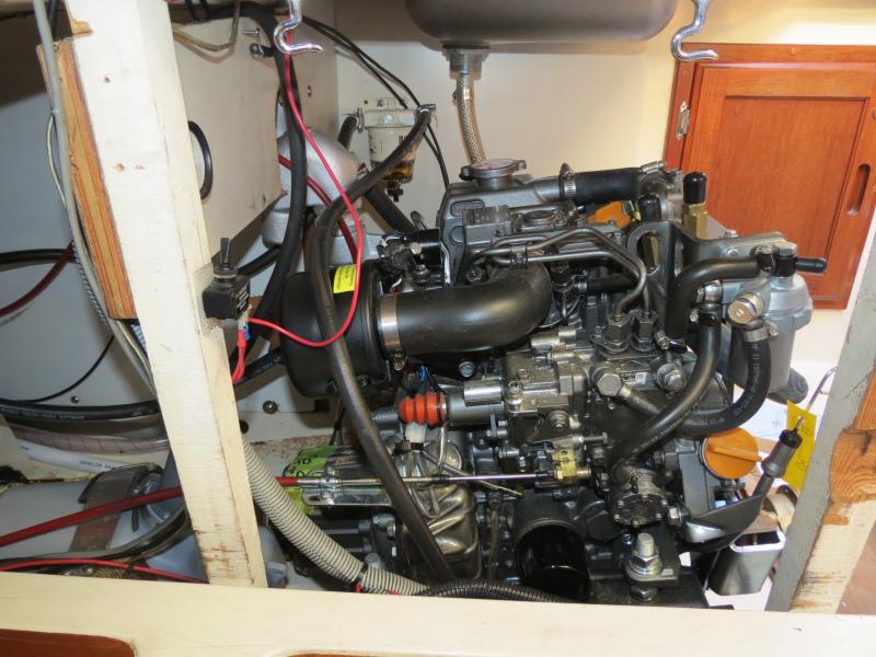

It's a little later than I planned, but the installation has got me excited! Stepping up from the 1GM, I am having a 2YM15 installed. The footprint of the mounting bolts is just 2 inches longer with the same width as my original installation. However, the new mounts are slightly longer than the old mounts. Starting from the shaft coupling, the rear mounts pretty much went in where the original ones went, and the front mounts had to be moved forward. We had just enough room on the mounting stringers!
The water pump projects forward so I will have to re-build the front of the enclosure and probably cut out and rebuild the back side of the companionway stairs. I'll probably lose the storage that I had underneath a lid on the top stair due to the space reduction. Also the alternator belt projects over toward the sink a lot more than before, so my waste compartment is also going to be diminished. We also had to cut out a notch in the rear bulkhead to fit the U-shaped mixing elbow.
The upside is more power! ... Freshwater cooled, heat exchange for hot water plumbing ... smoother running, quieter, and peace of mind for reliability. I'm thoroughly going to enjoy this new improvement! An 85 Amp alternator is Yanmar's upgrade for this model this year.
I know many would question my sanity for investing a new power plant in the old boat when the old powerplant was repairable, but I'm sure I'll find it worthwhile in the long run.
At first, I was a little shocked at the space this new engine took, but looking at the photos, the engine looks perfectly natural in it's new environment! Final exhaust installation is currently waiting on my new fuel tank installation, which should go in first. That will have to wait till Friday's delivery.
10,253
Man that looks really sanitary, Scott. Could you simply install a 2" spacer behind the existing enclosure front then shim the stairs forward the same amount??

Red, I agree with you. Sue is the one who complains about the cost, but when we ultimately move the boat to a new location where I will need to have more confidence in the engine, she is the reason why I want it to be ultra-dependable!
Kloudie, that was my original plan. I anticipated that a 2-inch spacer would do it and the foot of the stairs would still sit on the little fiberglass platform that is built in. But it's just the footprint of the mounting bolts that is just 2-inches. I think all that stuff in front is actually projecting further out than anticipated. It's funny, the dimensions on the drawings seem to be a little off ... I am going to check that out. I think I can rebuild the back end of the stair to keep the footprint of the stair essentially in the same place. I'd rather loose that little bit of storage in the box than squeeze the salon area anyway (small as it is).
