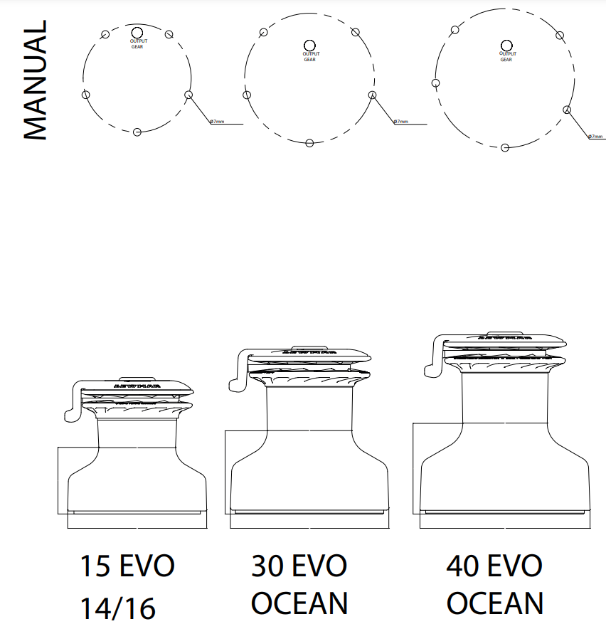

I am replacing lewmar 30s with lewmar 40s. Roughly speaking…How long will it take me to replace both of them on my Catalina 27? Also any tips ? Will I likely need to drill new holes ? Thanks
Yes, you will need to drill new holes.

Are your 30's single or double speed? If they are single speed, consider upgrading to two speed winches #30s. If you stick with Lewmar the holes may even matchup saving you a lot of work.

And look at the mounting area. Will the 40s even fit?
