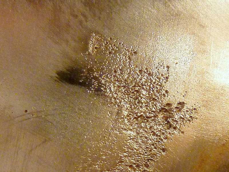

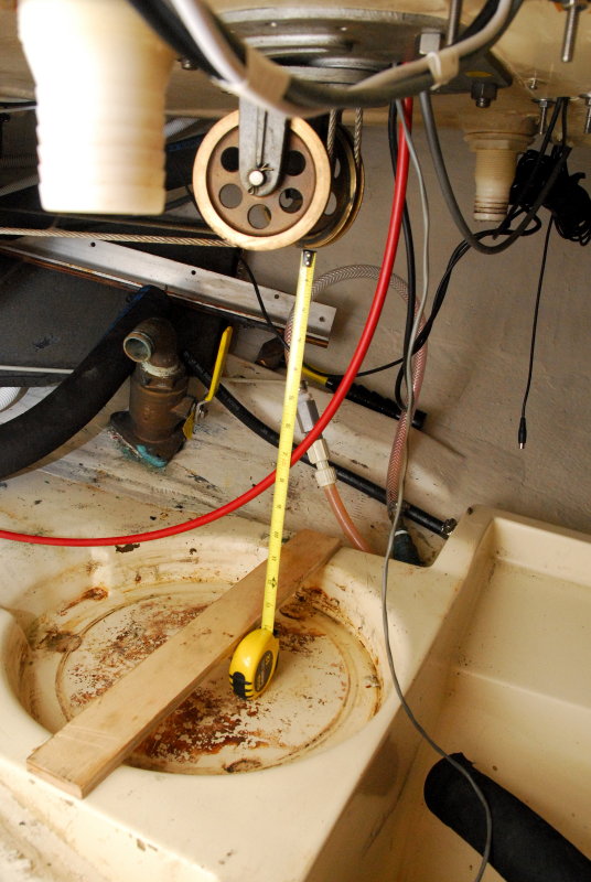

Our boat originally came with a beautiful Atlantic Marine 316LSS water heater. It lasted from 1979 to 2010 before I preemptively replaced it. The only reason I replaced it was because the pedestal & a tank fitting leaked under the previous owner (he never had a pedestal cover) and did not notice the small fitting leak. Due to the age of the tank basic fiberglass insulation had been used to insulate between the jacket and tank. This was well before most companies every used injected closed cell foam. Well the tank sat in about 3" of water and the insulation wicked this water into the base of the tank.
CS had made a nice "well" for these tanks to sit in but never put a drain hole in it. I guess they never assumed enough water could leak down around the compass to matter. & that tank fitting leaks would not happen.
This SS tank literally sat in water for many, many, many years... In this shot you can see the "waterline" around the bottom of the tank.
In this shot you can see the well and the waterline even better.
Despite this highly ABUSIVE treatment the tank was still NOT leaking when I removed it after 31 years of service. When the fuel tank leaked, and I was "in-there", I decided to yank the tank and re-plumb it. This is when I discovered the pitting corrosion and wet insulation. It had signs of exterior pitting corrosion, due to sitting in wet insulation for many, many, many years but even when pressure tested held pressure just fine, STILL WORKING....
This was the worst of the pitting corrosion.
I have seen that same thing play out with glass lined steel tanks and they last two or three years, if that. Atlantic Marine put themselves out of business likely because the tanks lasted so darn long, even in abusive installations....

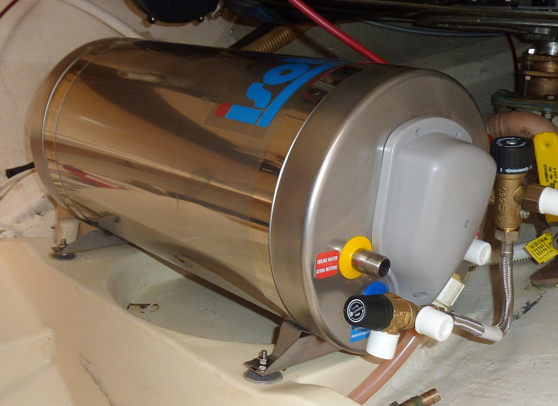

I was going to use a SuperStor to replace it, good history with them, but decided an Isotemp would be a better fit and keep the tank up and out of the "well".
Many people get lucky with the Raritan's, I have seen them at 20 years, but when they are as expensive as a high quality 316SS tank I see no need to spend that kind of money on a glass lined tank. I have also seen them toasted in 3-5 years....
