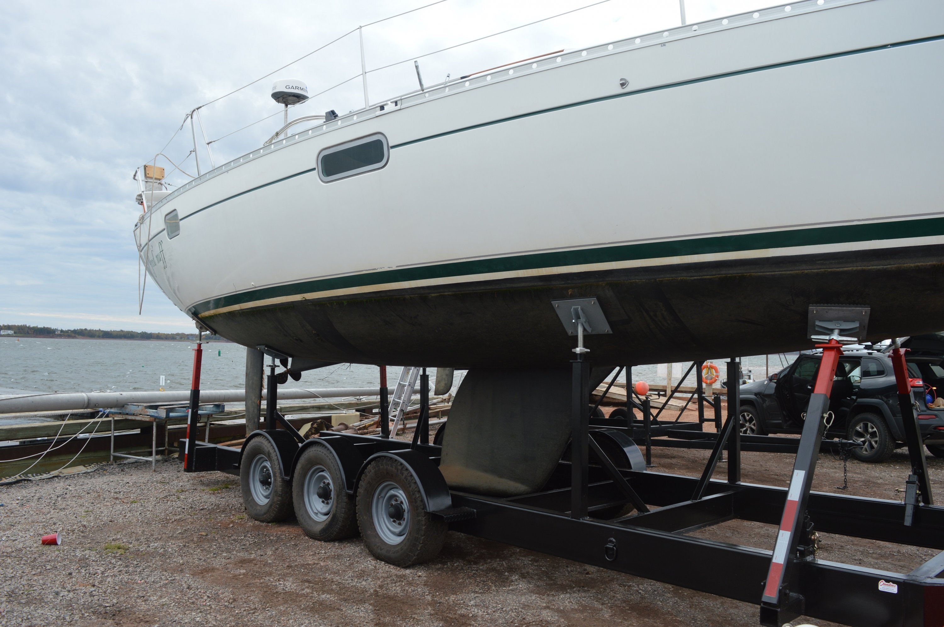

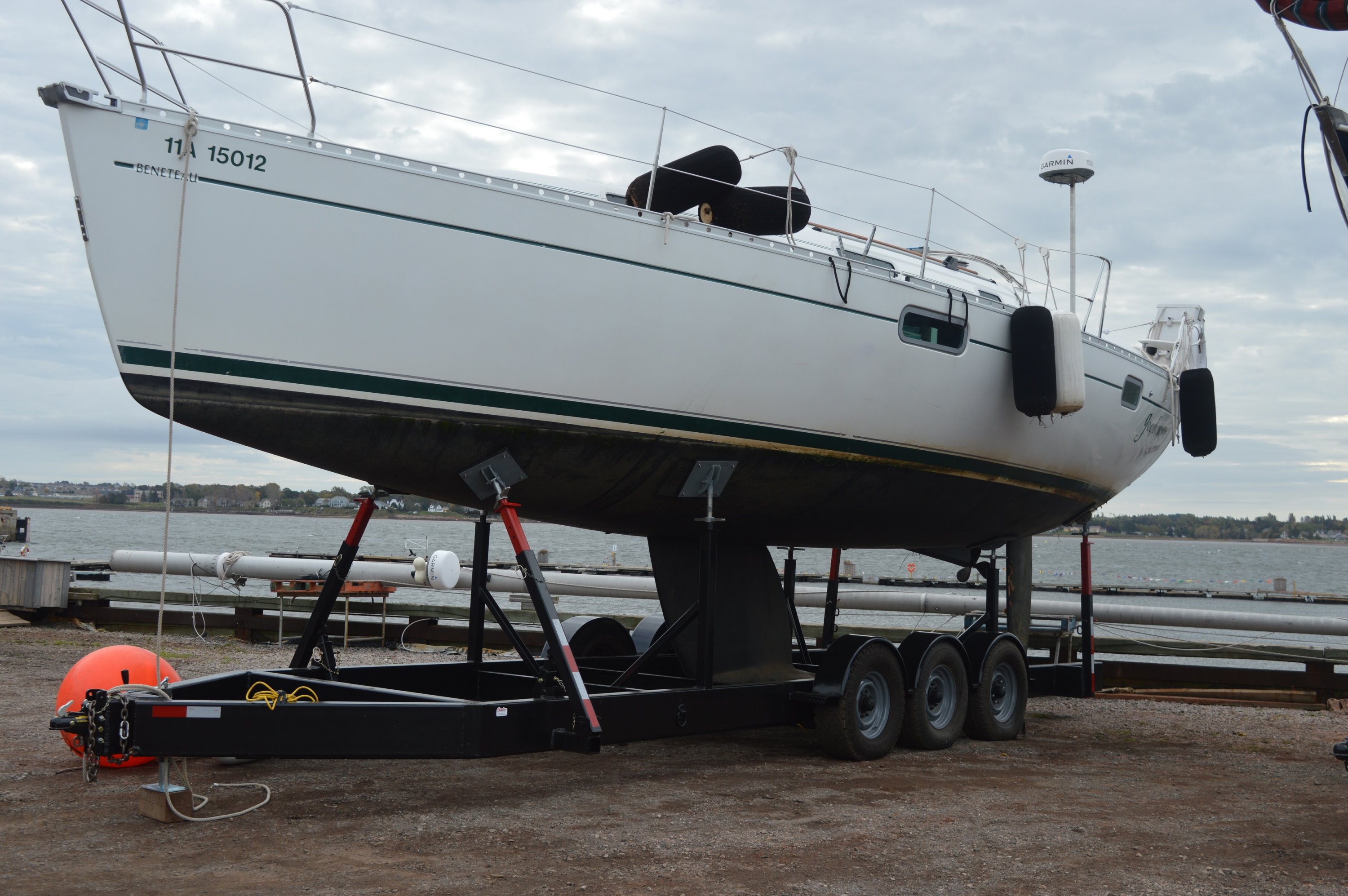

Just finished building a trailer for my Oceanis 351, a little bit of overkill in material size, used 4" x10" hss for the rails, 3- 8k axles with brakes, hauling her home for the winter tomorrow
