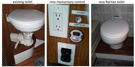

After consulting with Peggie and feedback from the forum I purchased 2 Raritan Elegance standard (since they sit on a pedestal), straight back (since they butt up against a vertical bulkhead), freshwater (since the boat has plenty of water tankage capacity and is on shore water at the dock), 12v toilets with momentary control (since it does not require any programming and it mimics the controls on my other boat). Also purchasing new
Raritan Hose-saniflex sanitation hose for the project.

Photo of the first new freshwater Raritan Elegance toilet with momentary control installed in the aft head. It is quiet and the installation is clean without exposed hoses and pump like the old one on the left. Next steps are to replace the forward toilet and sanitation hose and install teak and ebony marine vinyl flooring on both toilet pedestals to match the remaining flooring.

Installed the momentary control just like the Jabsco control on the sailboat.

Second raw water electric toilet replaced with a Raritan Elegance freshwater electric toilet yesterday. My wife and I are really happy the head toilet smell is gone, bowls are clean and they a relatively quiet. The boat is equipped with 250-gal on-board water supply and shore water supply and a 40-gal holding tank. Today I will insert 1.5" and 1.75" stainless steel caps onto the holes left by the former Jabsco toilet's water supply and discharge hoses (would not have these holes if the PO installed a Raritan Elegance toilet). On good outcome with this project is that I was able to locate the toilet's raw water thru hull valves, one under aft engine bay platform and the other one under the vanity cabinet base through a hand hole, which we created to get access to it.
