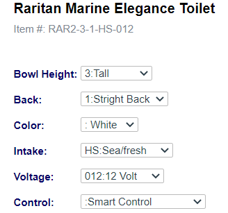

OK.....many thanks...Raritan Marine Elegance it is. Thanks. Is this the right spec as I have raw water now and want to go with fresh but option for raw water?

Your configuration looks right IF you really need the SeaFresh controls...Carl has given you some advice about that.
