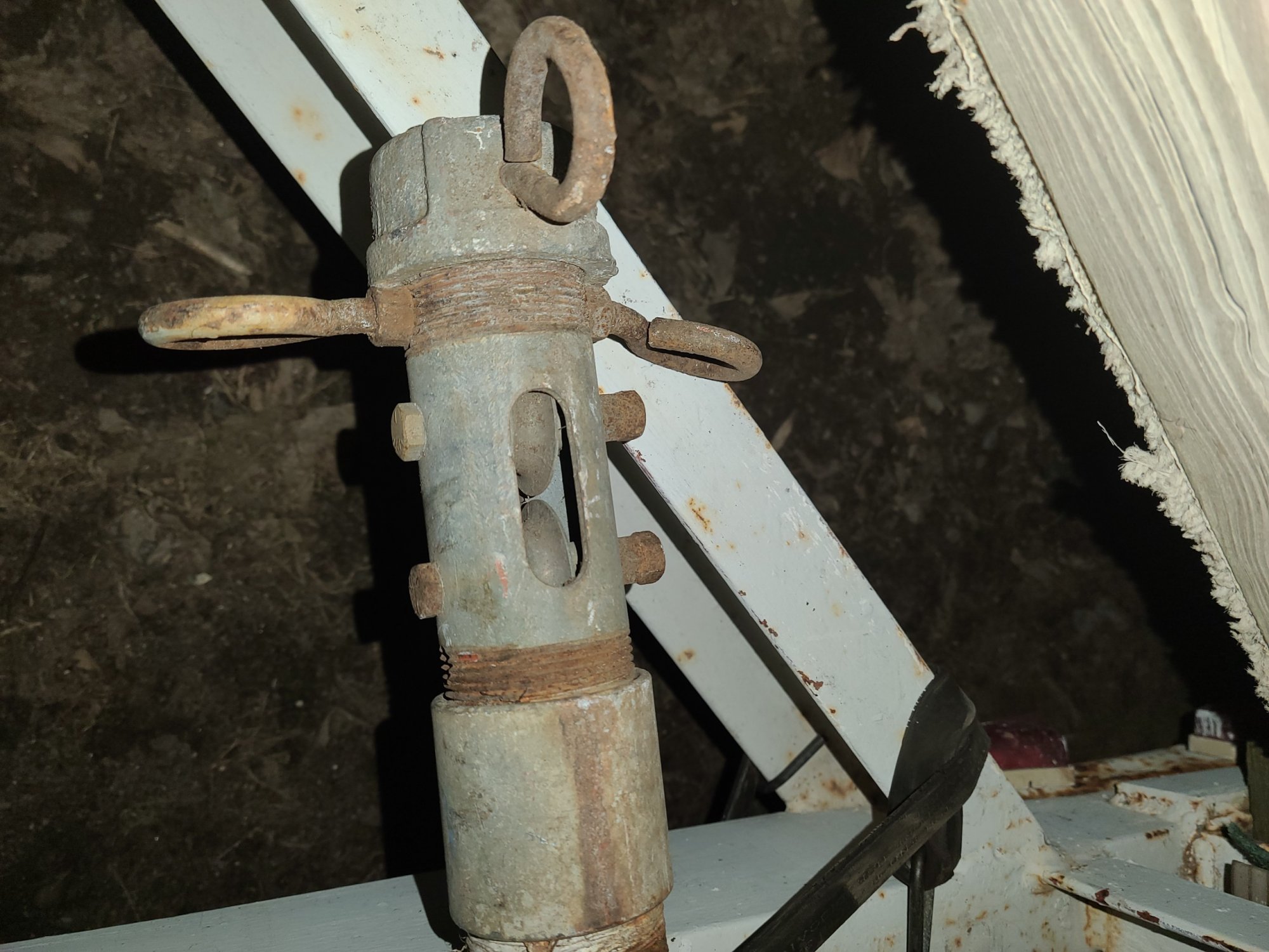

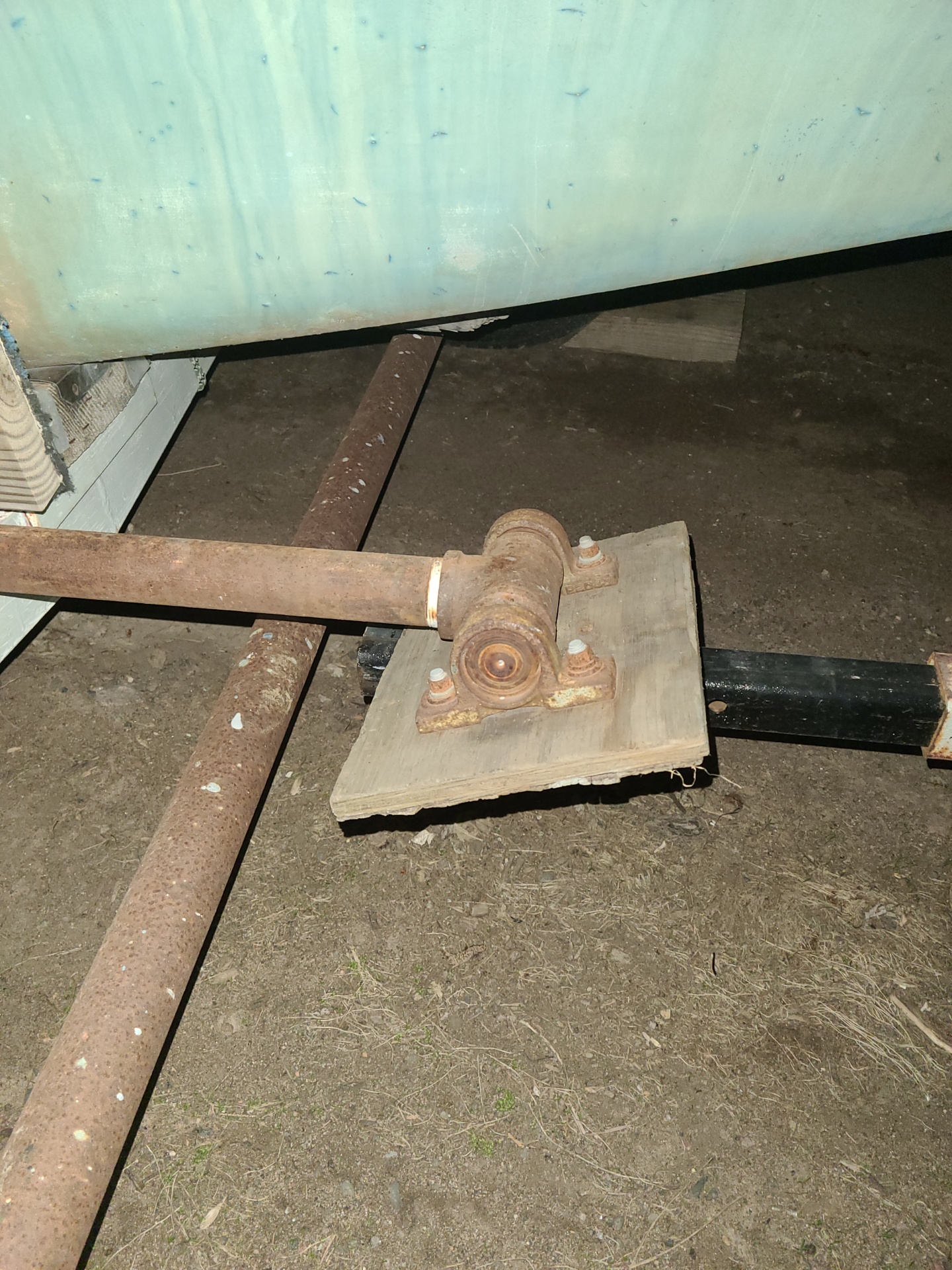

Mast is 29' 3.5" and the gin pole (homemade) being 10' with a block of wood with pivots. The top of the gin pole has three eye loops and an opening with two rollers. The first owner made this and used for years. The second never used it and I'm the 3rd owner. Attached pics.

It looks like it was designed to work off the trailer. My original set up worked that way. I attached a block and tackle to the trailer tongue and then I had a gin pole with two eye bolt at the top, fore and aft. The block and tackle attached to one eye bolt and the end of the forestay attached to the other. The bottom of my gin pole pivots on unused holes on the front of the mast foot bracket.
I've since changed it so that the block and tackle attaches to the forestay bracket on the foredeck, and I added removable baby stays to the mast. That way, I can step and de-step the mast while I'm on the water. The launches I usually go to are frequented by power boaters and I didn't like being in the way all the time when I rigged. Now I pull and launch just like a power boat, and step the mast as I'm motoring away. I made a custom fitting on the top of the gin pole that hooks onto the turnbuckle at the bottom of the forestay. So the forestay starts out attached to the block and tackle, and then it's attached to both the block and tackle and the deck fitting, and then I disconnect the block and tackle and gin pole. Solid control of the mast at all times.

I'm sure Dave will give you some good ideas about a mast raising system and explain the benefits and gochas that you might run into. Just off hand I would not recommend trying to use the system that came with your boat as it looks to have missing and rusted up parts also the guy that designed it isn't here to show you how to properly set it up. I think it is a mistake to try to use the trailer winch to raise the gin pole and mast because if you ever decide you want to raise or lower the mast while on the water it's really hard to find a place to put the trailer when you're not using it.(there is however a post somewhere on this site where somebody reported that they did launch the boat and took the trailer with them:)) You also might consider something other than a jin pole as do the British that use A-frames to get under bridges. Also if you're going to use temporary guy wires to anchor a jin pole (often called baby stays) you should consider Dyneema fiber line or similar.
