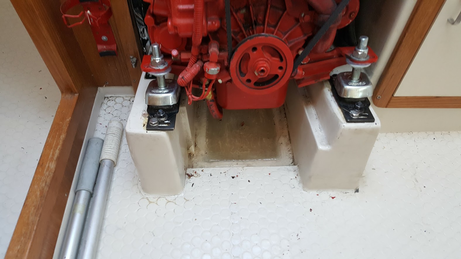

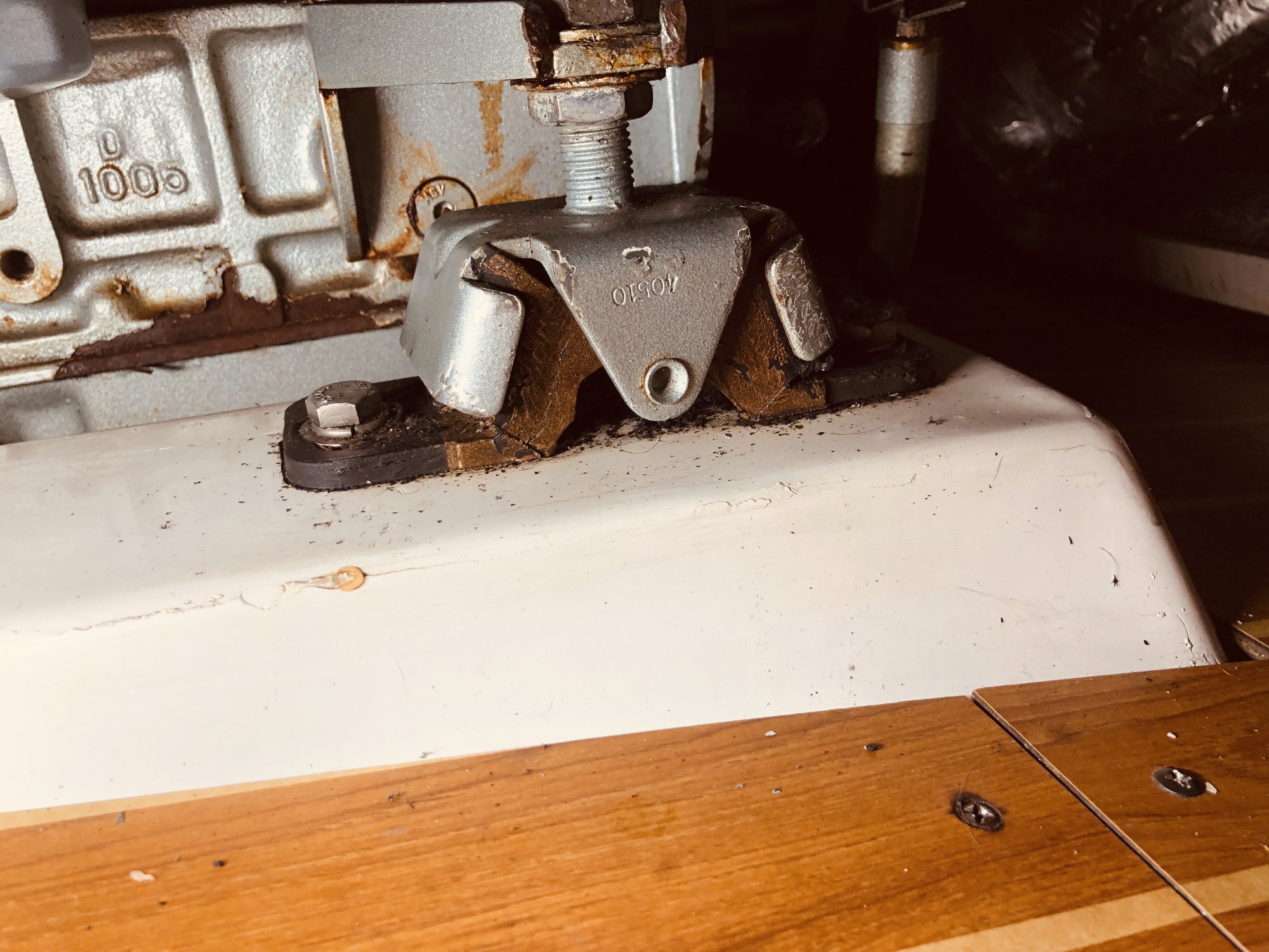

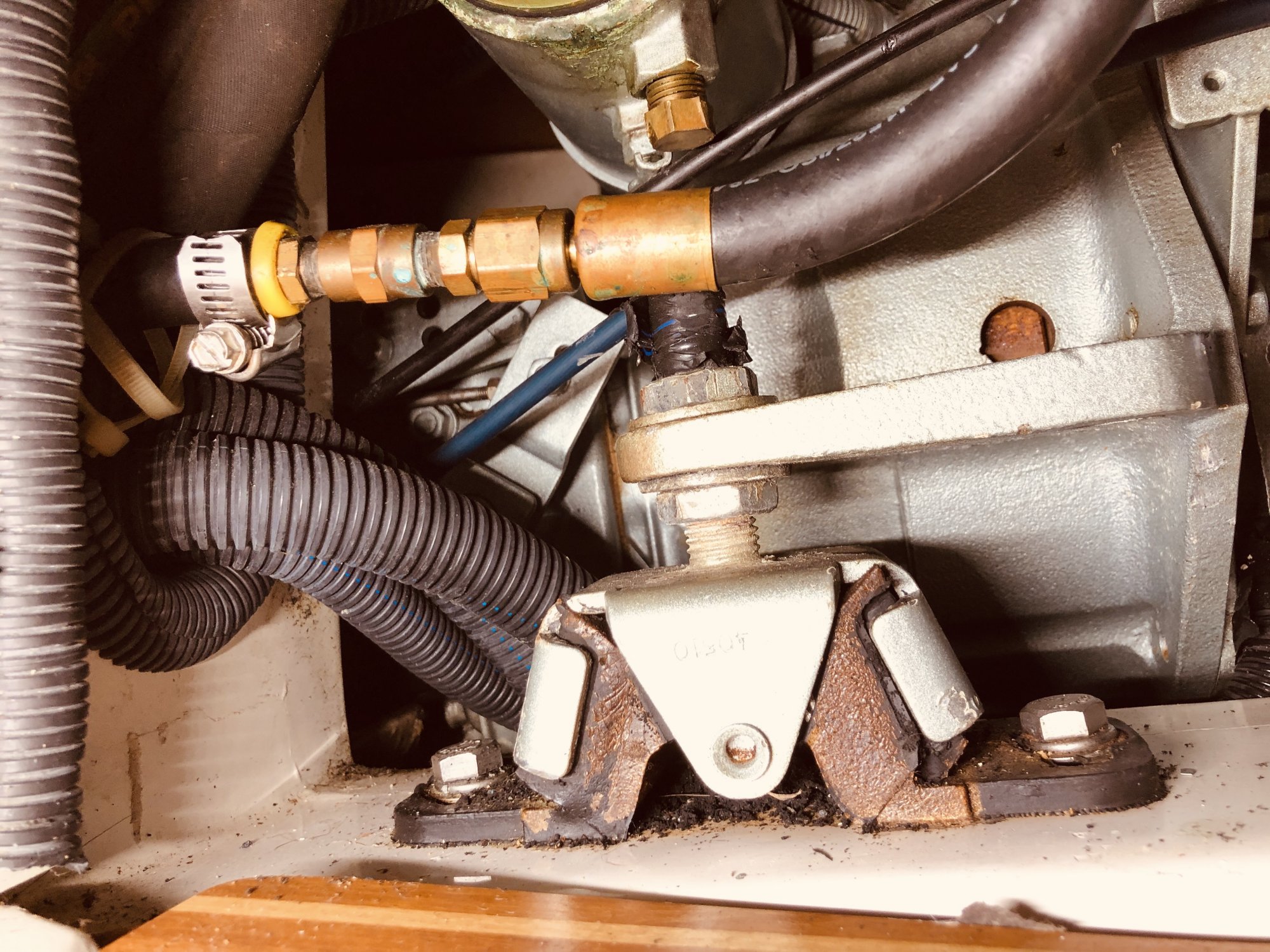

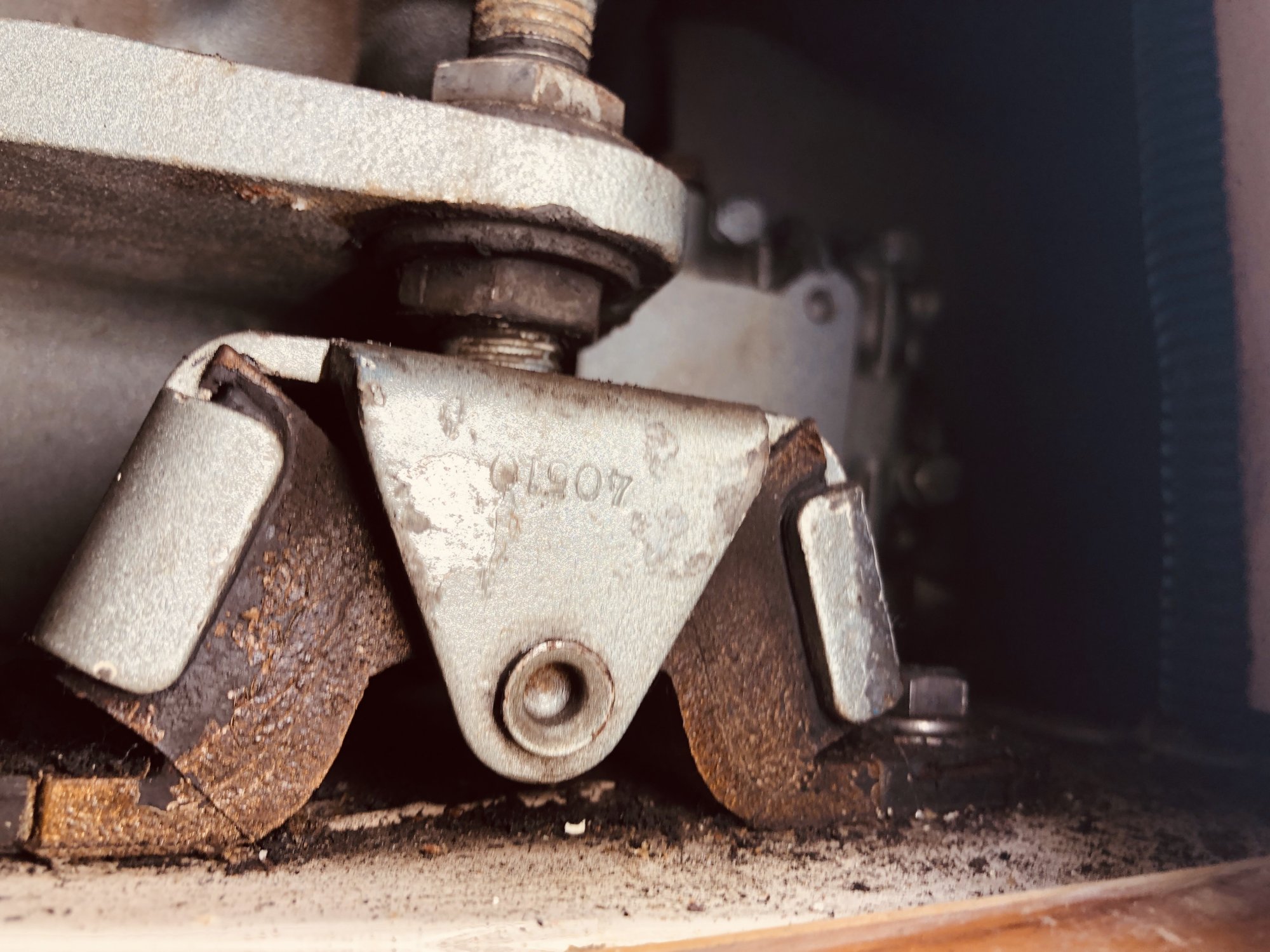

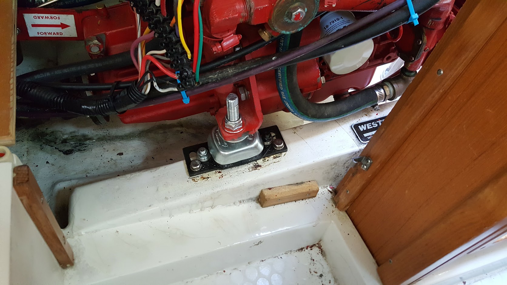

In the pictures it does look like the mounts have squashed down quite a bit.. they still hold the engine fine under load though.. But since they are 16 years old and i'm planning a few long trips next season i'm considering replacing them.

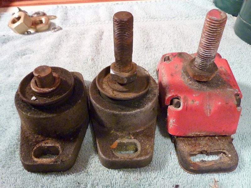

This is from Mainesail's article on motor mounts.
Motor Mounts
The red mount on the right is an older style Westerbeke/Universal factory motor mount. They are well designed, robust and do a very good job of isolating vibrations despite their rather expensive price tag. That red one had 2782 hours on it and the two failed mounts to the left are low hour mounts that had already been replaced once before.
There are features of the Westerbeke/Universal mount that make them well worth the money:
1- You can’t physically twist the stud inside the mount because it is welded directly to the mount cap.
2- The feet are encapsulated in molded rubber helping to minimize noise and vibration transmission to the hull.
3- The metal cap prevents engine oils from eating away at the rubber by shielding it.
4- The mount is fail safe and designed to survive an inversion of the boat without the motor separating from the mounts.
In short I am not a big fan of the two mounts to the left and I have seen the same type of failures repeated prematurely a number of times.
Having read the above, I opted for OEM mounts. I did add a 1/2 inch thick stainless steel plate under the forward mounts since the original setup required the mounts to be near the top of the studs.
They are pricey but sometimes that is how it is for quality.
I think the original mounts failed prematurely because the alignment was off from the factory. This seems to have been common on a number of boats. We also went through 2 cutlass bearings in 600 hours. Since then we got 1300 hours on the next cutlass bearings. Probably didn't need it but we don't haul that often and I was replacing the PSS bellows it was a cheap preventative maintenance item.
