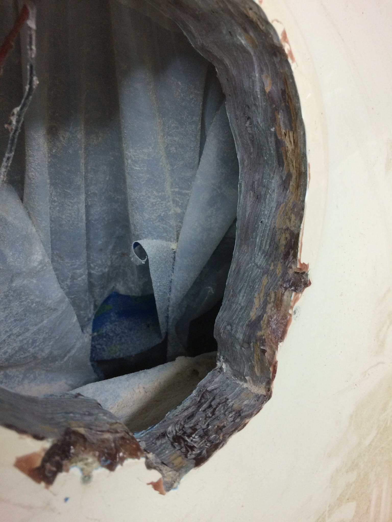

Understand your existing compass is likely mounted to both the cabin top and the upper cabin liner. You may find a need to do some 'glass work to fill the void. See pics of my compass install:
This shows the filled void after packing in some West Systems epoxy mixed with colloidal silica. It isn't pretty but it WILL allow the rubber gasket on the back of the compass to compress and seal.
