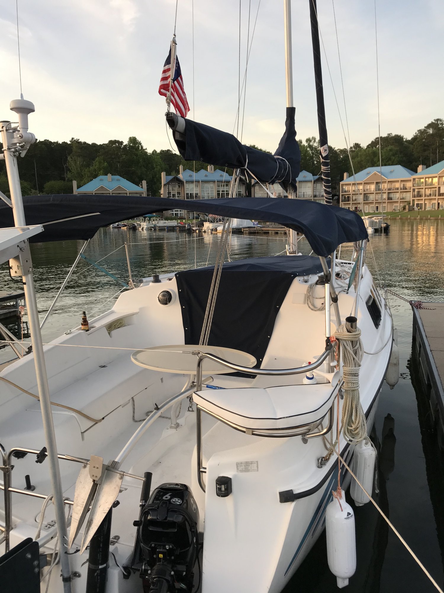

:plus: on the stern anchor... Here is how I have my stern anchor set up (see pic). The black tube has 10' of chain in the bottom and the rode is seen cleated to the fishing rod holder.... it runs outboard to the bow eye...
It takes me 15 seconds to uncoil the rode and toss the anchor off the stern. I use it all of the time.
