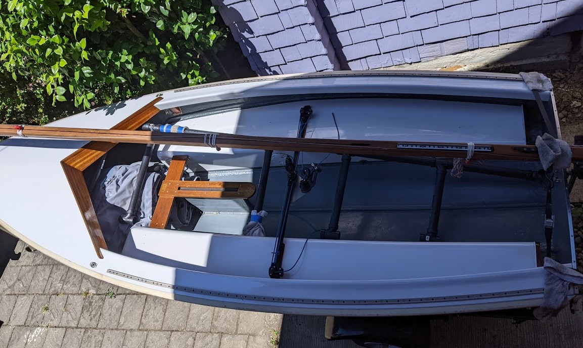

Hello! New member here, and new owner of an International FJ (aka Flying Dutchman Junior). Since it seems mine is unusual in that it has seating (most pictures that I find have wider sides, and you just sit on those), here's a picture:
I trailered it down to the lake where I was planning to launch it, and upon arrival I discovered water pooling in the center. Long story short, the previous owner sprayed foam inside the seats as a sealant, and it appears to be retaining water from who knows where. Owner claims it's been covered all along so we're both a bit baffled. I've also learned a valuable lesson to REALLY look inside any compartments I can't see inside of. :p Guess that'll be for next time - fingers crossed it hasn't been there for years, working away on the internals. :/
Anyway, for the moment I'd like to figure out what I can do about this. I'm going to pump the water out manually first, then see if I can dry it out from the inside. Assuming the problem will reoccur though, I'd like to add drainage holes to those seats - the current ones you can see a few feet sternwards from the traveler are sealed with foam and only seep, very slowly. My question is, once I figure out where the bulk of the water is and drill some holes (through what I assume is some sort of wooden core) how do I seal them to prevent water retention in them? Just some sealant? Also, what size and type of drill bit would I use for this, is there a standard size for these drainage plugs? Guessing a Forstner will probably cut through the glass and core (whatever the core IS in these FJs)?
Thanks for any assistance. I'm probably going to be coming back for fiberglass/resin/epoxy help for some of the minor cracks, or if I manage to figure out where the leak is. I've watched videos, but don't have any practical experience on weights, type of weave, how many layers, etc. At least I think the resin is straightforward if you just go with West Systems (I plan to).

It looks like you have an access port here
What happens when you open that? Can you see the foam? Is the foam soft and squishy or firm and dry? If it is squishy, you got a real mess on your hands and you will have to try to remove most of that foam. I'd suggest putty knife duct-tapped to the end of a shopvac hose and go after it.
Good morning @Qorgyle! Although the Flying Dutchman variant is a little different, I used to race FJs in high school, so I've messed with them quite a lot. I've never heard of anyone spraying foam inside the hull, but it couldn't hurt anything. I believe the water inside the cockpit may have been inside the hull already and leaked into the cockpit during transport due to excessive movement. Drilling holes in the seats is a bad idea; if and when you capsize (these boats aren't very forgiving due to a rather short daggerboard), you'll need the hull to be watertight as possible. I'd run a shop vac into the service ports to try and remove any water left inside, and you should be alright to sail after that. Enjoy, she looks like a fun boat!
You know, I opened it and for some reason (it'd been a long day of installing trailer lights and trailering for the first time ever already) I utterly failed to take pics inside it. I know there's some water and I could feel the foam - but it was damp (from the water), but firm. So hopefully that's ok.
Definitely. We discovered this before ever setting down on the water.
Ok, good to know. I was going to put in drain plugs and seal them with WS5200 but I'll hold off in that case!
I'm going to be taking the shopvac and a little manual pump (with a flexible hose to get in the corners) so I think I'm ready. :D
Thanks all! Will report findings Sunday when I get back down there.
