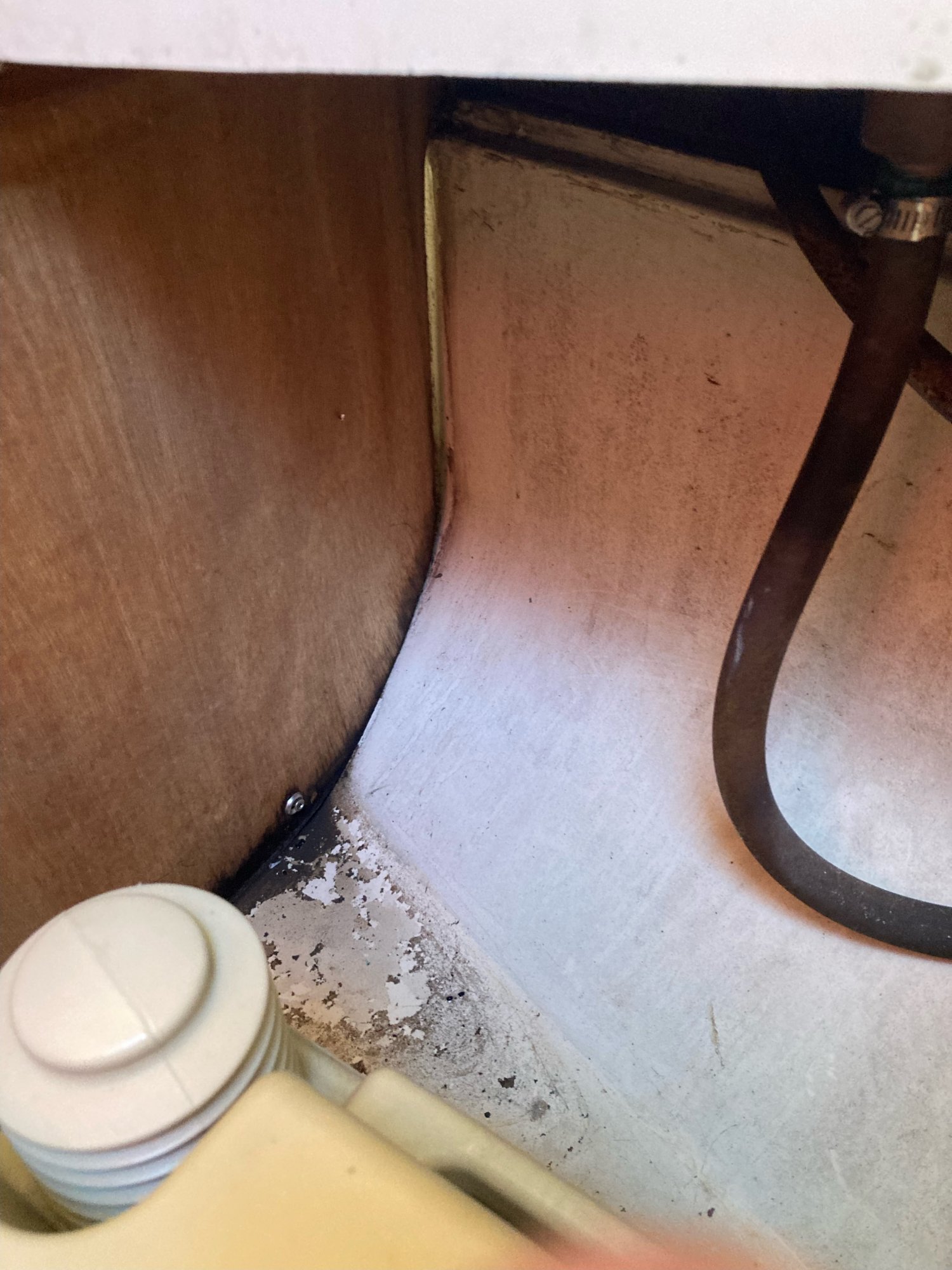

Greetings, I have recently inherited an Oday 23 with a rotting compression post and port side bulkhead. There is no hole in the hull, so I think the water must be coming in from rain. Is there a typical place water gets in? Or will I need to go sit in the boat the next time clouds gather?

Or do you think there might be too much flexing? I can see a little sliver of light between the bulkhead and side of the boat, so the tension of the stays and shrouds pulling the mast down is evidently crushing my boat a little.

I don't think that sliver of light indicates an issue.
On the deck does the mast step show signs of settling, creating a small bird bath depression around it?
From your photos it doesn't look too bad to me. Yes, it is black and rotting but to the point it won't support the mast pressure? Can you poke a pointed screwdriver into it and the wood is soft? Then it's an immediate problem. If the mast is not sinking and the wood still has structural integrity, clean it up and enjoy sailing it.
I also noted the cabin sole under the compression post has no cracking or other indication that it is rotted and sinking.
As noted above, inspect the chain plates where they attach to the bulkheads. If the bulkheads are rotting around the chain plates that is a more critical issue. If they pull out the mast would come down.
And yes, you got the right terminology.

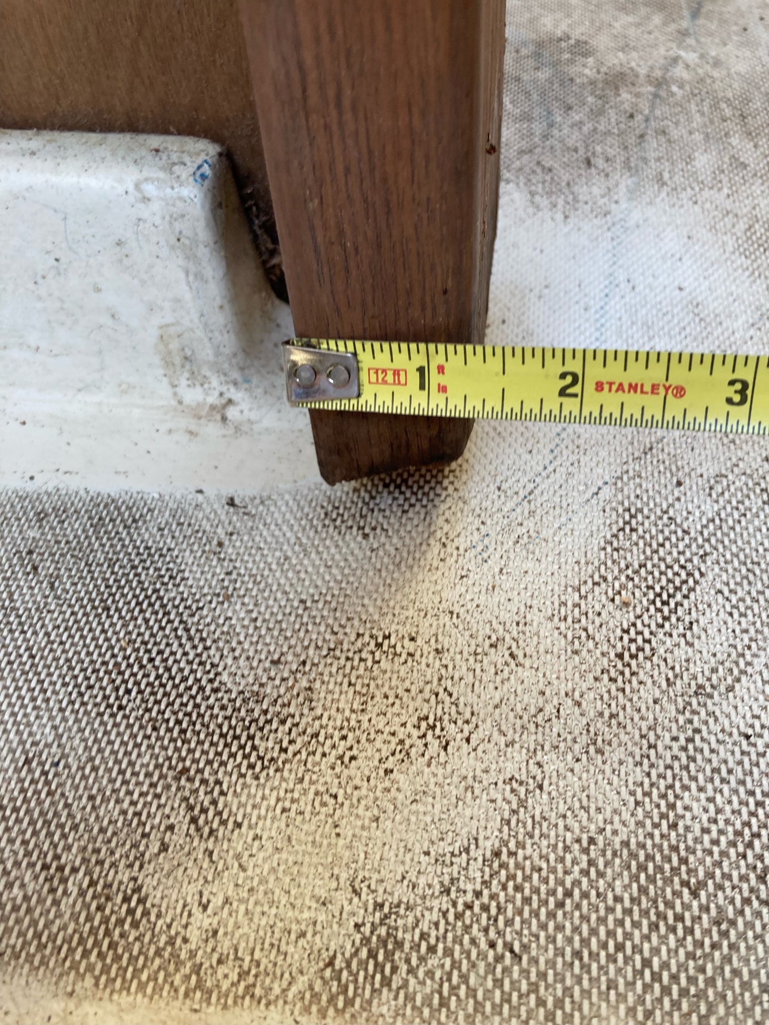

The bottom of the port bulkhead is dark and starting to rot, but the compression post was the worst. The bottom 1/2 inch literally crumbled out when I poked it with my finger. I went down today to stuff a piece of lumber under it. I cut 1.5" from the floor, but the wood still crumbled away. Luckily, the piece of wood was about 3" long, so I just re-cut the post. A wood shim hammered in made it tight. The deck doesn't look sunken. I couldn't measure the post because it crumbled before I got the chance. I'll double check the port side to see if it will hold.

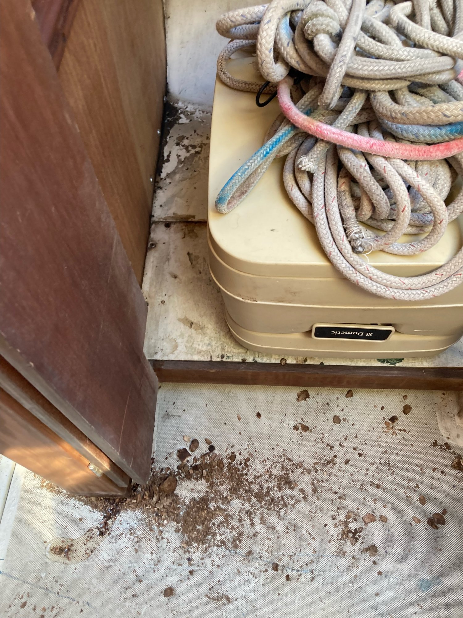

The compression post repair lasted for a couple seasons, which was nice. The boat is now back on the trailer, the mast is down (and off), and I just pulled out the rotting port side bulkhead. I have lots of grey, dusty mildew behind the sink that needs to be cleaned up. Again, this damp wood just crumbles at the bottom where i touch it. I have a plastic 2x4 cut and notched to function as a new compression post and I am trying to source a 1/2" sheet of HDPE to use for the bulkhead. Now my real concern is sealing the chainplate. Apparently, every time it rains, water is drawn down the plate, as evidenced by a stained trail on the bulkhead below the chainplate. Does that just get caulk up top, or do I need to remove the plate somehow? Thanks for all the advice, I really appreciate it.

This old bulkhead had screws holding it in at the top and bottom. Why is HDPE a bad idea? It probably weighs maybe 30 pounds more, but it seems pretty strong at 1/2" thick.
