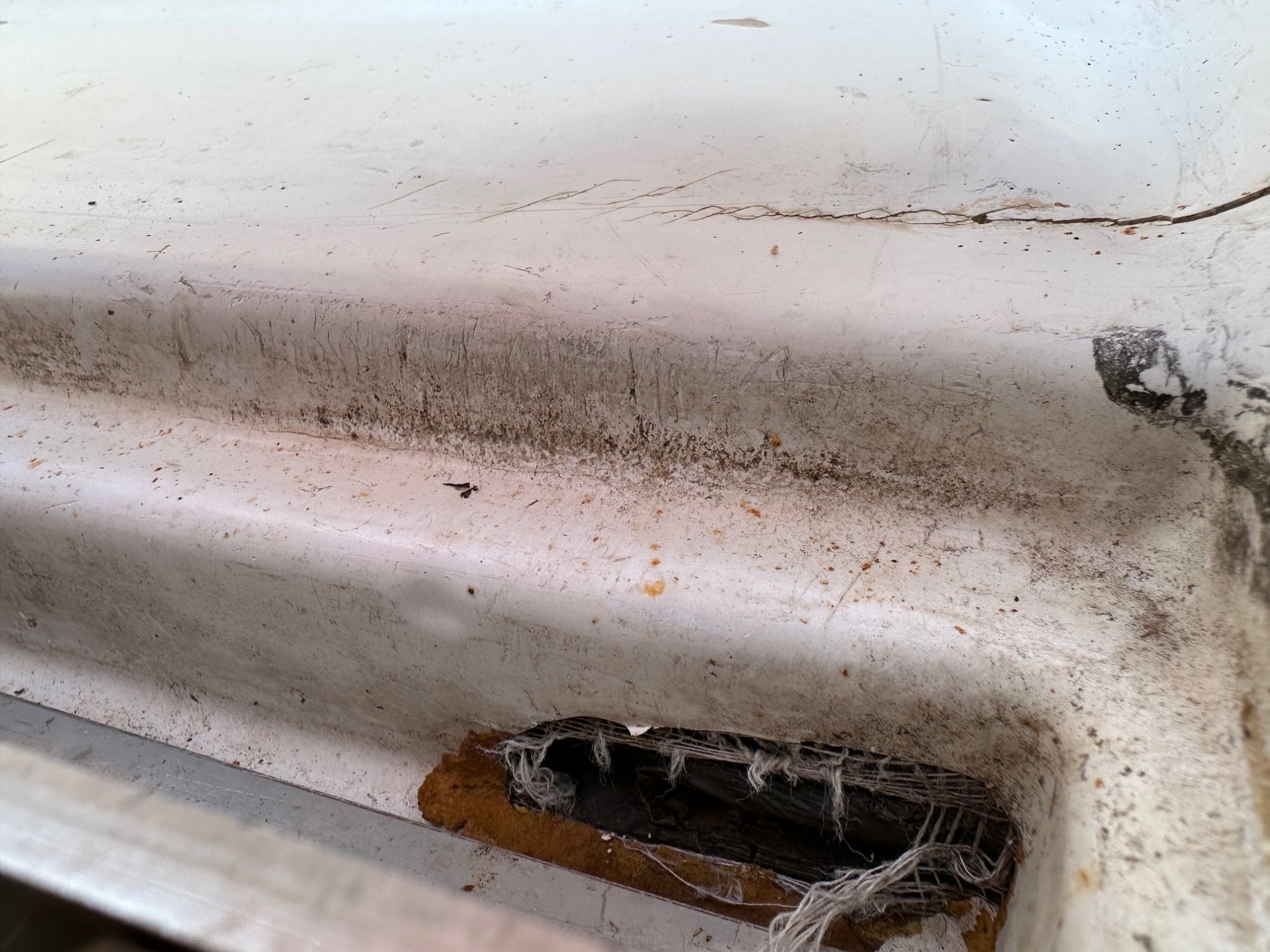

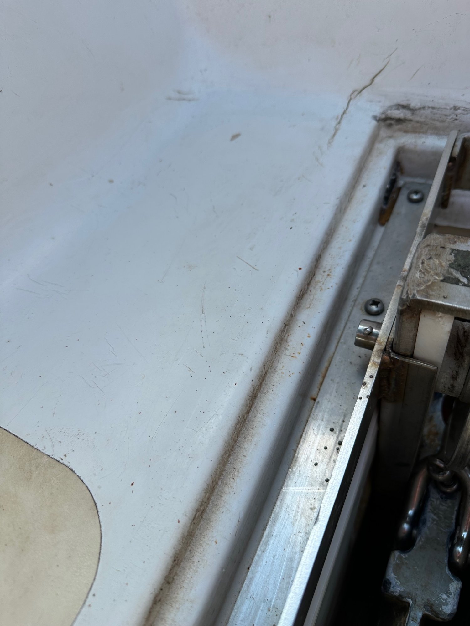

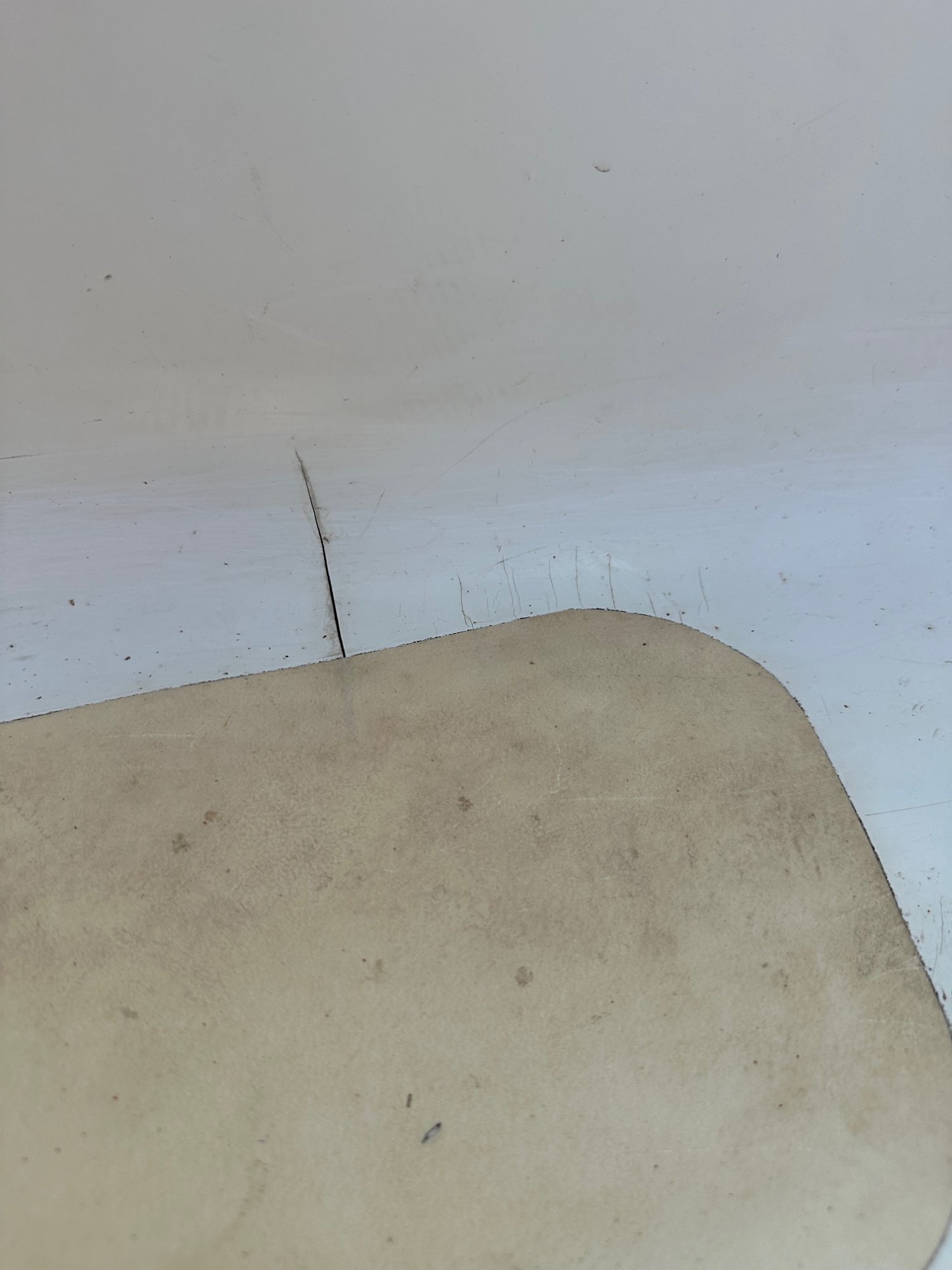

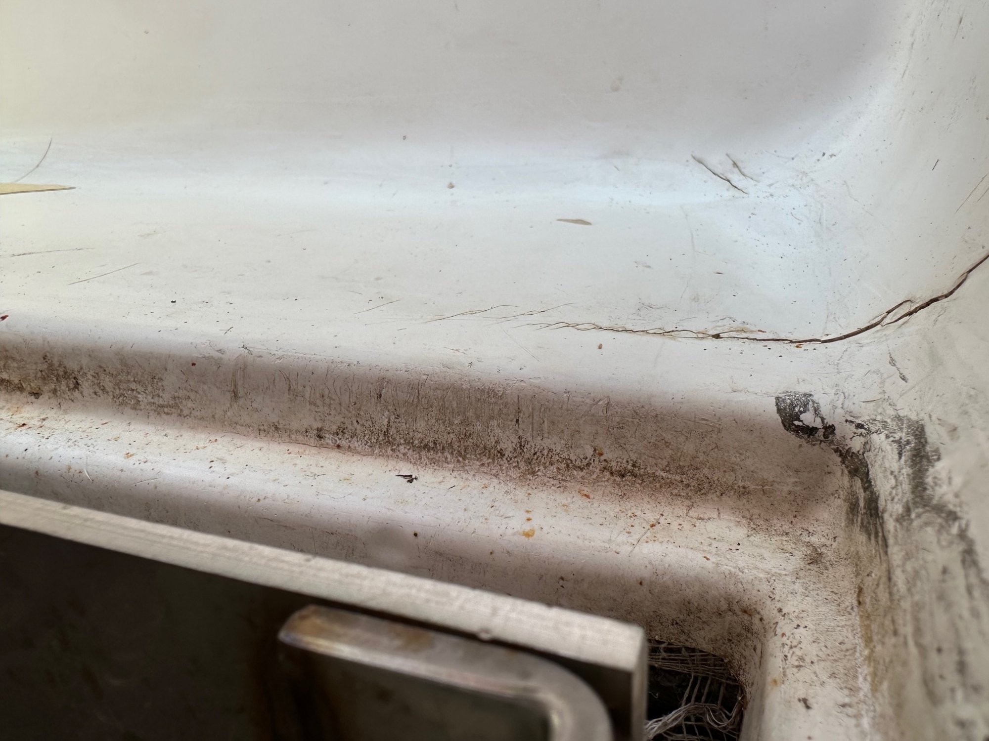

A more serious question, I have what I can only describe as 2 'blisters' on the floor of my cockpit 6’’+ in length. One is near the hatch opening and will 'squish' down when stepped on. There is also a 'razor' like cut into the flooring nearby that will poof up water if I step nearby. I have dried everything out as much as possible and my plan is to use some Git Rot after I drill a few holes into the impacted area. Is this a good plan or is this a bad plan? I don’t have any previous experience working with the plastic that the boat is made from but I assume there is some kind of wooden core under the decking?

You're going to want to get all of the water out of there before you start doing any kind of repair. A good way is to apply a vacuum, which will remove water and moisture - make sure the core is dry (10% moisture or less). Any repairs done with water/high moisture in the cure will not hold.

You can use a vacuum pump, you need to leave it running for a while (hours). Works best when the deck is warm from the sun - if you can achieve 30 Hg (easily done with a pump), moisture will "boil" away at 70 degrees fahrenheit. Otherwise, you would need to tear out the wet core, which is a lot more work. This is the only way to get a permanent fix.

Some of the people who have hull blisters spend months drying the spots out, and that's on a vertical or overhead surface. Your spots are facing up, so it will be difficult to extract enough water so that a repair will solve the problem, unless you set up a vacuum system (not a home vacuum). Perhaps you can rent one, or perhaps a yard near you has one.
Your other option would be to cut out the cockpit floor from the top, rip out the soggy material, then replace the core and reglass. Neither is fun or particularly cheap, so you might want to decide if it is worth it on a 21' boat.

In theroy, as this boat is plastic, could I cut a 'U' shape with a dremmel, peel back the top layer, remove the soggy bits / repair then plastic weld the skin flap back down?

Pictures attached, nothign like a resolution image to make me feel like I really missed looking over this boat when I bought it. I am really hoping to be able to keep this boat sailing for a while, willing to get my hands dirty, just need to know what to do.
