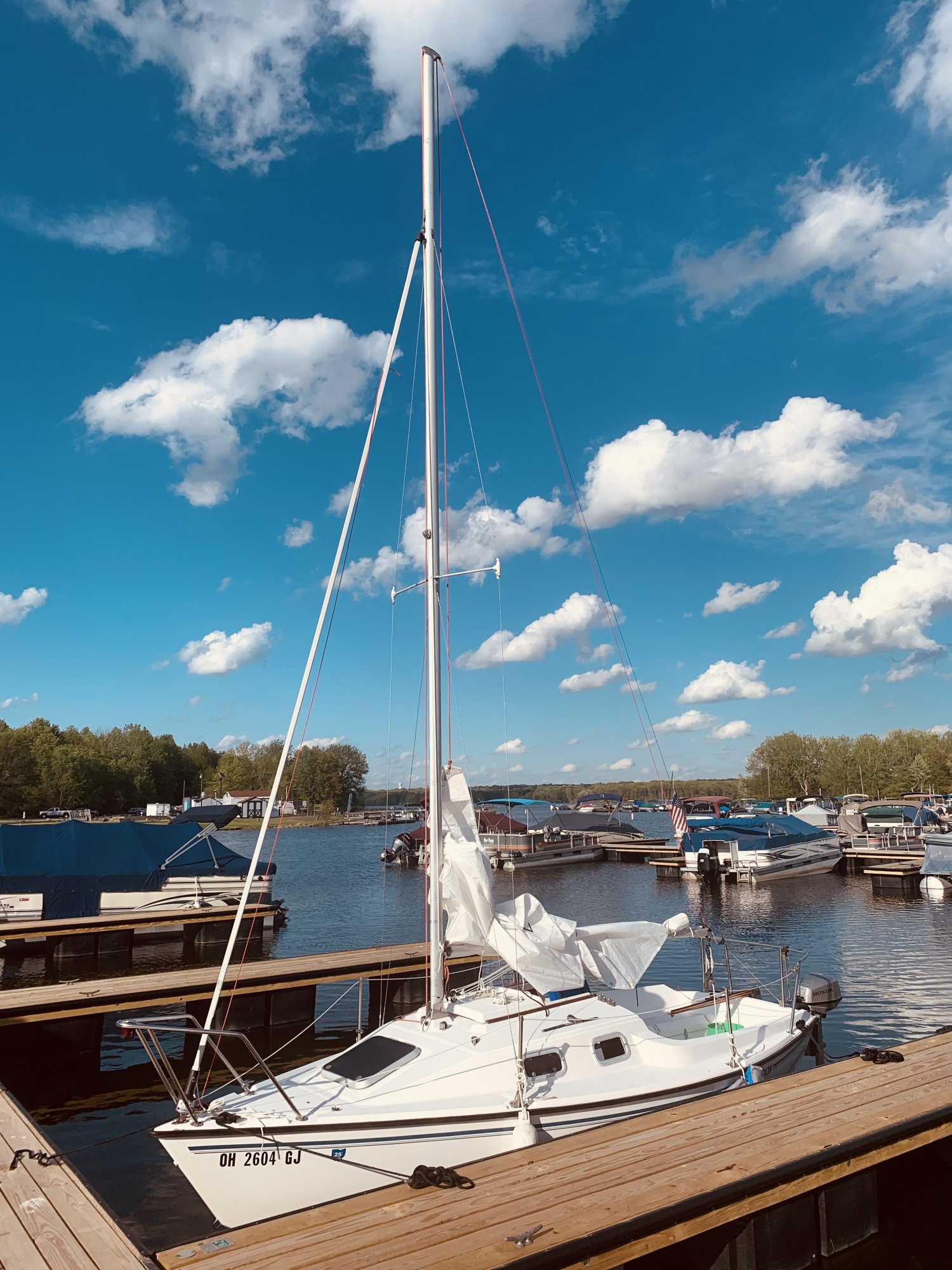

This is at transient dock I later moved it to summer dock a couple rows over. Since I dilly-dallied around getting a slip I am next to a pontoon boat. There is 3’ between us! With someone with me no problem but I singlehand 50% of the time and fortunately the slip next to me (opposite pontoon boat) is payed for but no boat in it. I park there and move it by hand into my slip. Looking for a out-of the box solution for reliably docking this thing without banging it up?

I assume the picture you posted is typical of your permanent slip, you just think three feet of leeway is too tight.
Learn to account for the wind. There is no wind to speak of in the picture you posted, the flag is hanging at rest. But, you must experience a prevailing wind. What about current? Is there a tide with changing currents? Is it a river with one direction of flow?
1. Consider backing in. The steering end of a boat is the most maneuverable. The other end can blow off its line sometimes. Backing in, pulls the bow behind, forcing it to try and follow, while driving in forward can make it more susceptible to wind controlling it.
2. Land at the end of the finger dock and then rotate in, bow or stern first, by hand. Spring lines are your friends.
