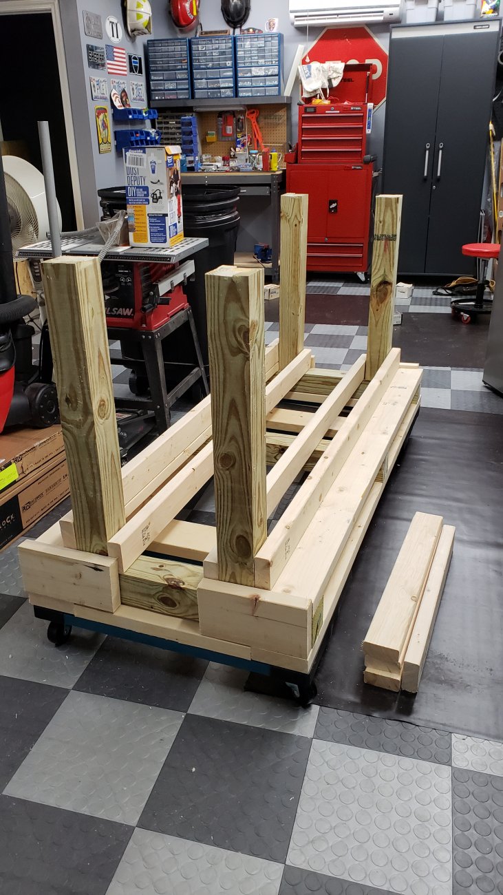

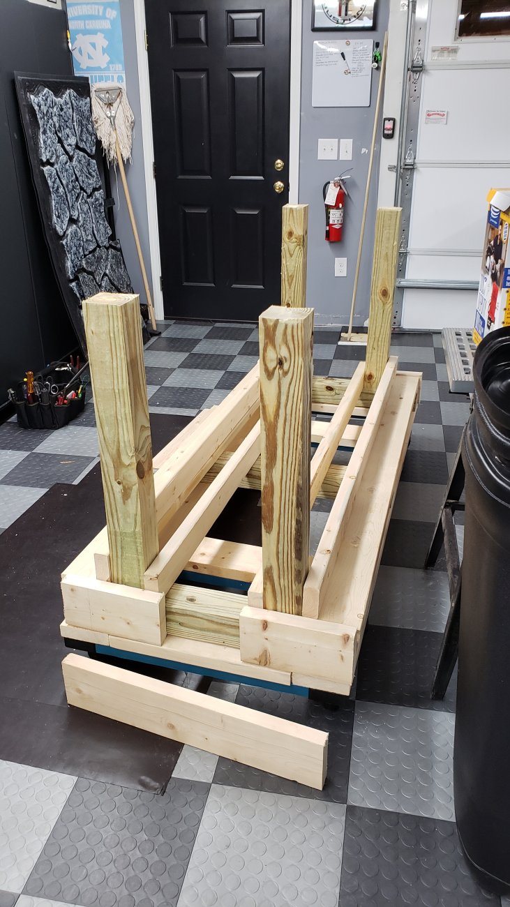

You guys are way smarter than I am and whew those were some fancy ways of saying get yourself some more proper bracing on the boat. It's been raining here solid for 2 days but as soon as it breaks, I am heeding your advice and I will get it shored up. I did build this fancy keel cart yesterday so I can remove the keel for inspection. It's actually just cut and placed together I haven't bolted it together yet. I had to go get longer lag bolts. But I won't be on or under the boat until she's properly shored up.
