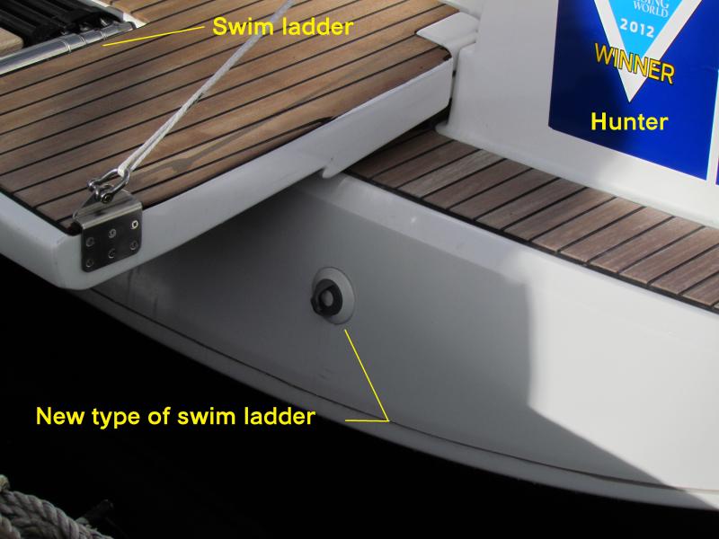

At the 2012 Seattle boat show, I looked at the sailboat swim ladder progress.
Seems Catalina still has not had a real person in the water
and try to deploy and use there swim ladder......but they did put a handle to hold on tooo.
Maybe just maybe the Catalina 315 will have this changed.

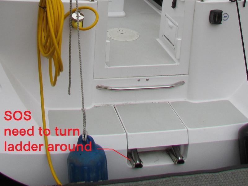

A better ladder design?
I have my original ladder and have thought about going to one of those telescoping as they are kind of nice, but have not wanted to go to the trouble of drilling new holes for something that is not all that better than what I have. I do like my solid ladder, but sometimes it would be nice to not have it in the way of the transom. It would seem to me a better design would be on that bolts onto my existing set up and has slides and a cover so someone in the water could grab it and pull it from the water and the cover so you could step on it without it getting into the way. Thoughts?

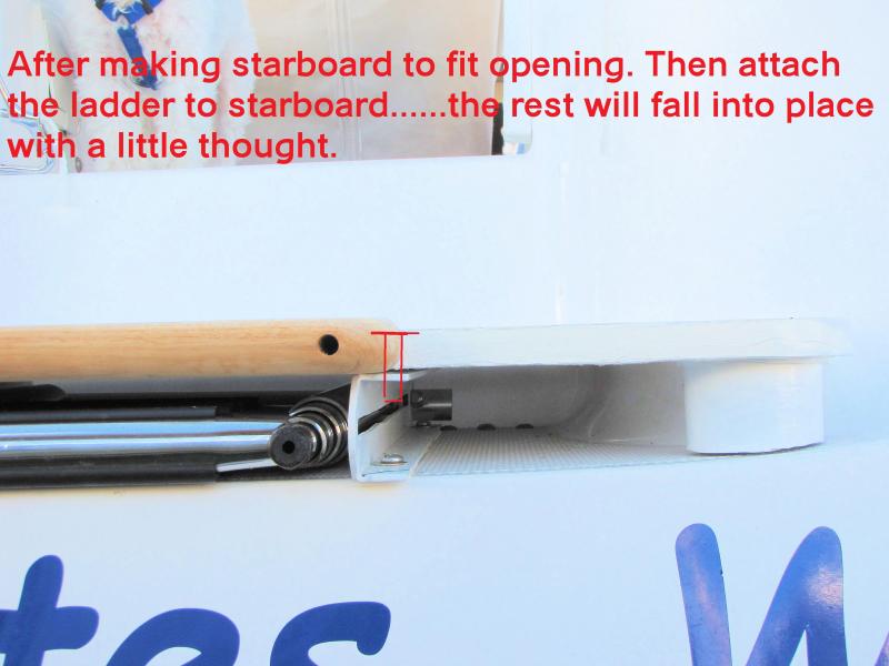

I will look for the sketch in which I was going to attach the telescoping ladder
to the existing swim ladder brackets....because these brackets are not eaisly removed.

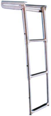

Here is an almost great idea
I am thinking of something like this, but I want it to hook to my existing fittings and have a piece of starboard over the top so you can step on it.
http://shop.catalinaowners.com/prod.php?8580
Wondering if you flip it over, drill 2 holes that match up to the existing/original fittings (assuming the distance between them matches), and then add some L brackets to attach a piece of starboard and you are in business. May also need to cut away some of the L bracket at the end so the ladder could swing all the way over. Guess I need to go measure.
Seems to me it would be at least possible to slide this out if in the water to get back onboard.

Dimensions off of the Amazon website
  • 2-Step Ladder: Length Folded: 11". Length Extended: 17.75". Width (Outside of Bracket): 10.75". Proof Load: 1190 lbs.
  • 3-Step Ladder: Length Folded: 12.75". Length Extended: 27.5". Width (Outside of Bracket): 10.75". Proof Load: 1190 lbs.
  • 4-Step Ladder: Length Folded: 14.5". Length Extended: 35.5". Width (Outside of Bracket): 10.75". Proof Load: 1190 lbs.
PaulJ's idea to mount it on the bottom of the cover has a lot of merit.

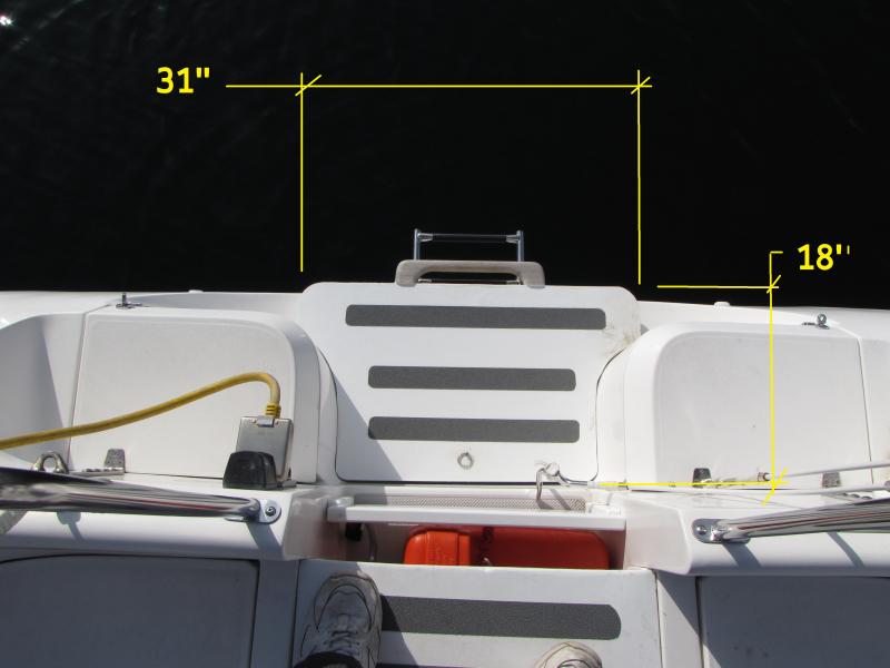

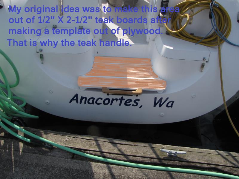

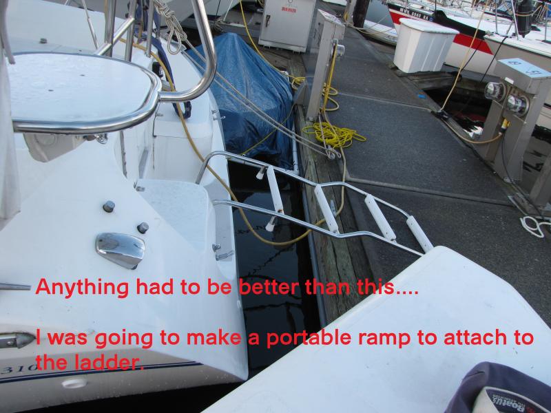

My original idea picture.........
After 5 coats of marine paint on the 3/4"
marine plywood, the platform seems to
be holding up OK after 3 years.
I leave it in place all year round.
Added finished dimension picture for Dale.
paulj :troll:

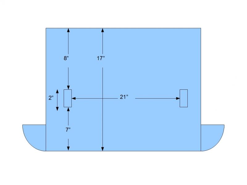

Swim Platform Measurements
Was down at the boat today and measured my swim platform. Here is a picture. Ladder I referenced is 10.75" Wide, it is 21" between the two brackets. Ladder is 11", 12.75" or 14.5" when folded up, bracket is about 8" up. Still thinking it all out.
PaulJ, How wide is the ladder you got?

there is a catalina 350 at my dock that has a hinged latter so it swings out of the way while at the dock. I have been thinking about doing something similar.
paulj
Mar 16, 2007
1,361
Catalina 310 Anacortes,Wa
:pix:

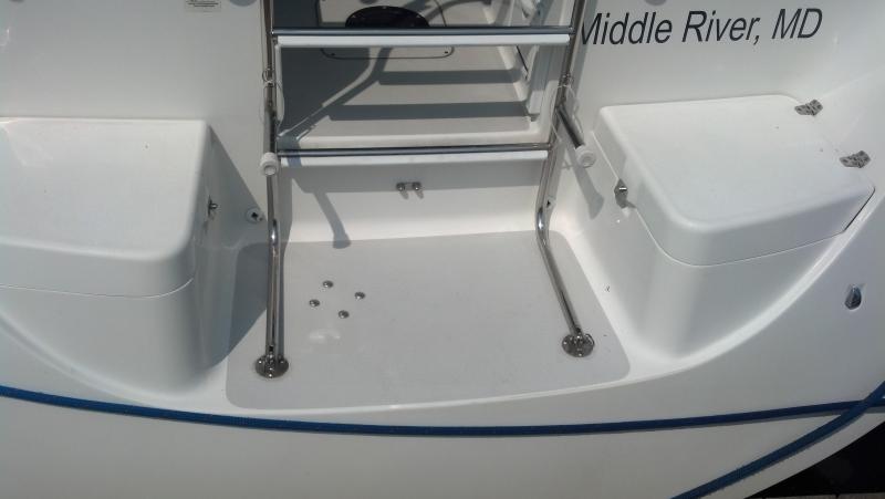

attached are the photos of the ladder on the Catalina 350. It appears that it has a pin on each side and the ladder separates at the pin. I have seen the ladder before and just 1 pin was pulled and then the ladder just rotates/swings to the side while at the dock. I did not get a picture of this though since the owner was not on the boat.
I really like this idea and need to figure out how to modify my current ladder. Hopefully the owner is there next time I am at the boat.
