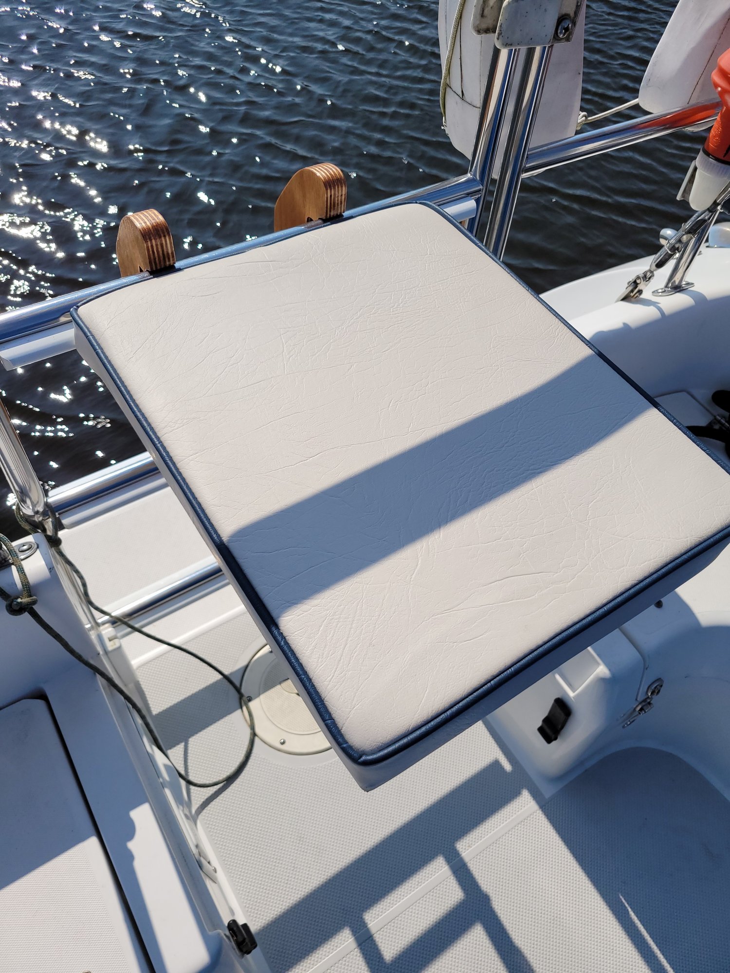

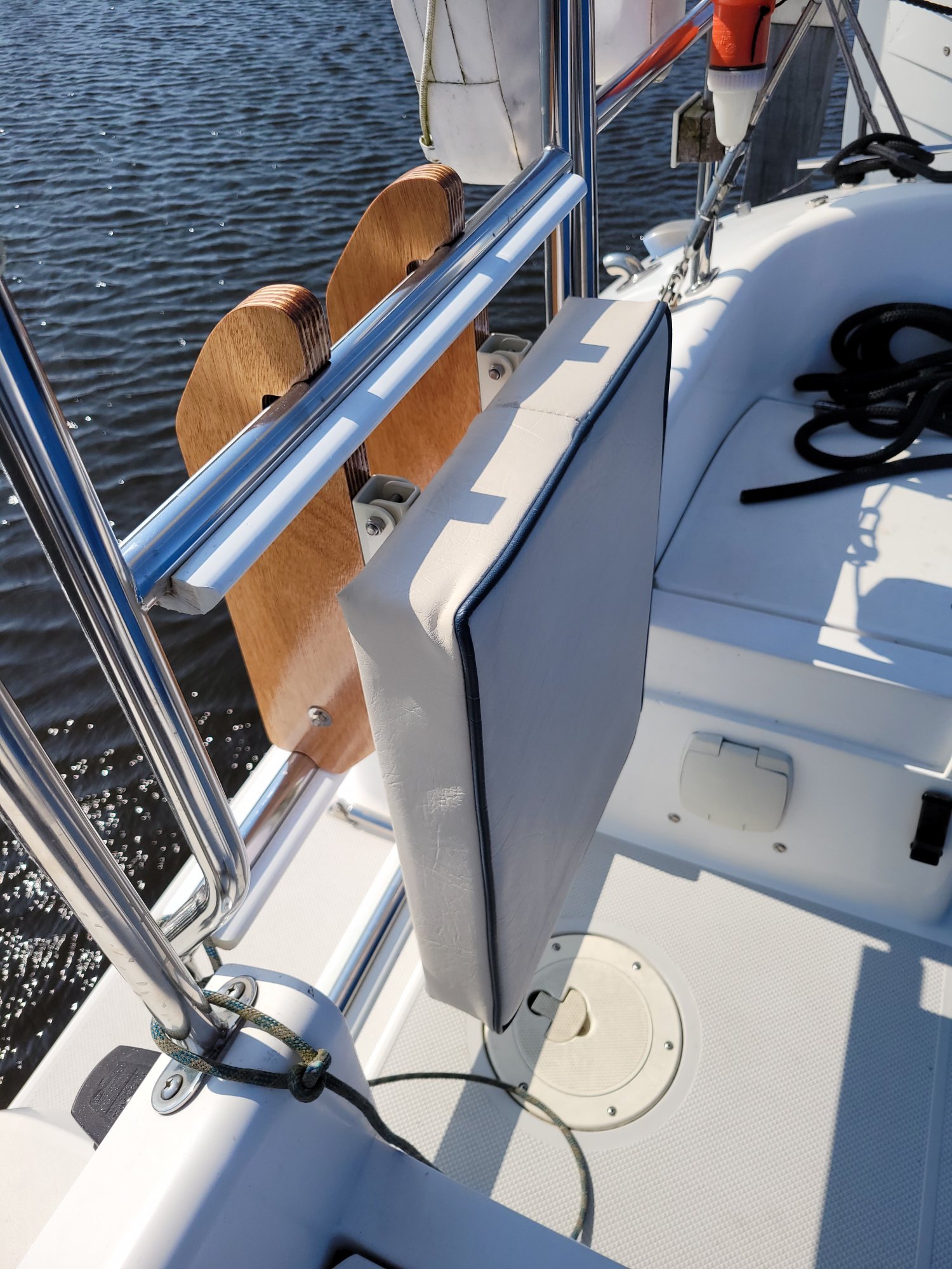

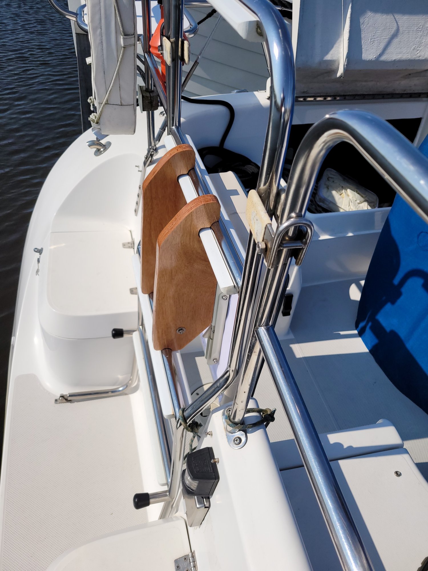

this winter i made this. A seat for while motoring of even sailing.
The idea was : easy to remove /place , same height as standing and last : folding down if i want out of the way.
It hooks in the swim ladder , when seat is up the cushion locks the whole seat.
and with the seat down you can slide it out of the ladder. No tools required.

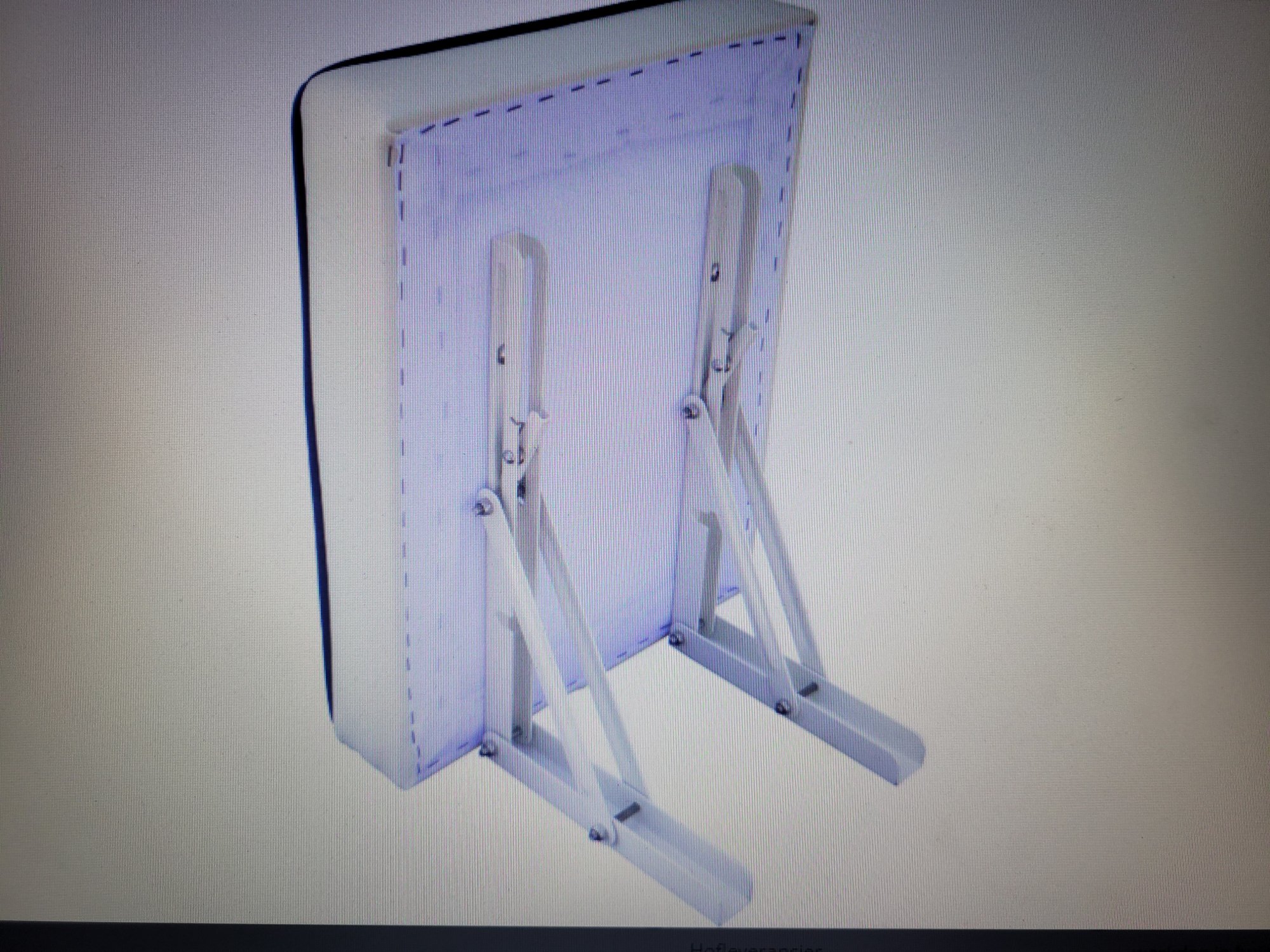

The seat is a standard boot folding seat.
