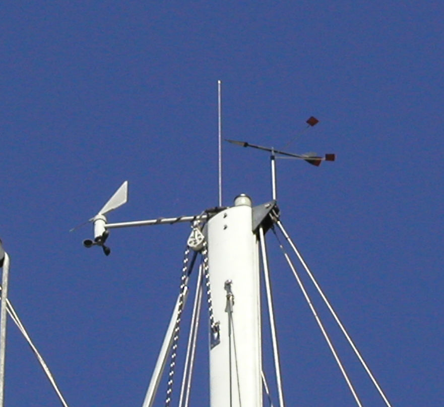

John (jssailem) has a very good point about possibly bringing the spinnaker down with the halyard over and above the headstay. On the 34, the spinnaker halyard is outside with the block on a bail on portside of the mast. Theoritically when you hoist the spinnaker its head and halyard is above the headstay. And it is that way but if you take it down on the starboard side, it then brings the halyard close to the headstay where it has a chance to get wrapped, as you have had happened. I always hoist with the spinnaker (and jib if I hoist from behind it) on the port side. Bringing it down on the port side makes it easier to avoid the wrapping. Once spinnaker is in the bag (or cabin), I swing both ends of the spinnaker halyard towards the stern around the mast top and back to the front around the shroud below the spreader and secure it near the base of the mast (See pix). BTW, the shackled end of my spare jib halyard gets the same treatment. This avoids the wrapping and avoids having the unused halyards in the way of headsail movement. Never noticed any serious chafing however when anchored with the wind fairly strong, I take both halyards away from the mast and shrouds to eliminate annoying rattling noise reverberated inside the mast.
