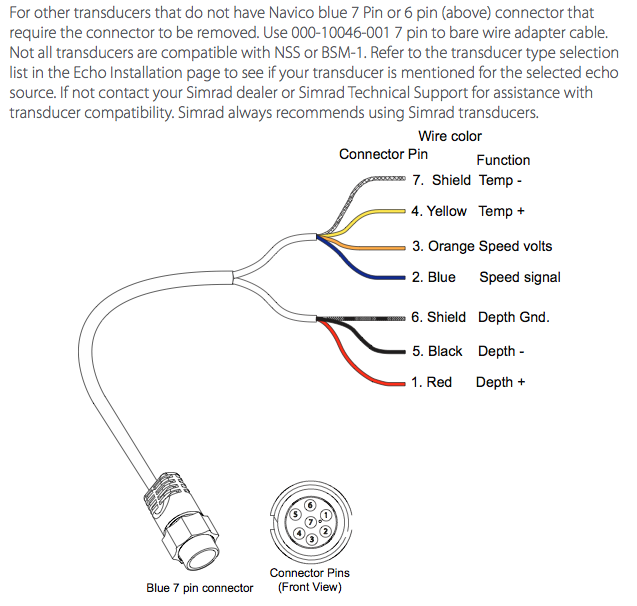

the NSS8 MFD install manual is shown in the third pic ... next question is - I've got two wires (shield and signal(?)) on the coax .. which leads do I connect them to?

it works
I split the coax and wired it to the NSS MFD plug ... works like a charm
