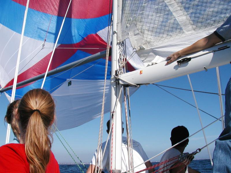

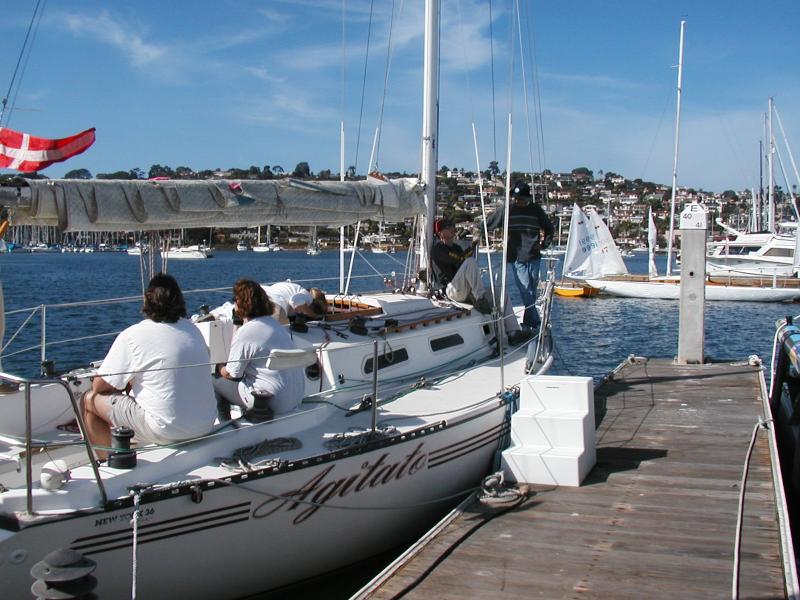

You must remove the rope luff from the track to properly flake the sail on the boom. It will not stack like a slug rigged main. In the pictures below you'll see the sail flaked nicely on the boom with the halyard attached to the headboard, ready to hoist. Notice the tack resting a few feet behind the boom.... the crew has allowed the sail to take a natural position. Also, notice the attempt to keep the creasing to a minimum by loosely tying the sail to the boom instead of cinching it tight.... very important. The sail cover will keep the sail in place, there is no need to hitch it tight like a saddle.
Also notice that there is a "prefeeder" on the mast track, about a foot above the boom. When hoisting the main, the crew starts the headboard through the prefeeder, which has little rollers that guide the sail into the groove withough jamming.
The second picture shows a close up of the prefeeder and how the tack is secured and cunningham rigged.
Your boat won't be this complicated, but you can see the theory of flaking the sail out of the groove.... even though there are no slugs... you would still start at the mast end to control the flakes.... if you're out in the water, a crew at the mast controlling sail and halyard, then another crew or the helmsman, in the cockpit handling the leech.
If youi're uncomfortable, leave the main up and wait till you're in the slip to drop it.... just leave the mainsheet loose so the boom will weather vane while your maneuvering under power. If you have a down wind slip.... find a quiet place in the marina where you can turn the boat head to wind without getting in anyone's way and do the best you can.
Good luck.
