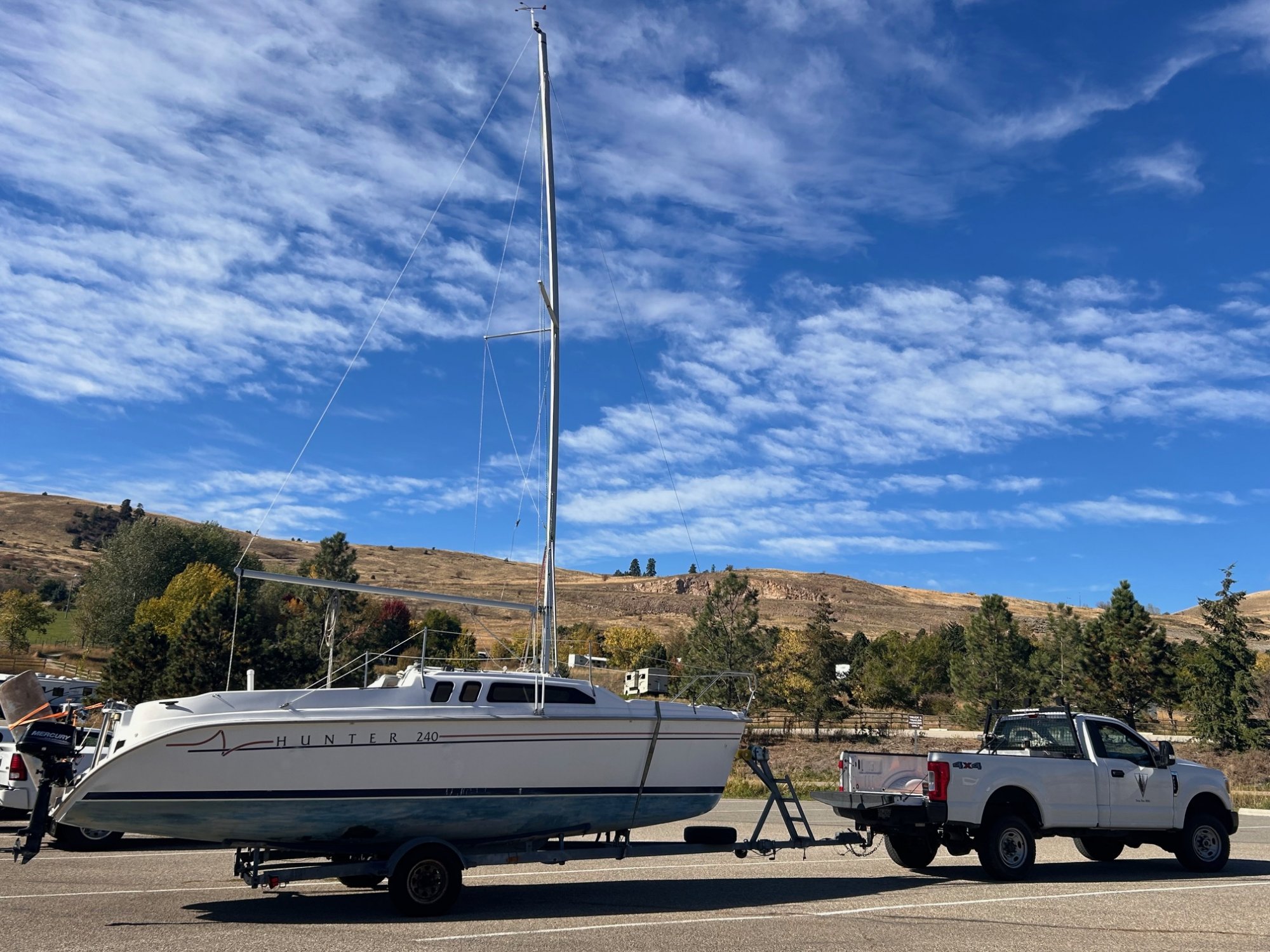

We took our Hunter 240 out for the first time. When we first bought the boat, it was on the water. The seller told us he has never had it on the trailer nor has he ever unstepped the Mast. Ok, away we go. Sails down, engine on we travelled roughly 1.5 hours to the nearest ramp. We did not fill the ballast tank. Fast forward, we’re on the trailer wondering how to put the mast down lol. With thanks to a downloaded manual, we used the front halyard to the lower the mast. (LOL)
Fast forward again, hull repair complete. We are now back on the trailer needing to step the mast. We attached the main sheets, pole and front halyard but quickly learned we cannot pull the front halyard to raise the mast. Realizing we unstepped it incorrectly. It didn’t take long to see how it actually works. Up goes the mast pulling on the sheets. Impressive setup. Much smoother operation than stepping the mast on our Mac25.
Once the mast was vertical, the forestay was roughly 12 to 14 inches away from attaching. I thought to myself, there is no way I can pull this down. Furthermore, I thought there is no way I would want to put that much pressure on it if I could pull it down. I loosened the turnbuckle significantly until I was able to put enough pressure on the forestay to attach it. It was still a lot of pressure. I had to place my foot on the pole and push it down closer to the deck to attach it. I have not gained any experience wrt rake in the mast. I’m pretty sure I increased the amount of rake lol.
Question: After doing some reading on the B&R rig, I will have to step the mast again and then use the main halyard to measure the mast rake etc. I’m not fully understanding how much tension/distance is required to put on the forestay? If it lets go, yikes............
I’d sure appreciate some advice.

Im not understanding how the forestay came off okay, but is so short when going back on? One common issue when raising the mast is the side stays can bind where the turnbuckles attach to the chain plates. This happens just as the slack is starting to be taken out of the side stays. Its very easy to bend the turnbuckles if you force it. The measured length of the forestay should be from the attachment point at both ends, ideally with the turnbuckle in a mid-position. Also, you can get extensions for the forestay that are similar to a headboard shackle. Im not sure of the proper name. But again, not sure how the forestay shrank from when it was removed.
Did you loosen the side stays before you brought the mast down? You need to do that. Otherwise it would be very tight going back up. I think I used to loosen about 5 turns each. I would loosen the stays, then put a piece of tape on the turnbuckle with the number of turns loosened written on the tape. Save a bit of rig tuning next time the mast goes up.
As far as pulling the mast too far forward, it shouldn't come to much further forward after the mast foot is flat on the deck. In other words, the mast should not be stressed forward of vertical.

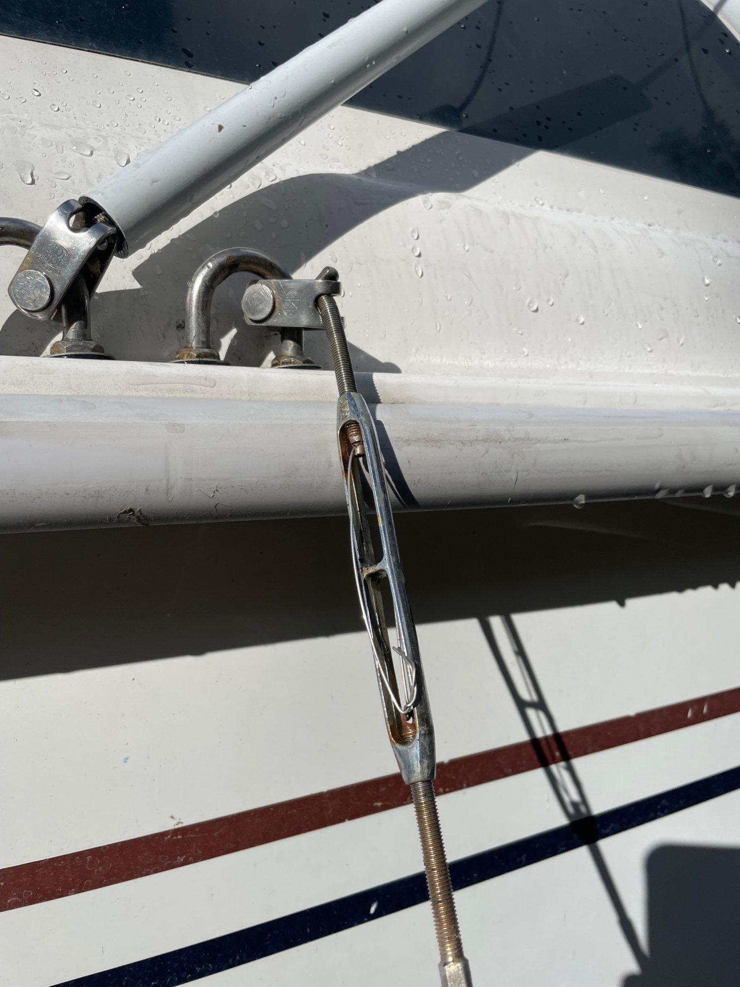

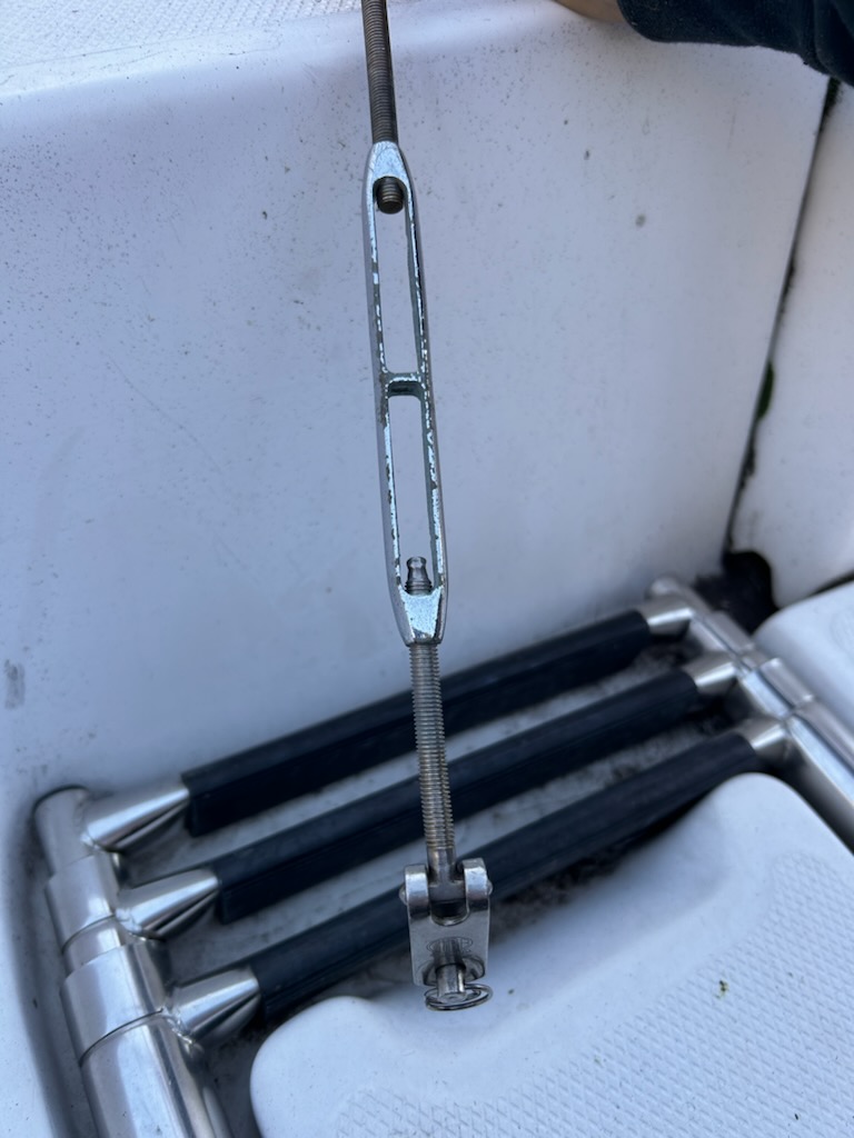

The reason for picture of the shroud turnbuckles was to determine if the studs had been screwed all the way into the turnbuckle body and to determine the studs were straight or bent. For the record the mast raise system was designed by me @SteveHughessails

Well all I can say is a father and son team with no idea was successful in unstepping the mast :) We did not loosen anything but the forestay. My guess, we were running on pure excitement. I put pressure on the main sheet, my son would have disconnected the pin, he’s a machine, and then we used the rope clutch on the jib halyard to bring it all the way down. We were so excited lol, we did it. Then the repairs.... then the first time stepping. I think we’re doing ok. :) we did get on the water with the mast up. Hooking the forestay up with the wife, I felt was too tight. It was. Stepping the mast, I used the Jib Halyard to get the lifting pole up high, long sheet, and used the sheet to lift it and lower it.
Stepping it was a treat compared to our MacGregor 25. There was no sway, no movement on the Hunter mast at all. Very nice. I looked yesterday, I can see one of the threaded rods on the side stay is definitely bent but I don’t see any turnbuckles other than the forestay. Sunny skies today with little rain. I’m going to give it a shot by myself. I will post pictures.

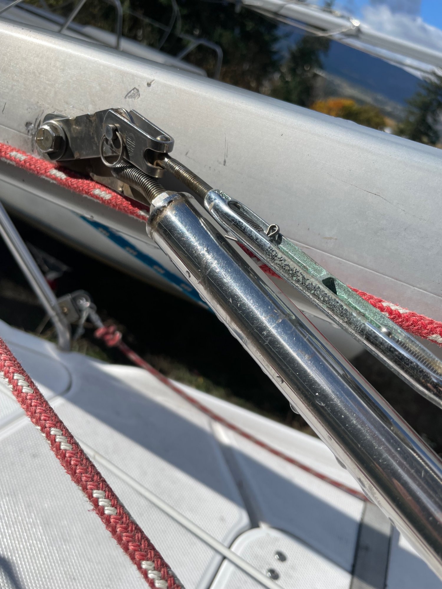

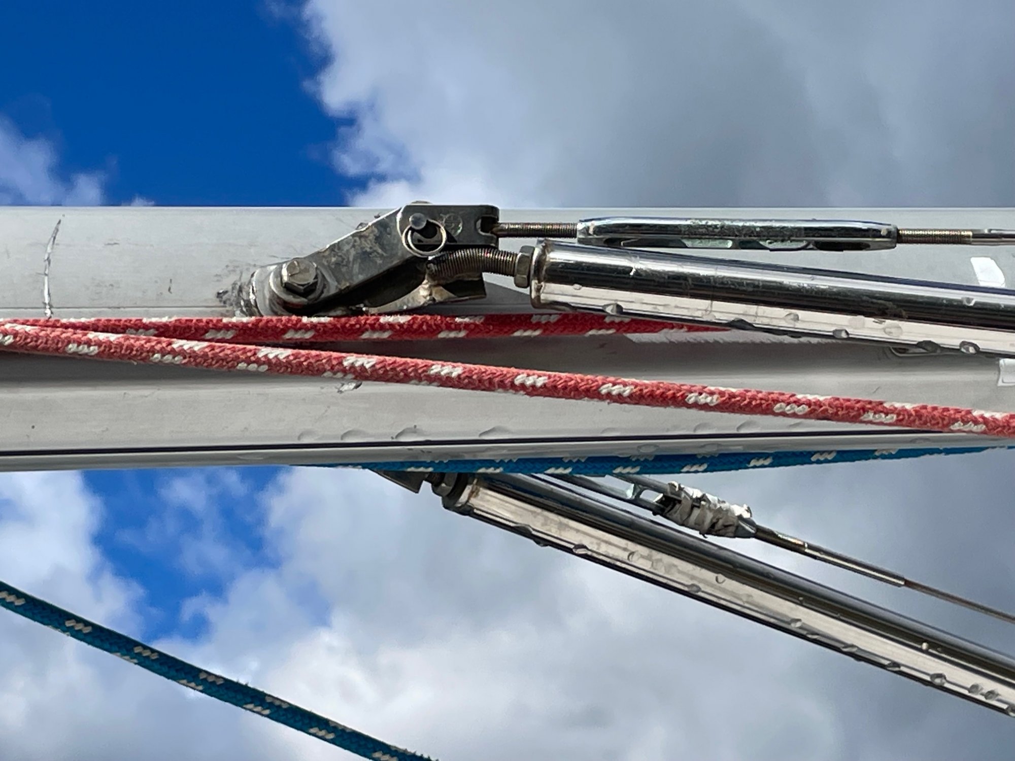

I managed to get intimate with my setup today. I didn't realize the side shrouds/forestay etc. just loop inside the edge of the mast; I like that. I pulled the protecting covers up off the side shrouds. Turnbuckles have a fare amount of adjusting space left to tighten but not so much to loosen. They are wired locked, both sides. They each have a gentle bend to them for sure too. I can see now how loosening the side shrouds would allow the mast to travel further forward taking some of the pressure off the forestay.
We are definitely dealing with my user error/unknowns here. Shorter forestay can be apparently for sailing in heavier winds......
The lower support bars threaded rod, is quite bent?
Last picture is with the mast raised from last week. Apparently that's the normal pre-bend (not rake, lol).
