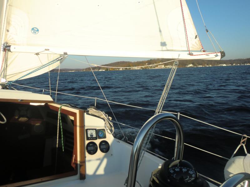

That's what you have. To sort your terminology out correctly, your foot is the entire length of the bottom of the sail. Your foot is attached at the tack with a pin (where the boom meets the mast with a gooseneck) and at the clew, with a slug, which can more easily slide within the sail track of the boom.
Sailmakers should ask if you want a loose-footed main or a bolt rope for the more traditional way of attaching foot to boom. Maybe they did but you didn't understand the question. :confused:
Anyway, I prefered the loose-footed main as you can see in the photo. I like it because I can see the shape more readily when adjusting outhaul, which I like to do. The traditional sail with a bolt rope tends to develop a shelf at the foot of the main which I think affects the sail shape and makes outhaul adjustment more difficult when the bolt rope tends to snag in the track or slide less easily.
You did good, now just wait for Spring!
