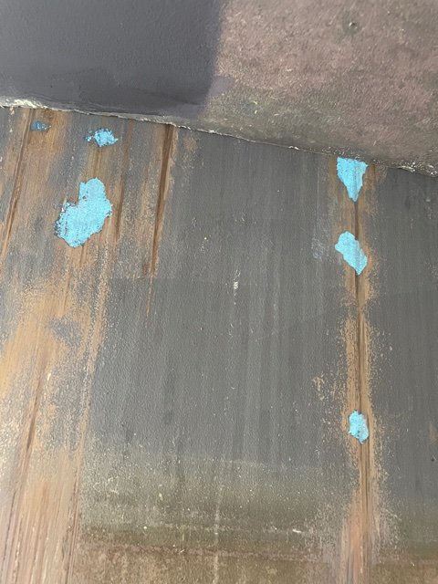

Hey, thanks for the reply. I've done some further investigating and confirmed is is not fully deploying - about a foot short. I used an endoscope camera was able to get some good footage of the interior of the trunk. I presumed there was some kind of build-up or crud that was obstructing the keel. Turns out the interior of the trunk is clean. Then I put it on a lift and tried lowering it only to discover that it rubs hard on the port side and jams. The keel has about 4-5 layers of paint and there's an equal number of layers on the lower inside foot of the trunk. The guides are also up hard against the inside of the trunk. We are planning to pull it out of the top, look for any deformation/swelling that may have occurred and then strip the paint and sand down the guides. Hoping it drops in aft that.

JDE,
When you pull the keel out will you please take a whole bunch of photos showing what the keel and the inside of the trunk look like?
