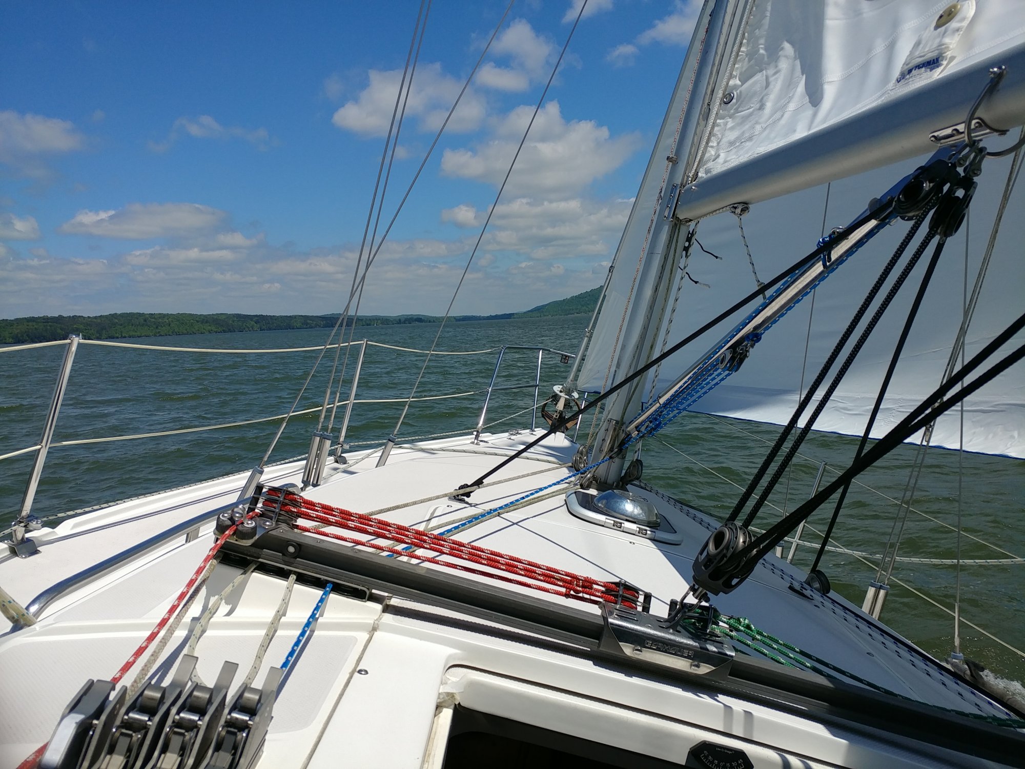

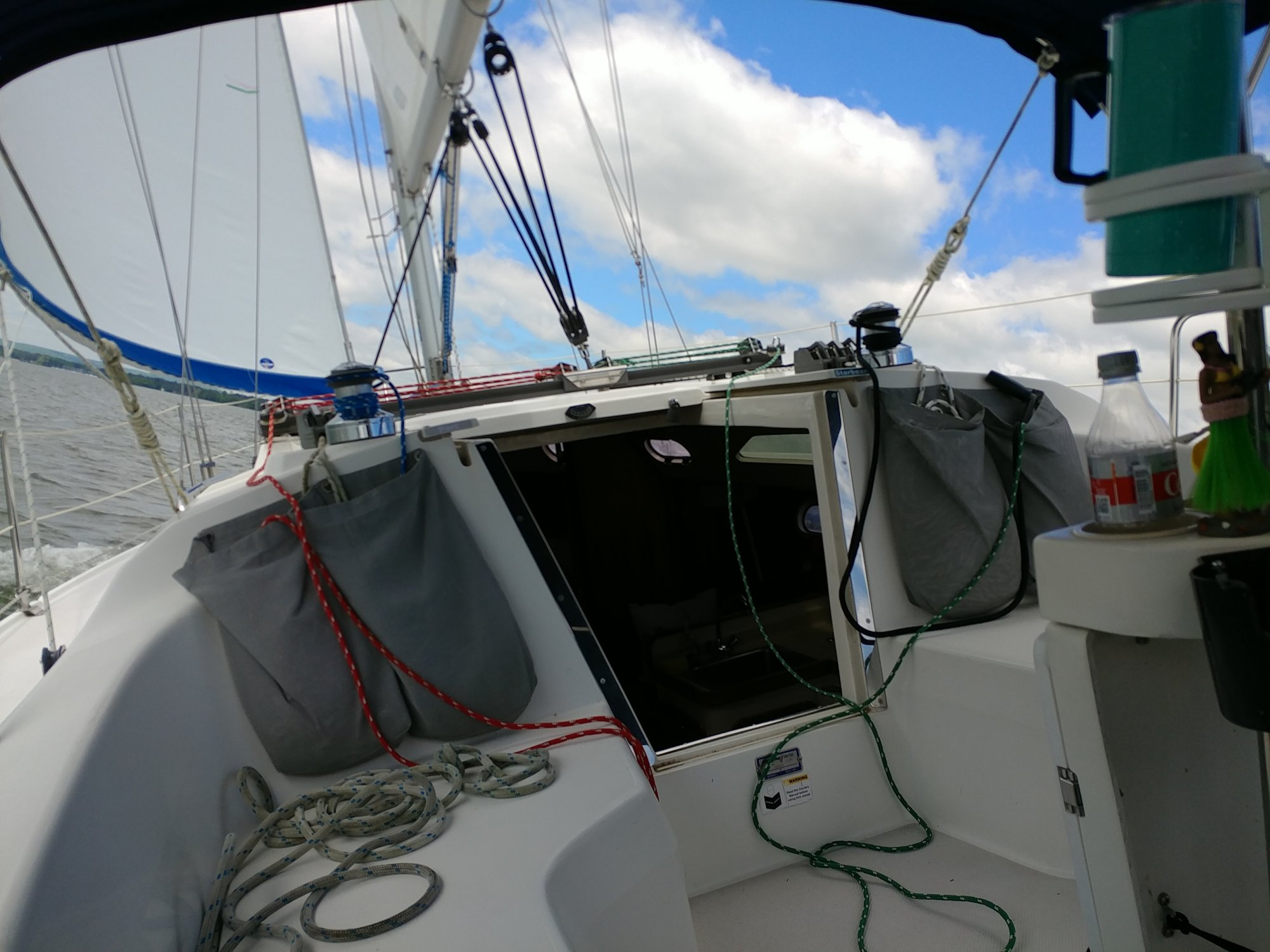

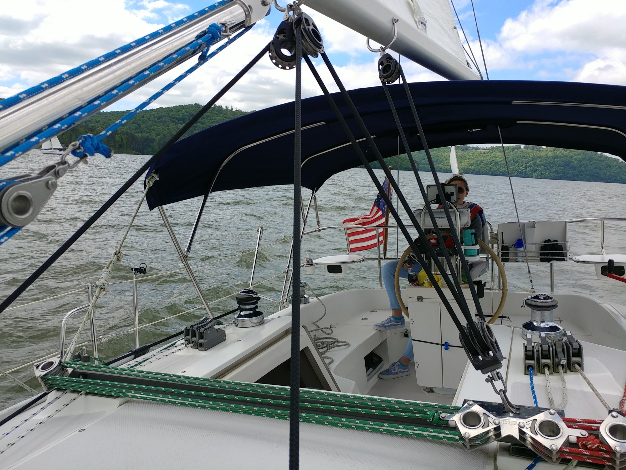

I like SBO estimates being too long is fine and I've order several lines from them. You can also find name brand lines on Amazon too, many times they are set lengths, so again having extra is always better. I color coded my lines, port side traveler is solid red, starboard is solid green. Solid blue for Vang, black for main sheet, jib halyard white with red chaser since it runs port, main halyard is white with green tracer since it is starboard, spin halyard is white with blue tracer. I still need to replace outhaul and topping lift, and main reefing, I have those lines on the boat but haven't replaced them and forgot my color scheme lol.
