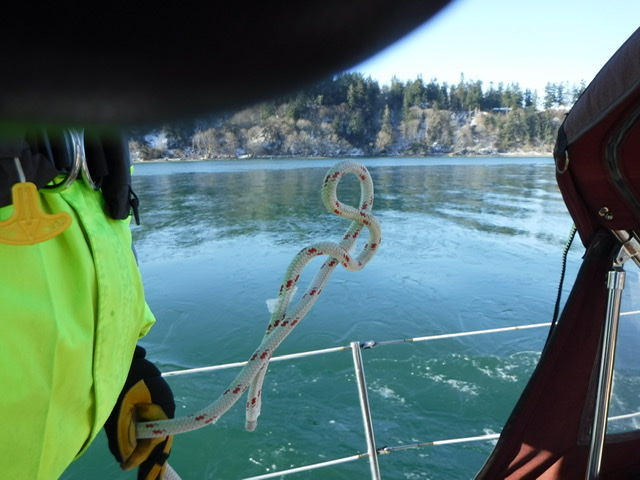

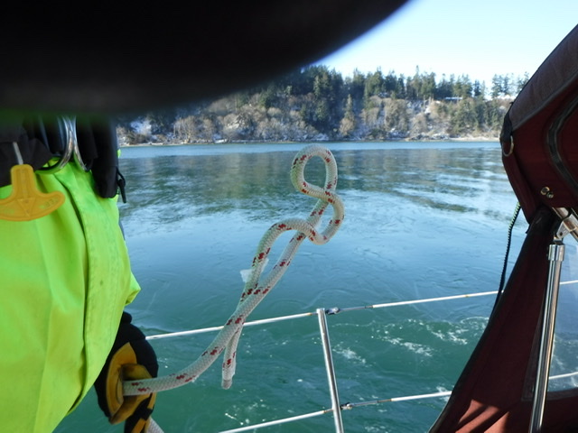

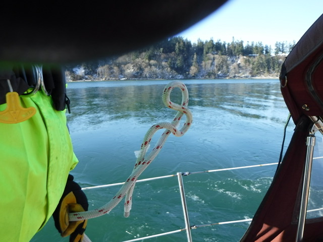

Lines can transition over time in funny ways.
This is dependent on how they are used, stored, or left to weather.
Here is a jib sheet on day 3 of our 2019 sailing adventure... useless.
The polyester double braid lines are two parts. A center core of strands and an outer sheath. The line maybe of all the same material or the core and sheath may be of different materials, depends on how the line is to be used.
Put the line in a clutch under strain, repeatedly stopping it at the same place and you will breakdown the inner core. Ignore this and you will see the line get smaller. That is until most of the inner fibers are broken and due to lack of strength (like an atrophied muscle) the line just fails.
Maybe you let the anchor rode ride on the bow roller. You swing back and forth, back and forth... all night. You wake to find that your boat has drifted into the mudflats, the tide is falling and the pretty 3strand 3/8 nylon line you got from Home Depot is a ball of fuzzy tatters having chaffed til it broke.
We rig our lines and then leave them to the elements. They swell with water, dirt gets beneath the outer sheath and into the fiber core, they get doused with harsh chemicals, or sun bleached with Solar UV and suntan oils and then we place our lives in their strands to hold our sails and drive our boats as fast as possible.
Is it any wonder they sometimes rebel or give up the ghost?
Be kind to your running rigging. Cheerfully replace it occasionally. Take it off the boat and give it a spa treatment once and a while. Who among us doesn’t enjoy a soak in warm mild soapy water, then a vigorous rinse.
Take care of your lines and they will repay you with good safe years of sailing fun.

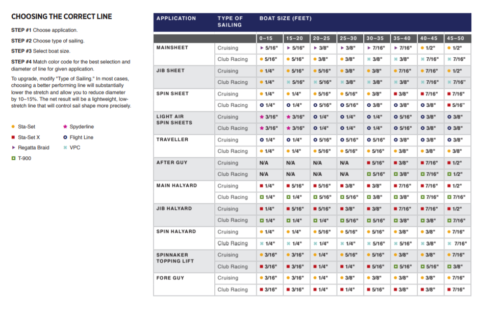

Ditto rgranger .........3/8" Sta-Set are acceptable. That is what I had on my Hunter 31 and Hunter 386 except I used lower stretch rope for the halyards and topping lift (which doubles as a safety line while climbing the mast). Below is a New England selection guide for your future reference.
Jon, I call that photo "Fake news click bait" becasue I remember WHEN you took that photo. ;):biggrin:
Judging from what looks like snow on the hillside in the background, and a bit of skim ice on the water surface, I wonder if temperature had an effect on that line.

24,938
Of Course. We posted it during out 2019 Extreme Adventure Cruise. I think the event demonstrates the need to care for your lines. The line was wet. We were remiss caring for our lines. With the temps in the teens over night we should have brought the wet lines into the boat. Taking care of the lines might have let us use the sails rather than motor.
It did have kind of a Salvador Dali - Surrealism artsy shape.
