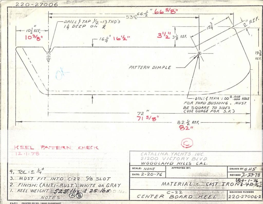

So this got me thinking, with all the DIY expertise we have as a group; Why can't we come up with a better solution that replaces most of the high cost with sweat equity?
So looking at the original factory drawing got steam coming out of my ears. I could use 10 gauge cold rolled steel (or even stainless if I want to go bat sh!t crazy) and plasma cut all the shapes I need to do a skin over rib style frame, like an aircraft wing. I would weld in the stainless keel pin bushing as well as 1/2" 13 TPI stainless threaded bung for the cable eye bolt. The profile would be accomplished by rolling the steel skin through a roller to give it a light curve and clamping it down over the rib frame to tack weld, then essentially there would be one weld bead all the way round the edges. The lowest part of the keel would essentially have internal compartments that could be filled with lead and plugged off. Then, just clean up with coarse sanding and paint with Interprotect 2000, light fairing as needed.
I'd need feedback and some help from the group. I don't have a factory drawing which details a profile view of the foil. All I have is my own keel, lol! I'm not too savy with computer drawing tools, maybe someone here is? I think if we put our heads together we can figure this out, keep costs to a minimum, and do a kick ass job!
To get the juices flowing here is the factory keel drawing;

Luke, I did buy the video from catalina direct to watch how to referb my keel and in the packet was a template for the correct foil shape. is that what you are looking for? I did check my keel once it was stripped and down to bare metal, the shape was just about spot on for my keel.

Anyway, just using my artistic background I could get pretty close drawing out the foil profile with measurements taken off my own keel and cutting out with jigs using my plasma cutter. But if someone has a knack with any CAD software that will save in .dwg format I could cut out all the pieces on the CNC making this a relatively easy process. The fab hours would be reduced by more than 60%.

I wish I could get my hands on drawings for that wing keel conversion, I bet I could pull it off. I imagine it would be possible to add additional weldments (the same as the 5/16 bolts for the keel hangers) than would allow it to be a bolt in piece, and be able to switch back to the swing keel.

One of the drawings for the C-22 and C-25 wing keel retrofit kit.
