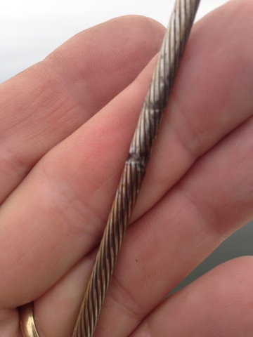

Part of my spring prep for my first full season with my 1980 O'day 25 was to install new standing rigging. The old rear stay had a couple of neat SS spring clips clipped to it so I used them on the new stay to fly my O'day pennant.
Well, that was a mistake! Not sure what went wrong, if the clips were too tight or the new wire weaker than the 1980 wire? Were they meant for dedicated lines to fly a pennant?
Scary!
Will be installing a new stay again this spring.

Ouch... that sucks. I definitely wouldn't use the clips again... I have one of these Johnson flag halyard rigs on my backstay for my ensign. It's fixed mount... i.e. mini U bolt with small block for the halyard and shroud cleat. I think your clips rotating around the stay with the flying flag is the problem. The clips were designed to attach to a halyard, rather than to a static wire.

Is the nick from abrasion or erosion? I guess a question I have is did you get some sort of electrolysis reaction between the two metals or did the flying flag just make the crimp rub and rub all summer long?
10,253
Looks like "fretting" damage from stainless on stainless.. without a microscope, it is hard to say exactly but that is my best guess.. I wouldn't put anything on that stay that is not static. The little back and forth movements of the clip is what wipes the protective coating off the stainless .. almost anything that flutters on the stay will do that..
