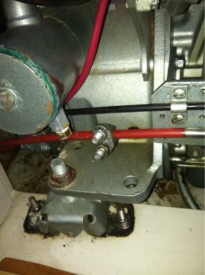

I did notice that there is a u-bolt attached to the cable about 1ft from the point where the cable attaches to the throttle on the engine. Based on a c34 thread, it appears that it's used to adjust tension on the cable. There was a link to photos for throttle adjustment there but the host site is no longer in existence. I didn't want to mess with it though, until I knew what it was for, since the engine was running fine!
Here's the bolt:
Here's the bolt:
Yep, that is where it is done, at the engine.

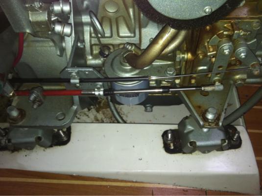

Visible in the second picture are the threads on the end of the rod by which the end fitting can be adjusted. It may be adjusted so the lever does not hit the pedestal guard when shifting to forward. Newer boats use the closed end fitting shown so the amount of adjustment is limited. On the pedestal end of the cable is a brass fork with a clevis pin which also provides some adjustment room. Also under the compass, bolts on each lever axle adjust the tension on the levers so your thottle doesn't creep down on you.
