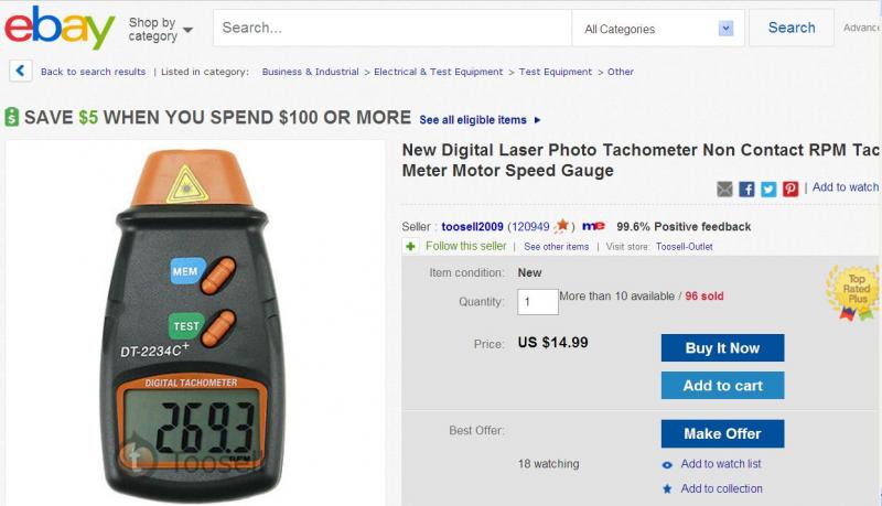

Are there any suggestions of how I can test the tach for accuracy?
Hand held optical tachs are cheap enough that you could get a few of them and take an average. I would think you should get a reasonable figure (+/- 5% error at worst) with one of these. It's a start to see what you're dealing with between the engine and the mounted tach.
