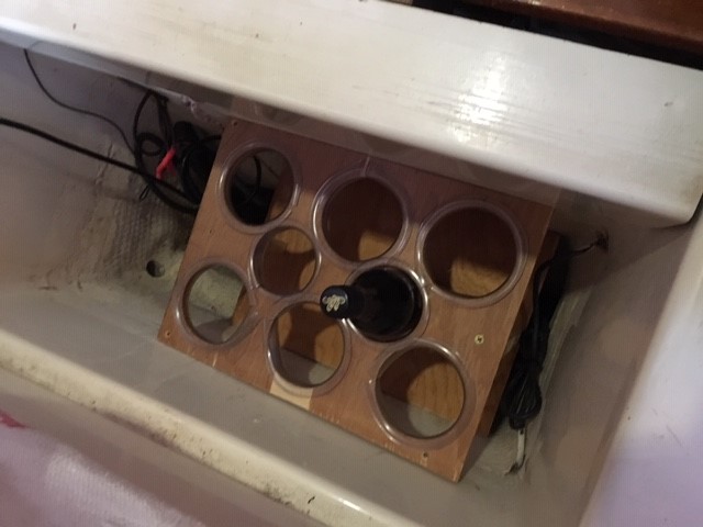

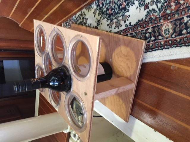

There is so little storage space on my 1991 P42, so I have always been looking at ways to create some new storage. Hoping to finally start doing some cruising and longer passages so came up with the idea of using the unused space in the main cabin bilge under the center removable floor panel. I used some old plywood to test the concept and will now go and source some nice marine ply and do it all again after proof of concept. I cut the bottom with a width that would position it about 10>12 inches above the very bottom of the bilge., so about 6" above the top of the bilge pump. The top panel was cut wider ( the bilge tapers down toward s bottom) so it jammed about 6" above the bottom panel- i then placed a 6" piece of 2x1 at the center of each end to secure top and bottom panels together for ease of handling. I then slit some 1/2" plastic tube to run around the circumference of each hole basically to spot any rattling type noise. This model holds 8 bottles of wine in a very stable temperature "cellar". It easy and ready access top wine when needed and is easily and quickly removed when needed. I will also post this in owner mods under P42.
If anyone is interested I can add a drawing with dimensions if needed.

I'd caution you to make sure you pad the bottles so they can't bang around. Aside from the lost wine, you don't want the glass in the bilge pumps/strainers/lines or bilge.

SG- look again at the pics- the bottles cant move once in the rack- slitting the plastic hose so it pushed over the cut edge of the ply took up the small gap with bottle.

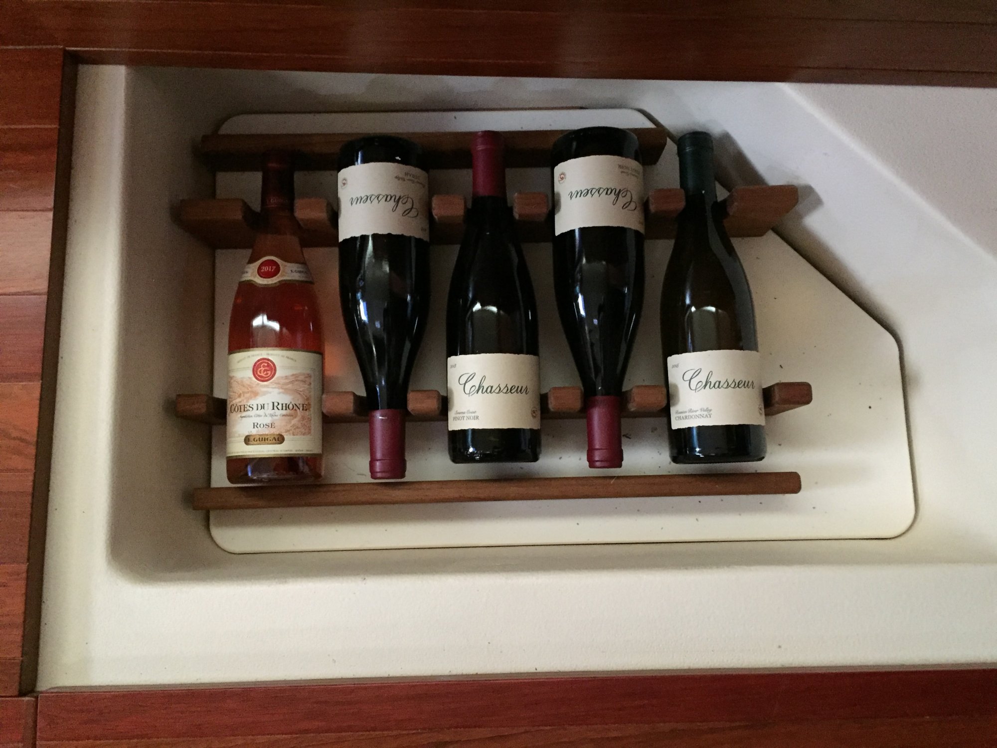

During early discussions with Marlow Hunter about buying a new MH40, I made a comment about liking an under floor boards wine rack that they had included on another model MH boat that we had looked at. When we took delivery of the new boat almost a year later, I discovered the same wine rack under one of the floor boards. They had remembered my comment and included the wine rack at no additional charge. The whole rack can be lifted out and there is still some storage underneath.

Mine was the first MH40 to have this. They designed it at my request, then didn’t charge me for it because they said David Marlow thought it should be in their boats going forward.
