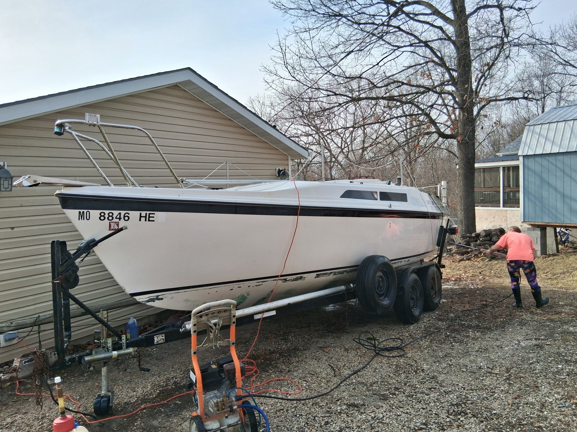

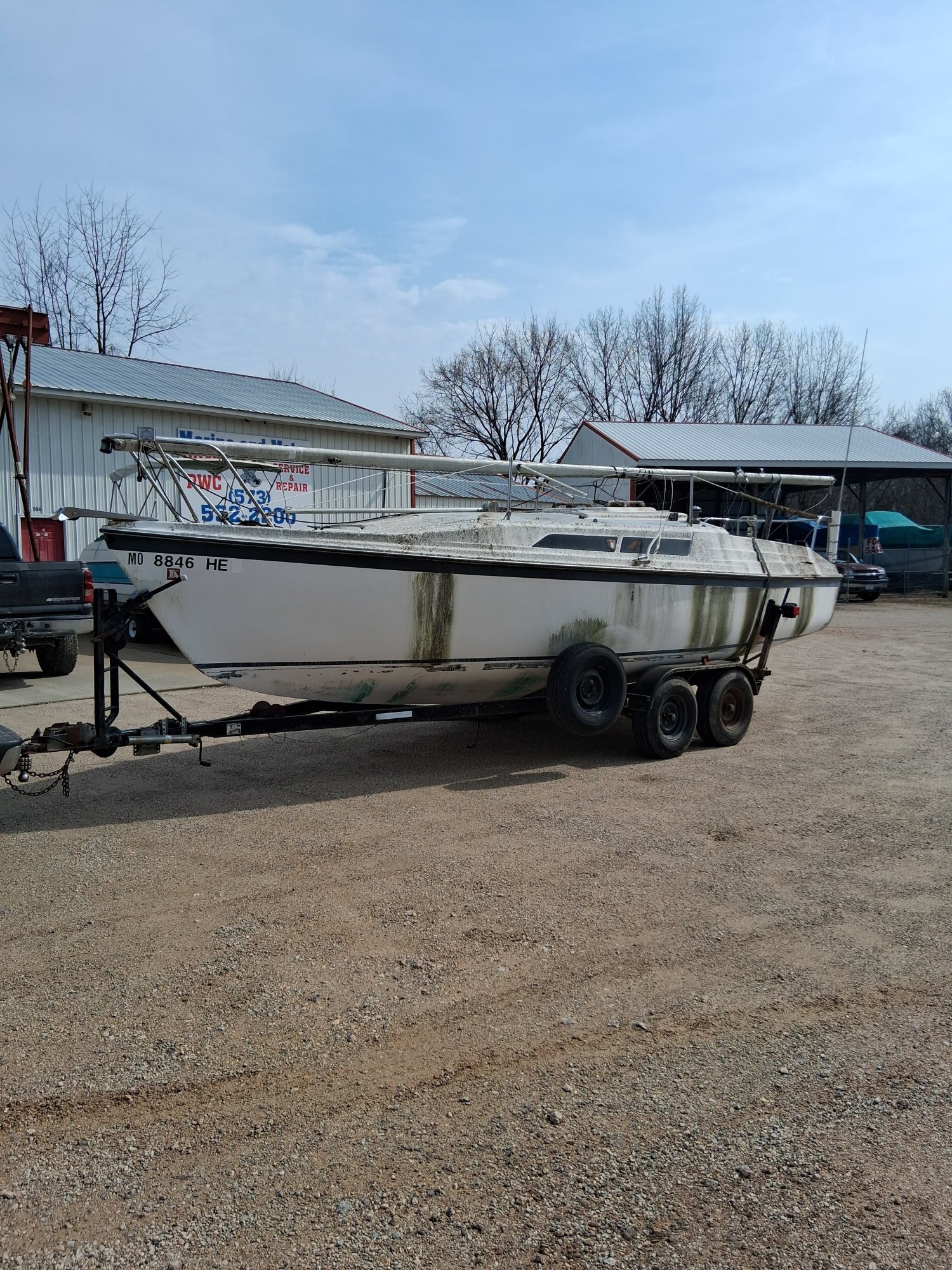

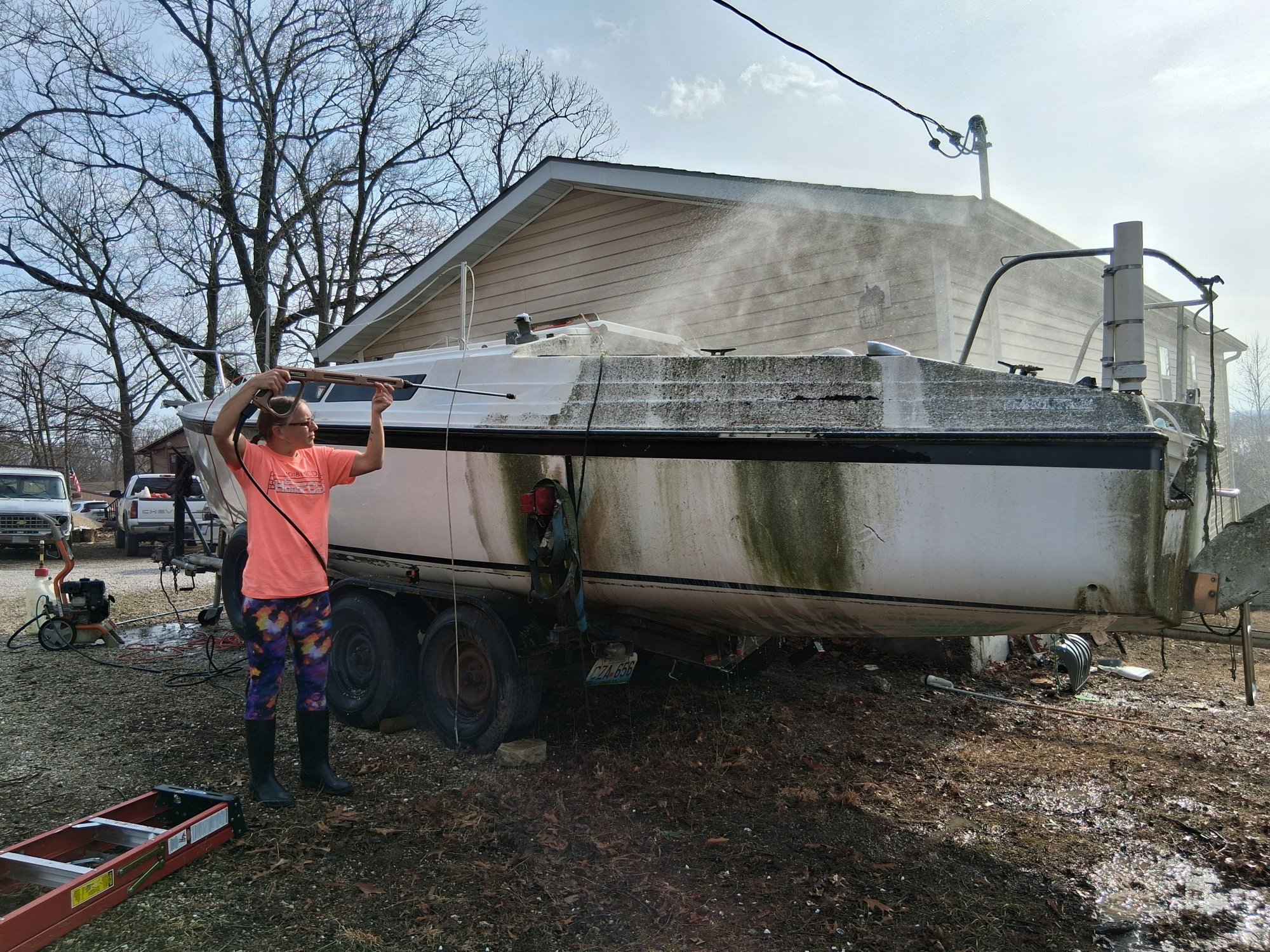

Picked up a free Macgregor 26s yesterday. Been in a yard for 15 years or so. Cleaning up pretty nice so far! It's going to need a little deck work at the mast step, and it's missing the tiller and tiller head. Otherwise seems to be all there.
Has some nice upgrades. Self tailing winches, harken traveler, all lines ran after.
I am curious to see how it sails. I think the is sailboat number 9? I have 4 right now. First mac and first water ballast boat.

Is that a Spartan brand trailer? If so, beware that the metal tubing they used is rather thin. They did some strange stuff. Overall, not a great trailer but it worked. Mine was from '73. I ended up replacing one of the beams that supported the leaf spring in a 20 hour straight marathon

Not sure on the trailer brand. It seems pretty heavy duty for an 1700lb boat

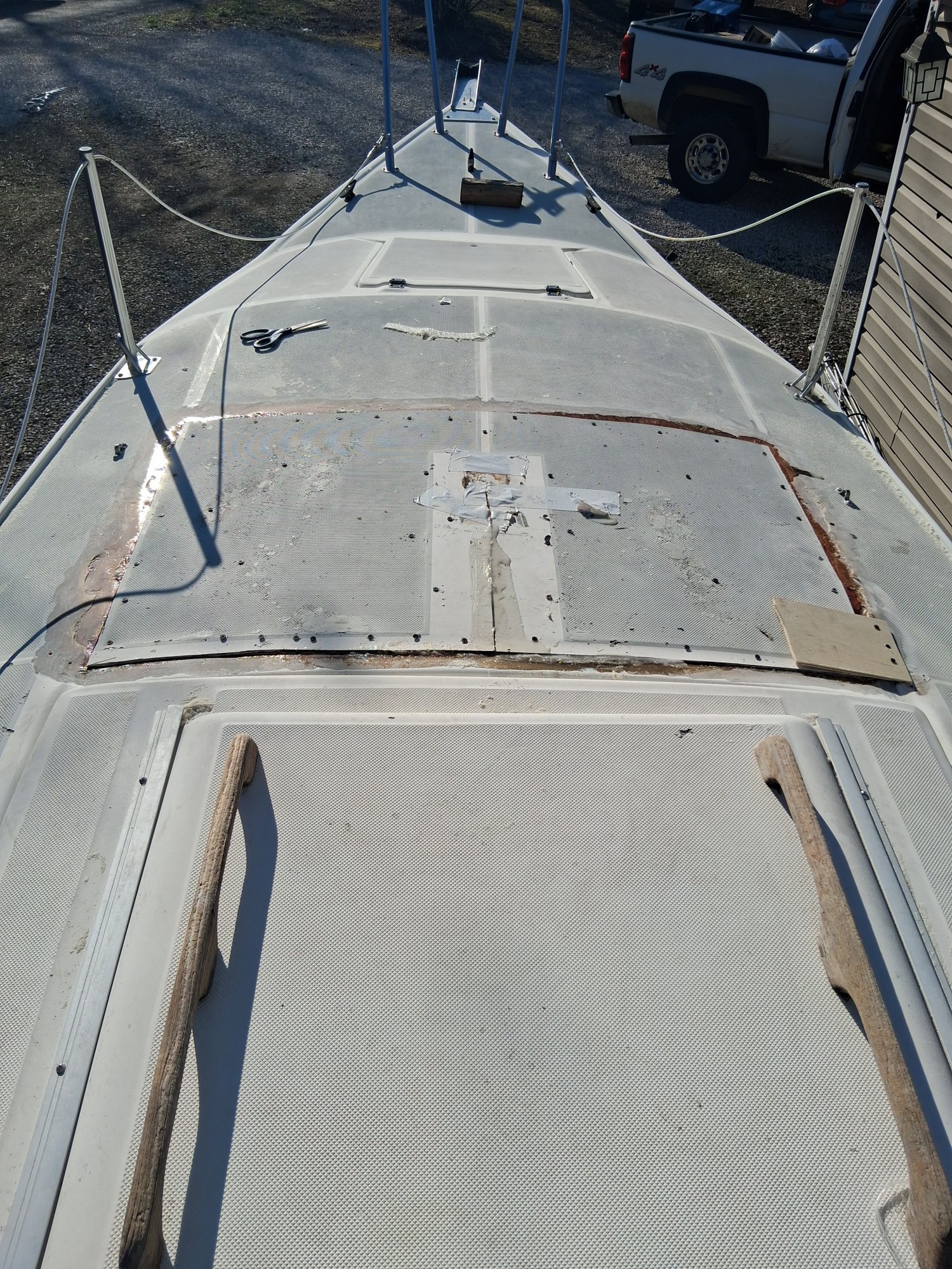

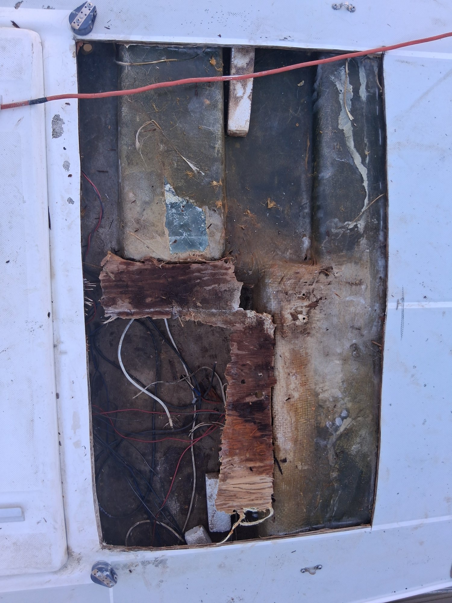

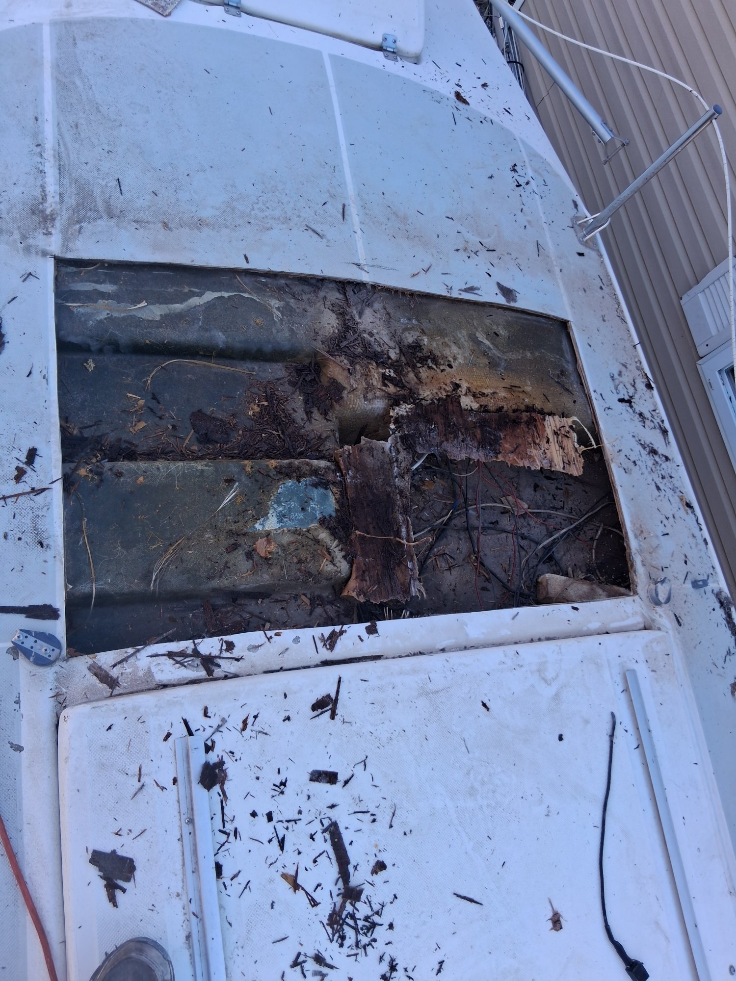

I'm digging into that in the next couple days. Deck is definitely compromised, but we will see how bad.
Good luck! Hope it’s just the deck but most boats have a bulkhead structure which supports the mast base compression. The deck is generally the least significant concern.

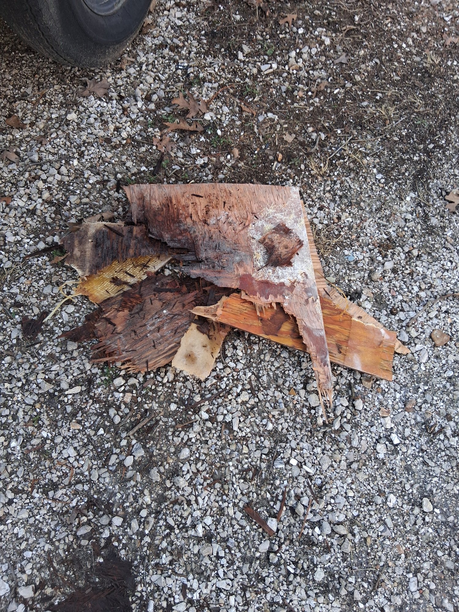

The deck is just a skin of glass, 3/8 plywood, then the liner. There is a compression post that goes down to a fairly a stout fiberglass cabinet that's part of the hull liner. It's not a very impressively built boat...

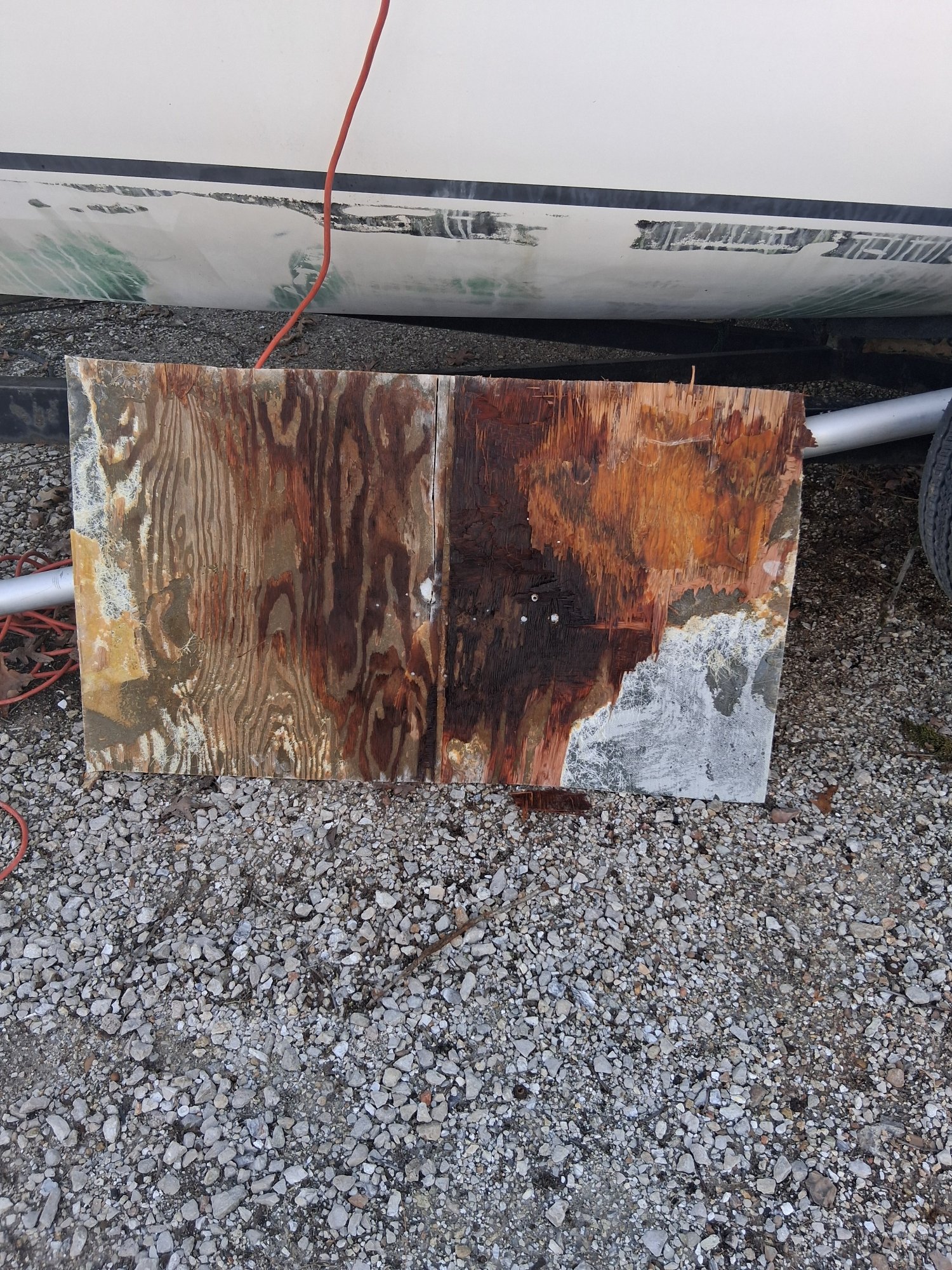

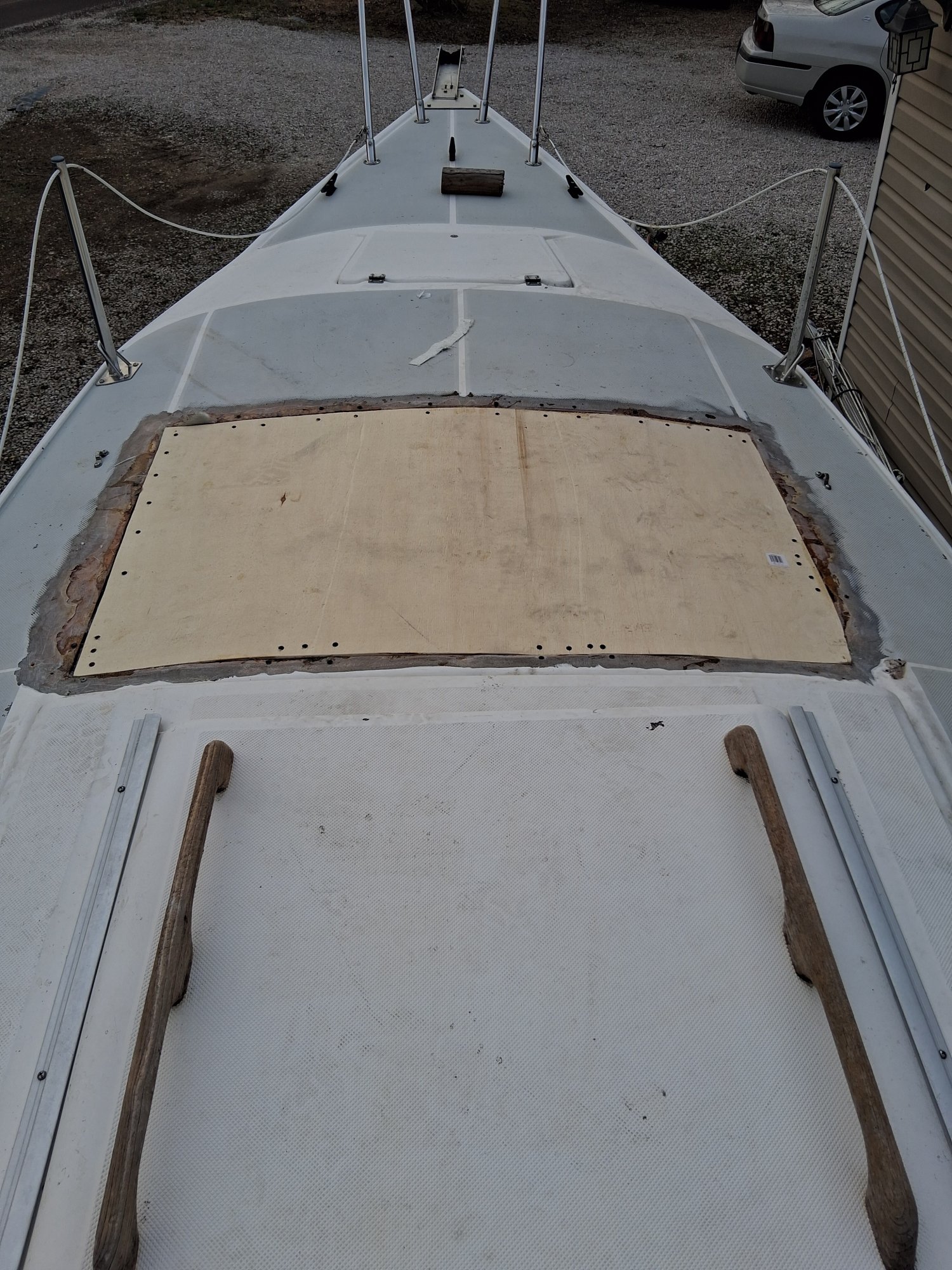

Catalina, Hunter C25 3559 Rocky Mount
Nothing but a thin skin of glass and soggy 1/4 plywood. She's cut out, new wood cut and edges ground down. Hopefully I get the new wood fitted and tabbed in this evening.
I'd like to try and have it back together by then weekend.
