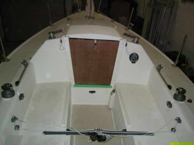

22
Catalina Capri-22 Ottawa, Ontario
Why not simply move the traveller forward in the cockpit? One of the previous owners of my old CP22 had moved the traveller forward about 10-12 inches. Still enough room in front of the traveller for 2 people to sit comfortably and tons of room for the driver behind it, especially with the "no one but the driver sits behind the traveller" rule. Also helps to get the weight forward in the boat and help get the stern end out of the water. Forward traveller also meant that the winches are easily within reach for singlehanded sailing.
Here is an old photo showing the original Fico traveller before it was replaced with a Harken windward traveller. In hindsight, the windward sheeting car system didn't work very well on the boat and would have been better replaced with a J22 style cleating system that was recently discussed. viewtopic.php?f=7&t=328
