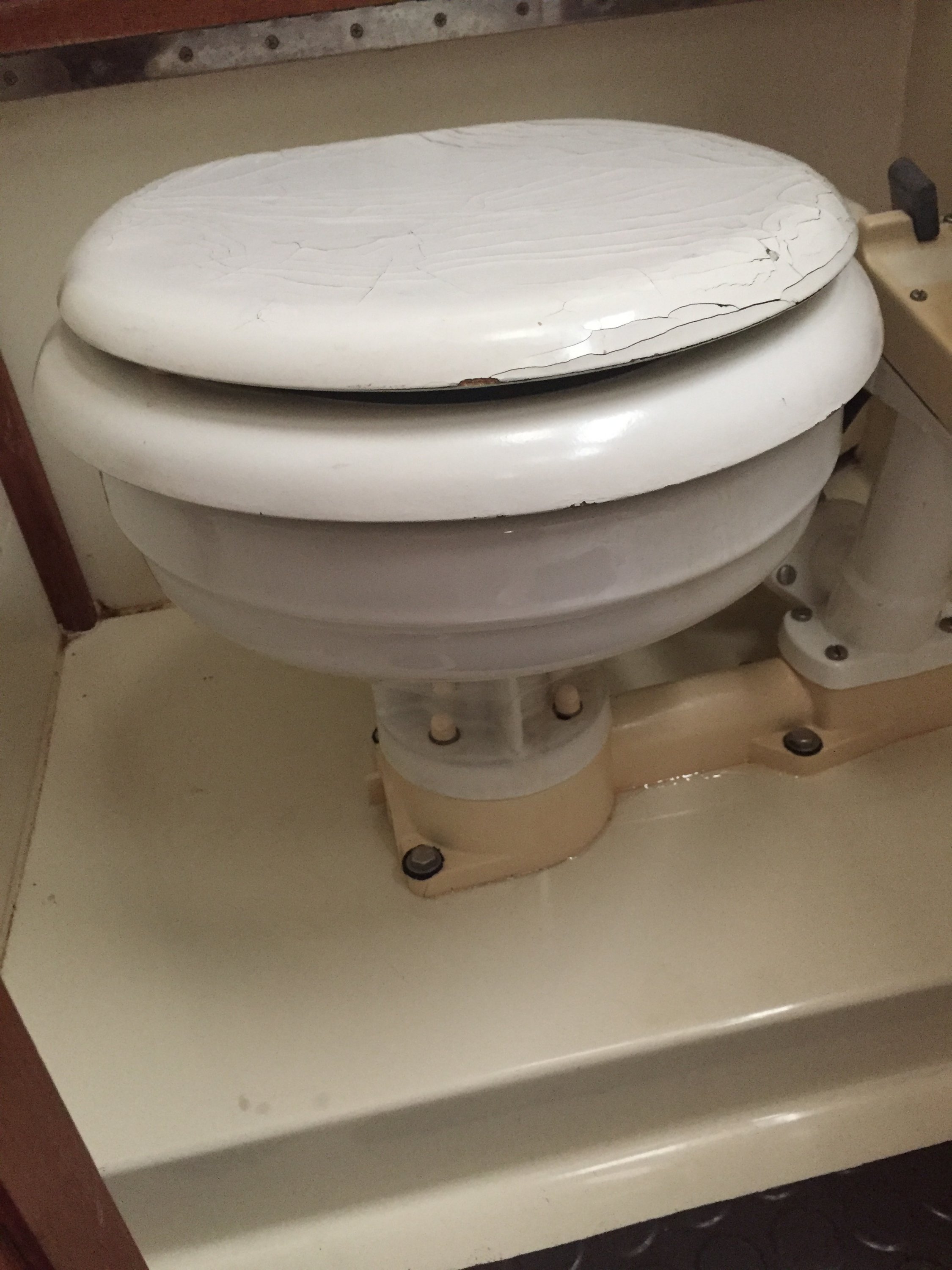

Hunter 30T 1992, I have ordered a new Jabesco manual toilet. The bolt pattern appears identical but are there nuts that have to be reached below? I see now way to get under the floor without tearing up a lot!

All marine toilets are mounted using lag bolts...no nuts to remove, just back out the bolts.
Even though the mounting bolt patterns are identical, it still would be a good idea to fill the holes and re-drill 'em...'cuz the new bolts are made in China where attention to the smallest detail can be unreliable, and even the slightest variable in bolt diameter vs the size of the hole can leave you with a wobbly toilet.
I'll be glad to help you through your sanitation system learning curve, so please feel free to ask "should I do this?" instead of "is that what I should have done?" cuz it's always easier and cheaper to do anything right the first time than it is to do it over.

Firstly, you are right they are bolts and can be removed but if you have any doubts then clean them up and reuse them for the new toilet and that way you will not have any issues with the size of the holes - so mark where each bolt comes from, and then it is even easier.
