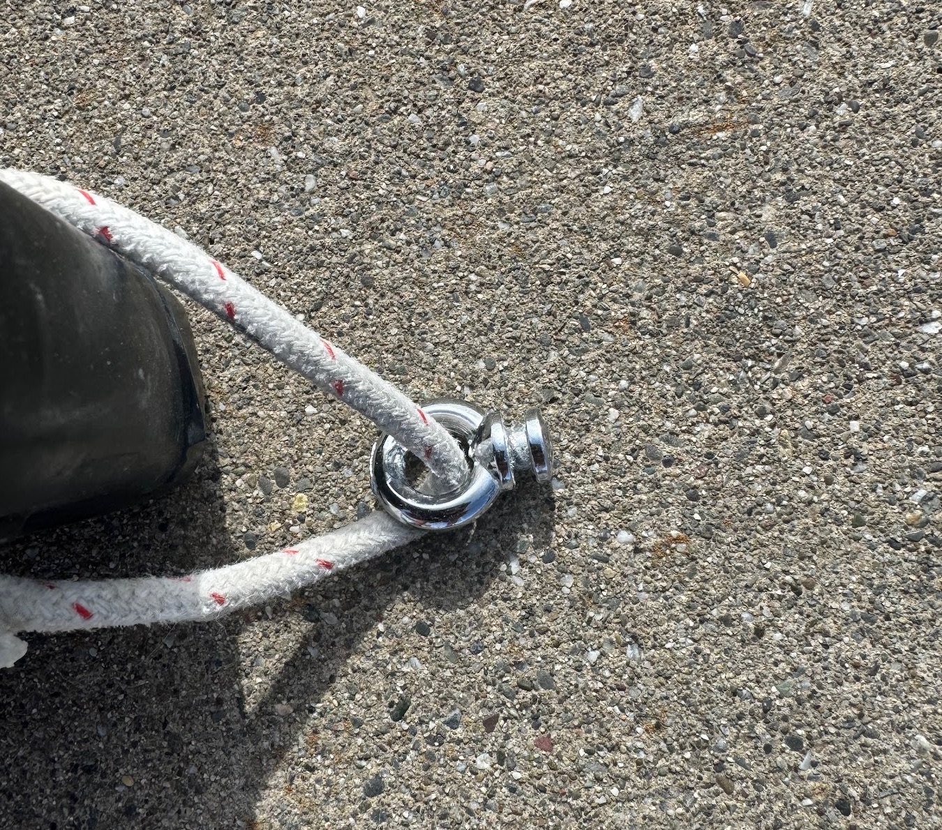

  5. I am looking for a few additional stainless steel fender hooks (photo attached). Does anyone know where these can be purchased?
