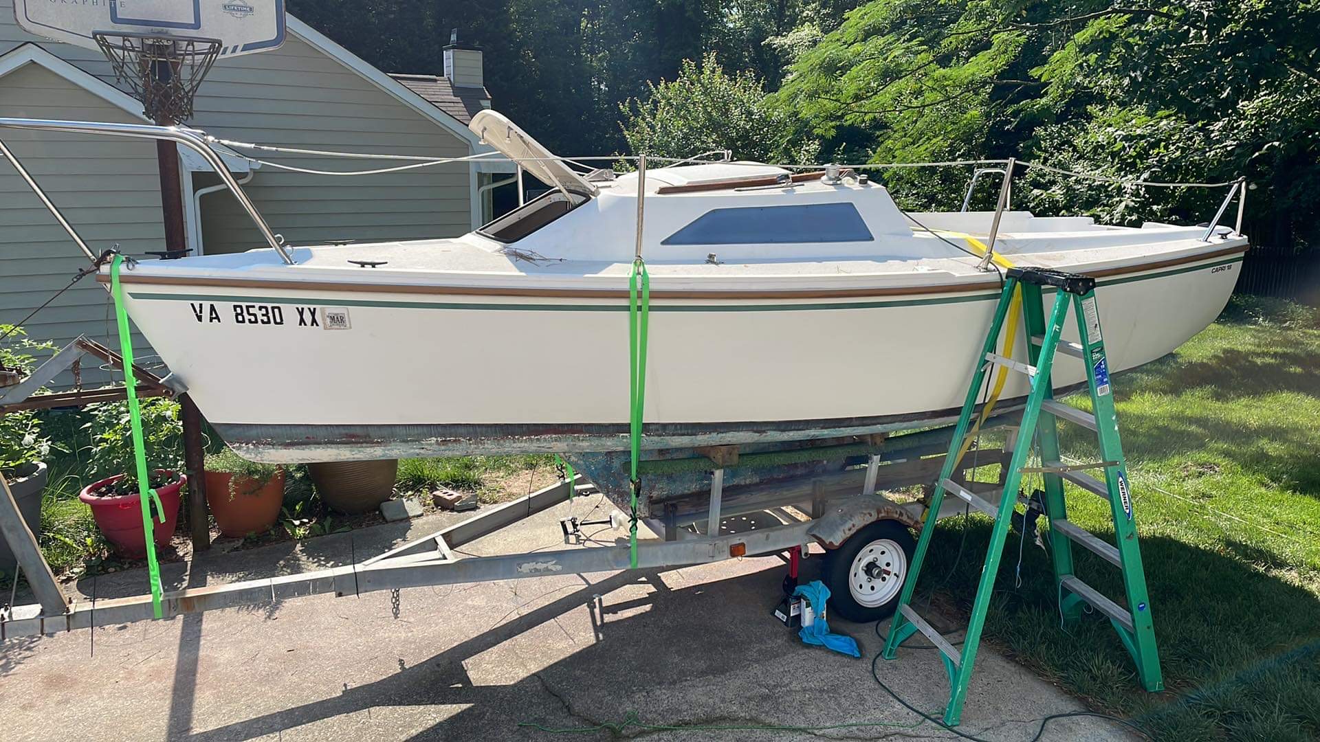

Dropping in to say hello and to dig thru rigging pictures of old Capri 18's...So far the old boat has cleaned up well after dirt dobber and paper wasp nest removal in the cabin...they even got into the sail bags that were stored there too. Other than replacing the halyards/sheets of running rigging I think I've found all the parts...short of one Shroud Clevis pin...Biggest project is replacement of the trailer, I swear it was dropped on this tiny trailer by a crane...with 4x4 wedges driven under the too short bunks to stabilize the boat...no way it was floated on.
Early model with cabin top winch...Would love to know what is going thru the cam cleat.

Starting on the hull...the obligatory dings on the keel will need to be adresed...at one point she was in the water 24-7...and removing the six coats of ablative paint and barrier coat...
Used the low spots with paint left as a guide coat to stop sanding...not all are problem areas...but I found some blisters.
Pretty sure there has never been a sinking due to blisters...It's gonna be a trailer sailor for now...so not sure what to do...could I just plan on giving them extra coats of new barrier paint? I plan on using some tempura to tint white epoxy barrier coat paint tan to keep the green and tan color scheme going....AFTER I find a working marina I can put it on the hard for a week...so that I can get to the areas protected by the bunks.

I used stands on my 25, but you should easily be able jack that little boat up and block it to get under the bunks.
My starwind 19 I simply jacked it up and tipped it side to side against the bunks while sanding. To paint I propped it up on dock foam, painted the middle and bunks, let it down and painted the rest.
