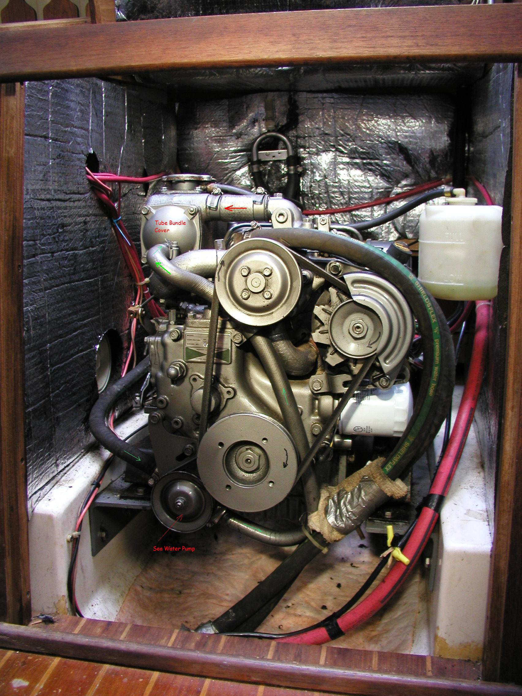

First, Welcome to the forum! ..
make sure the seacock to the water pump is open.. The water pump is immediately left of the lower main pulley when you are looking at the engine.. Attached photo has "water pump" in red letters by the pump. The hose leading off the pump to the left probably goes to a strainer then to a seacock.. follow the hose to that seacock and make sure it is open. (usually handle in line with valve) .. When you turn the key on, there will be no oil pressure so that alarm will sound (if everything is working properly).. Make sure transmission is in neutral and the throttle is bumped up a little off idle.. Next push the start button and it should crank over and start.. The alarm should turn off as the oil pressure builds.
It would be good to get a "gear head" friend to look the engine over and show you where to check the oil and transmission oil .. and coolant (if the engine has a heat exchanger).. The water pump belt tension is important too.. Usually "gear heads" (like me) can be enticed to help by offering cold hoppy beverages AFTER the work is done..
Again, welcome aboard.

Also, it would be good to know the engine model number. Again, in the picture, there is a nameplate about half way between the top pulley and the bottom pulley.. It will have the model # on it such as 2GM or 2GMF or 3GM or 3GMF..

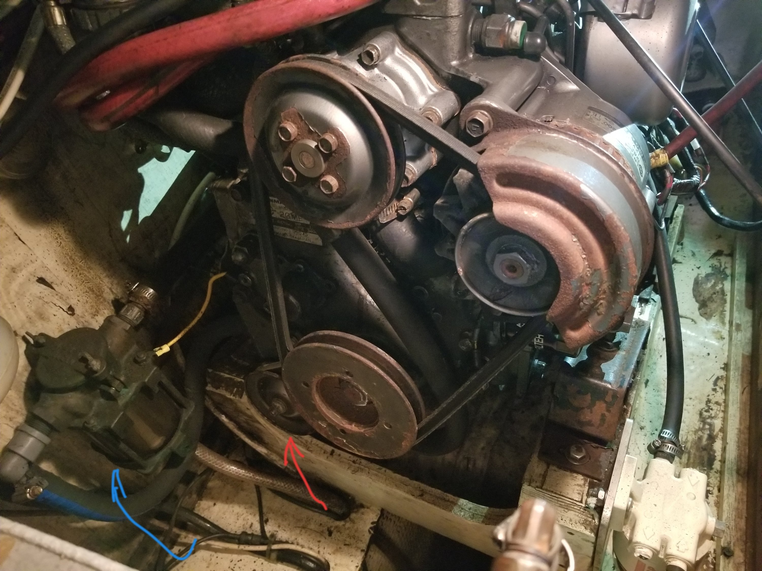

I haven't been back on the boat so I had to use old pictures, but I think I've identified a few things in the photos:
In photo 1:
1. The red arrow points to the sea water pump.
2. The blue arrow points to the Strainer.

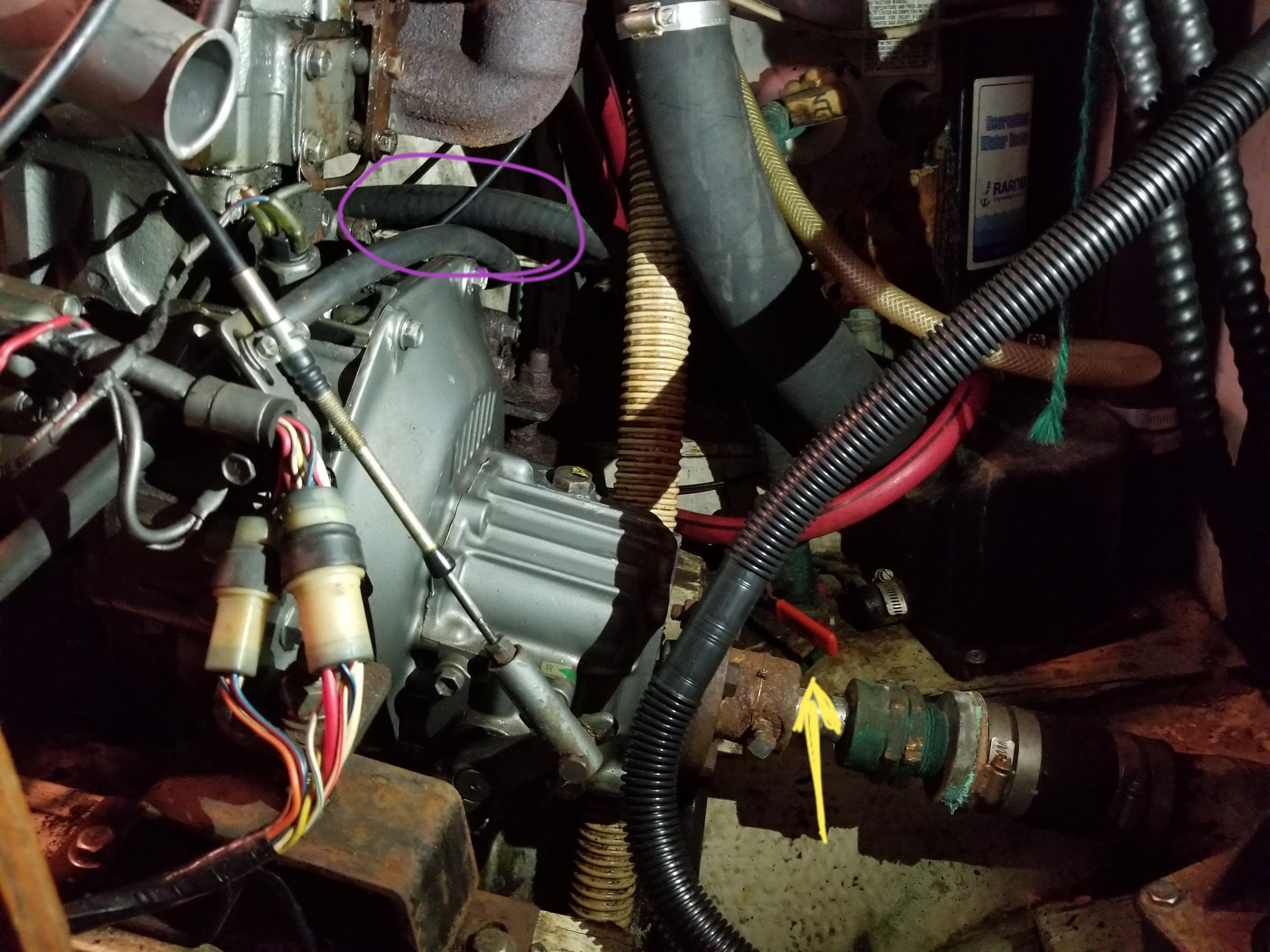

In photo 2:
1. Circled in purple is the line going from the strainer to what I believe to be the seacock.
2. The yellow arrow points to the seacock (I hope). When I took this photo it was in the closed position, but I rotated it to the open position before I went to start the boat.
If all of that looks correct to you all, then I think I got at least that part right.

You are correct in the seacock to water pump line-up.. Looks fine. Red handle in line with valve for open.

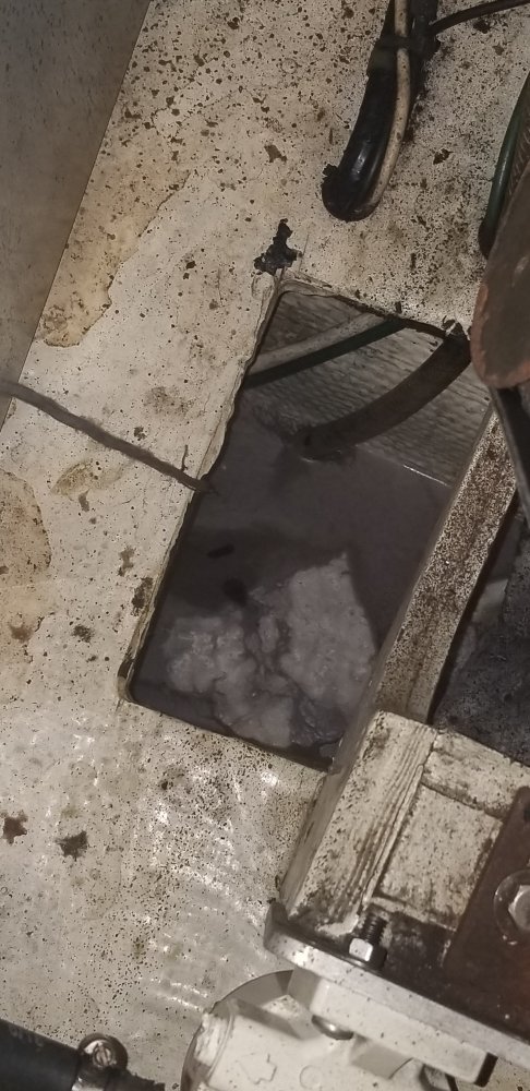

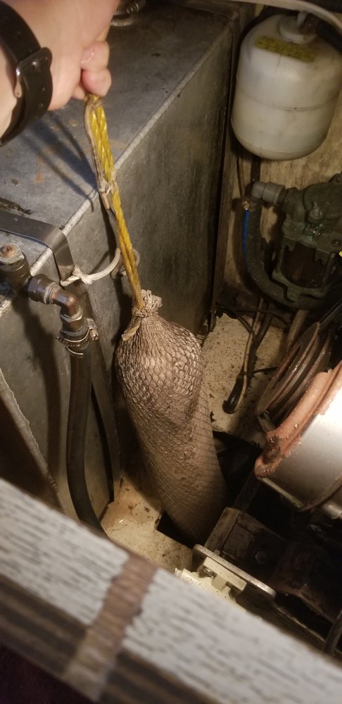

I was looking at the bilge under the engine and found what I can only describe as a waterlogged buoy. More mysteriously, it was tied to a string which is tied to the side of my fuel tank. Does anyone know what this is and what purpose it serves? Also, is it normal to have that much water in the bilge?
24,589
Yes. It is an oil log. It collects oil from your bilge. It it looks saturated in oil or smells like gasoline then it should be removed. You should ventilate the boat before creating any spark.
From the picture it does not look black with oil/diesel. So you may be able to drop it back down and let it keep doing it’s job of protecting the planet.
The bilge should be as dry as practical. Check that the pump is sitting in an area to remove the most water. I would dry the bilge completely and find where the water is coming from. Possibilities are shaft seal, thru hull hoses, engine raw water pump, rain water from a deck fitting, etc. If water comes back check to see if it's fresh are salt water. How often and how much water comes out when the bilge pump comes on?

I figured it out. The bathtub drains into the sump. We recently concluded a 5 day trip where we made good use of the bathtub, so that explains all of the water in there. I thought there was a float trigger down there, but I guess not. I'll have to get in there and take a closer look.
