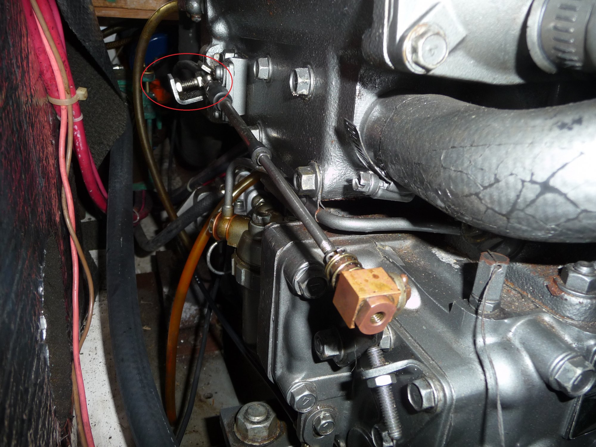

There should be a cable clamp on the throttle cable that can be tightened just a little. If not, get one and install.
10,108
on my '85 model, the clamp is close to the end at the engine. (in the red circle) Many had a nylon tipped screw under the compass that could be tightened against the throttle lever axle, a better way than the clamp because the cable loads are lower.. Congrats on the boat!

Scroll down to page 50 in the file and you see part #19 in the lower view.. That is the friction adder screw.. When I bought an aluminum replacement for the cracked plastic one, the screw hole was not threaded..so I don't have that screw.
Hunter_gen_18329874.pdf (sailboatowners.com)

I moved my clamp up to where the cable enters the bottom of the pedestal. Works much better as there is less cable to bend before the clamp

I had the same issue with a creeping throttle when I purchased a Hunter 30G last year. If you take off the compass, you can reach into the binnacle and there is a friction screw on the inside of the throttle lever. A few turns and the issue will be solved.

Throttle control - As mentioned previously, throttle vibrates off. I removed the compass and the tension adjustment screw is missing. There wasn't any other cable tension device that I could find. Are the screws under the compass available anywhere?
RESPONSE
I think there is a tension control for the throttle at the other end of the cable on the engine
