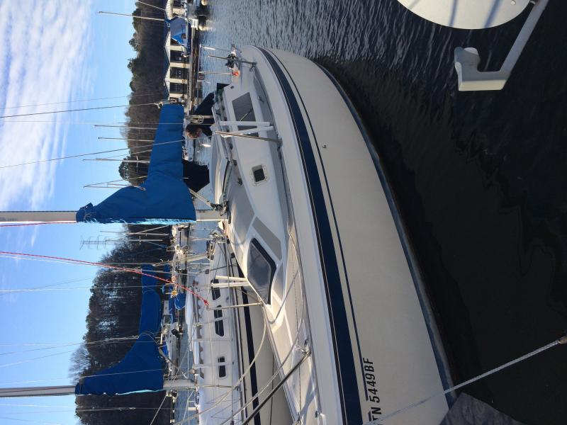

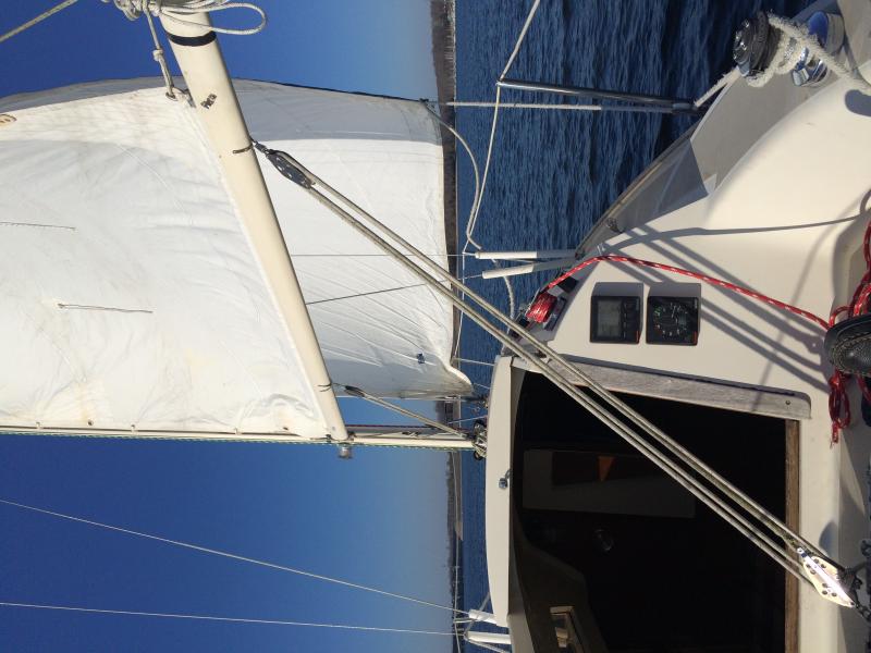

I've read through many topics on this Forum for insight prior to purchasing my new to me 84' O'day 26 for an inland lake/river cruiser. Although it is the dead of winter here in Middle Tennessee the temperature creeped up to 50 degrees on Saturday and I was able to take my first sail on her. :dance:
I just thought I would drop in and share with others.

Congratulations, looks to be in great shape. Happy New Year!
The boat actually was in great shape, especially with a completely original interior. I got it at a great price with a new outboard still under warranty. I have a tiny bit of wood rot on the port side bulkhead from water leaking in around chain plate but I don't think it has progressed enough to warrant replacing the entire bulkhead just yet. I've hopefully caught it in time and can re-bed everything to fix leak.
EDIT: Please ignore the extremely ugly genoa sheets. Those are on order from West Marine.
