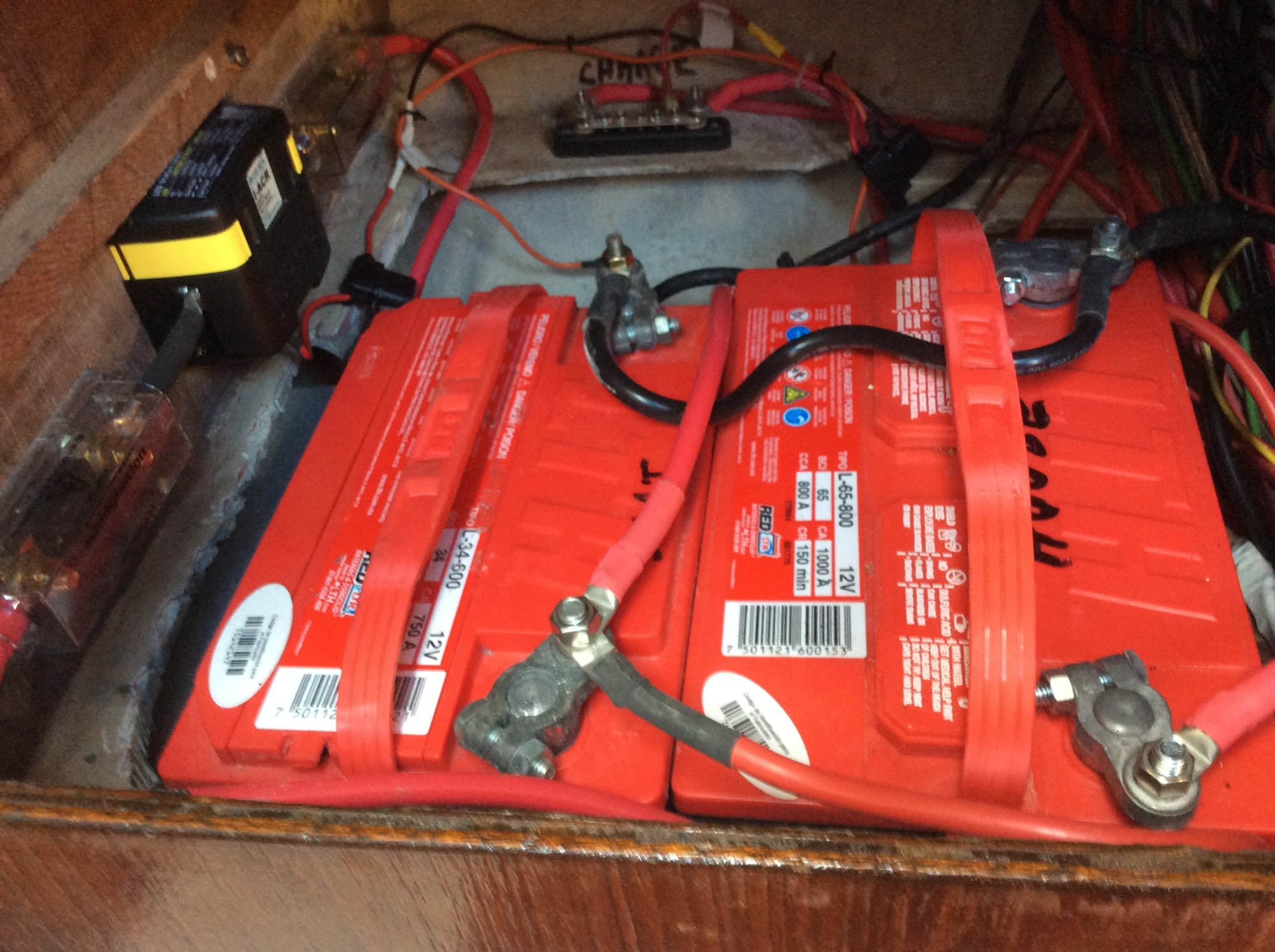

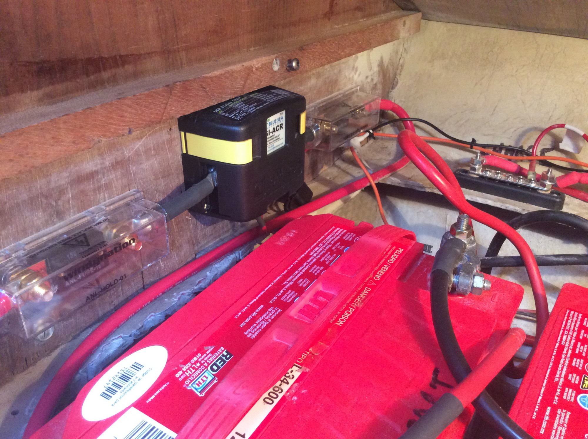

I have a 1979 Catalina. Had issues. Then added a Blue Sea 7650 Add a Battery kit. That’ll fix all your start issues. Alternator is fine I believe. I’d get a set of 2 new batteries. We did the same. Totally changed the way we start and shut down. No issues at all. When adding the Blue Sea kit it will isolate the house batteries from the start. You can then run your house down and always have full power for start.
Also change all your lighting to LED. The old original boat lighting will drain your batteries fast when sailing. Our boats are probably very similar in mechanics etc. Anything i can help you on let me know.
